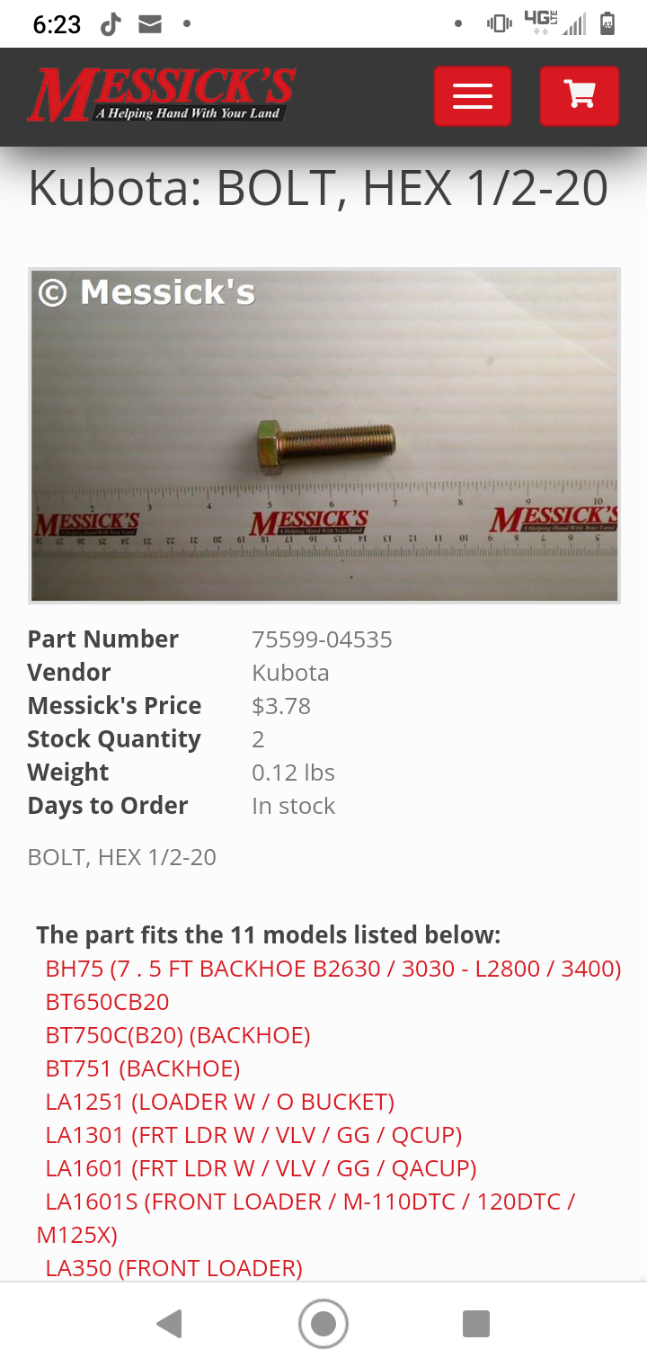

I have yet to see a SAE hole in a Kubota casting anywhere.
This is a genuine SAE Kubota bolt. Don't know where it fits though.
   / Bolt Size Help #116
Certainly not a casting since it's fine thread;)
   / Bolt Size Help #117
Looks like it fits various loaders and backhoes.
Which makes sense since those are built in the states.
Also why I said I have never seen a standard bolt on a Kubota "casting". Because those are made in a metric country
