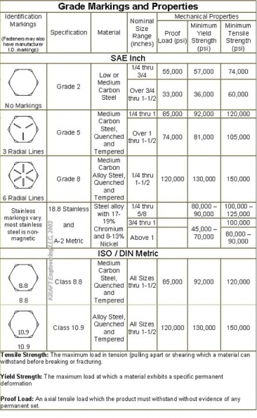

It is probably a shortened version of the 10.9 metric designator. I agree, forget the dealers, probably pay 2 prices for one. Also ditto the thread pitch, it may be different than a standard off the shelf; but, you can be sure the tractor assembler is not using something that is uncommon in the bolt world. You should have a good supplier like Fastenal around. Take it with you and match up. Those places are very helpful and sell by the each. I have never bought bolts from and OEM assembled product. You can make some subtle improvements that way, such as head type, grade, and driver style. I always use grade 8 for items with dynamic loads no matter what the original was.

Its just a high tensile metric bolt, all the ten is there for is so you don't put any 2 cent metric bolt in there that will thread in. You see 8s all over motorcycles, where they count. Same thing you know to replace with a decent one not one made of playdoh

Fastenal will have any bolt (or can get it if not in stock) but I find my local Fastenal to be good quality but super high priced. They can measure and tell you the exact size and thread pitch needed though. I don't know that the bolts in most farm supply houses are high quality, most likely cheapest that they can find. I wouldn't use them for critical component fastening, get a quality bolt from a reputable manufacturer that can get you the mill certs (heat number from the ingot used, tensile tests on the as produced bolt, alloy components, etc) on the bolt if needed.

One of the more useful things I have is a complete metric tap and die set. Then, given any nut or bolt, I can determine the thread pitch, diameter, etc right on the spot. Then I can walk into a store knowing the bolt I want and not have to spend time jerking around and trying to measure threads and pitch.
