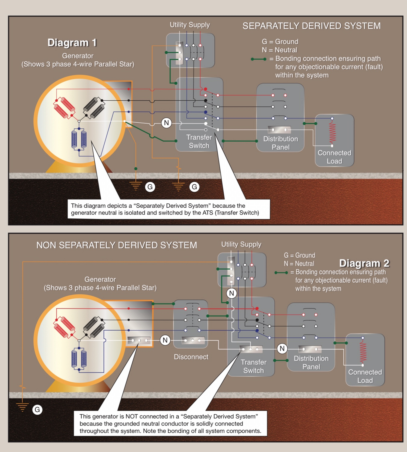

Switching the neutral or not switching the neutral is just one of two ways that you are allowed to complete and generator installation, it a design choice.
Both ways are code compliant.
A transfer switch is less costly if you don't add the extra pole to switch the neutral.
So when would you want a switched neutral?
On an Industrial Electrical Service with ground fault detection/protection devices. The design requires the generator to be a separately derived system. Switching the neutral off of the utility service and onto the generator makes it a separately derived system.
At Healthcare Facilities with required Life safety systems and required emergency power systems.
The basic reason is if there is a phase to neutral short coming into the service from the utility you prevent possible damage to electrical systems by switching the neutral.
Phase to neutral shorts have happened during severe weather that damages the utilities distribution system.
I have seen the damage of a 6000 amp service blown off it's foundation because of a phase to neutral fault. so switching the neutral is a design consideration engineers usually make on large electrical services.

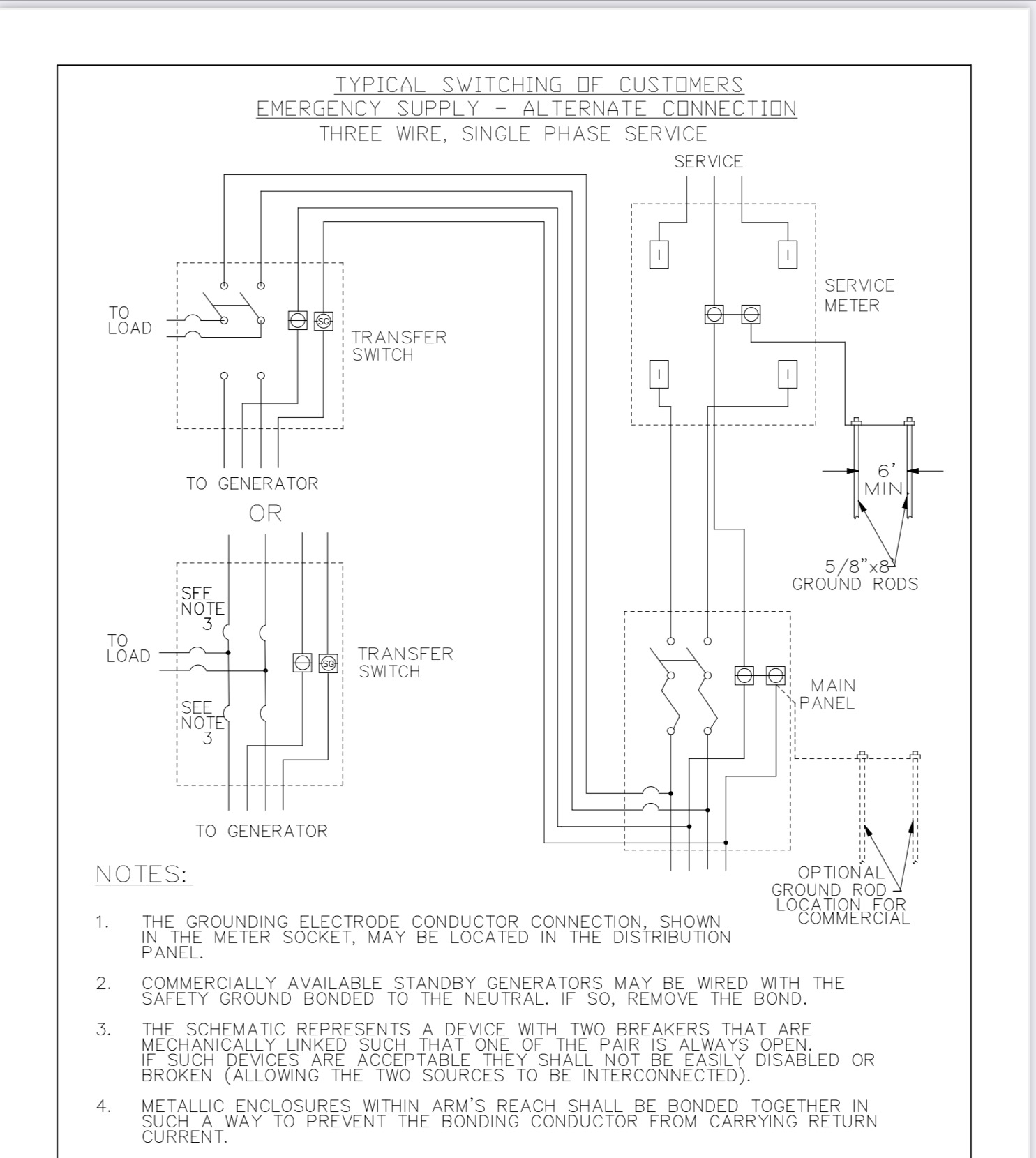

Here is a drawing of how to connect a generator. Note the neutral is not bonded to the ground wire at the generator. The ground is bonded to the neutral at the meter socket(the preferred method) or a the main electrical panel.
I’ve never seen a transfer switch drawn like that.
That diagram is for when only 1 load (perhaps a sub-panel?) is transferred onto the generator system during an utility outage; and the loads on the main panel are not. That is, the main panel is not transferred to the generator system in this setup.
Other installations might switch the whole panel, like this diagram I found on the internet.
