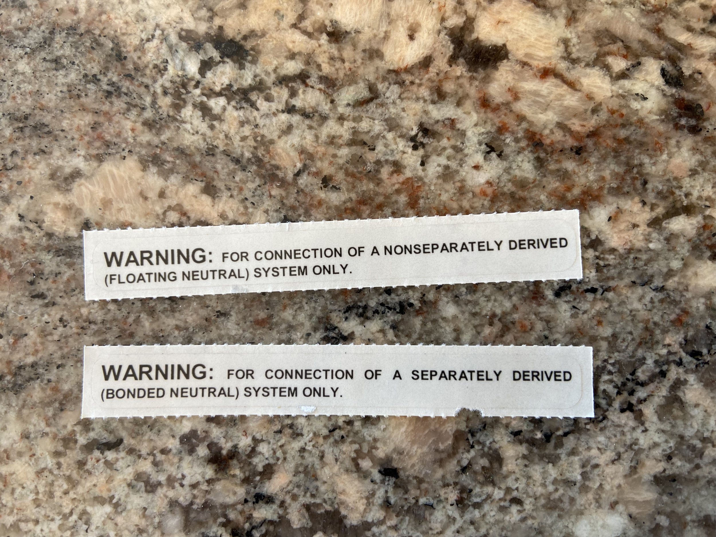

@stumblinhorse I can't see companies offering a switch, as they would likely be on the hook for users a) not having in the right setting, and b) accidentally switching it.
Shipping with it bonded puts the state of the bonding firmly in the buyers court.

My stuff came with these…. Hopefully a switch is in the future…
