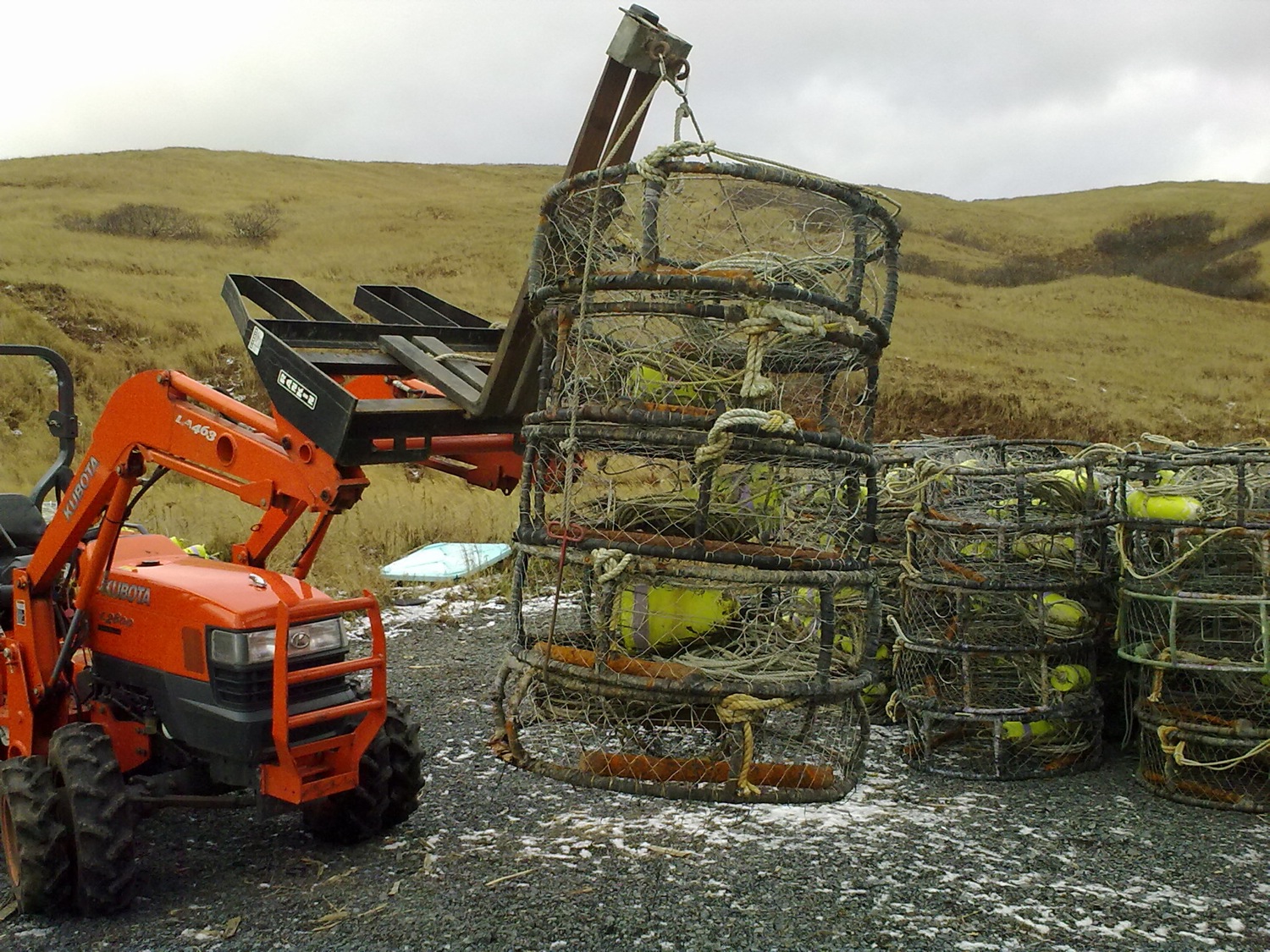

How much do the pots weigh? I think you can do it. I would drill holes in the backhoe bucket and bolt it on.
/ boom/extension for backhoe bucket
#22
They are about 500 lbs for a stack of 5 which is really convent to move in and out of the boat as well as stack there. I was playing around with some wood scraps today trying to figure out some hook system for the bucket but nothing seemed too secure so I think your right Bruce I will be better off bolting them.

thanks Joel, my forks are rated at 3000 so I spread them and tried one lift, it lifted them fine but because it has to be so high that much weight, that high up made me uncomfortable even with the backhoe on plus it was a hassle hooking/unhooking 2 stacks next to each other like that. As everything here is on a slope and the close proximity of salt water and working with a incoming tide, I decided to wimp out on the double stack up front.
Thanks for the suggestion.

What if you changed your plan a little. Use the FEL to unload the pots and put them on a rack or pallet designed to carry 2 or 4 stacks and pick that up with the forks .you would be keeping every thing close to the ground and would be a lot safer.

My trip is 50-150 yards depending on the tide so not sure if the time lost loading/ unloading the pallet and then changing the forks to take the pallet and then the hooks would save me anything. I did use a pallet for the first couple of loads when I first got the tractor but besides having to double handle the pots the uneven ground wanted to tip the stack off the pallet unless u moved really slow or tied it down.

Call me crazy (and join the masses), but I don't understand why you are lifting those pots in the first place. Why don't you build something like a stone boat and just lay the stack of pots on the boat and skid them up the beach? Your forks out front are the obvious choice for one stack, but if you had a hook welded to the back of your backhoe bucket, you could just drop in a tow chain and go. I'm afraid you'll end up looking like a fish out of water and wagging your tractor back and forth with oddly swinging pot stacks.:eek:
Also, when you get your pots unloaded, use the forks to carry the skid back down to the pots for the next round.

A local contractor has a bracket that he chains to his hoe bucket using a normal "bear-trap" chain tightener. I have a 2" receiver welded to mine. His is on a full sized Case industrial, mine is on a 35 hp CUT. While he can pick up and run with a full length hydro pole, I am reduced to a VERY slow crawl just lifting two bundles of shingles up to a single story roof. The thought of a SWINGING load really makes me nervous.
I'd go with a skid that will hold two piles of pots on my front forks, but use the hoe with an extension to set them onto the skid. That way you can do your long reach lifting with the landing gear down, (maybe even load two skids from the same spot, one on each side) then run them up the hill on the forks and slide them off at your storage area.

I developed an allergy to what I call "real"boats quite a few years ago, now I just fish in open skiffs from a cabin on the beach. The one I use for crabbin is 30' and just an open skiff, I just put it sideways to the shoreline to load/unload it reaching in with the loader. If I don't do it at the top half of the tide then I have to travel 1/2 a mile one way so I need to do it relatively quickly. A full load is 75 pots and I only do that many on a nice weather day. I just reach over the rail with my forks and put off/on a stack that's y if I could just reach in with the bh(not long enough by itself) for another stack it would speed things up considerably but with a rapidly incoming tide loading/unloading stoneboats/trailers would take up a bit of time. About half of the time I am fishing alone and have to get off/on the tractor to put the hooks in each load.
I was mostly just worried that a 5' extension attached to the bucket with 500 lbs would stress the bh. With it on the bucket for transportation I would be able to lower the dipper with the bucket boom raised keeping the pots lower and not swinging as they would be resting against the bucket boom just like they do against the forks.

Seriously though any thoughts on if a 5' extension with 500 lbs would hurt the backhoe??
