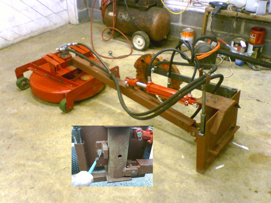

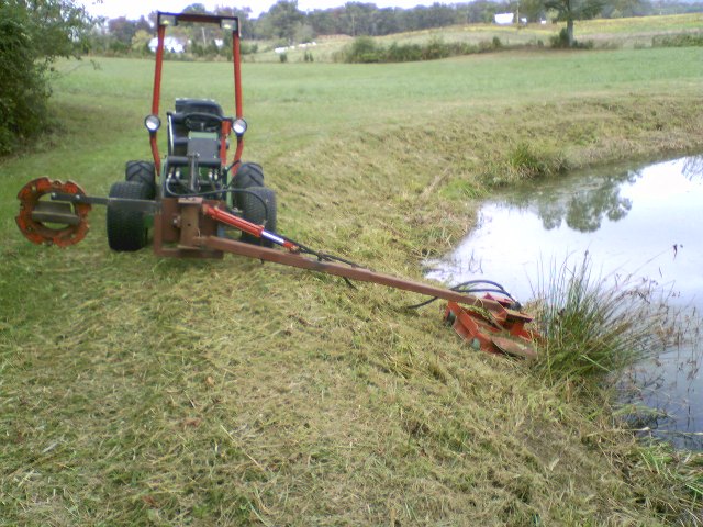

I can appreciate the questions that this boom mower brings up. I have a boom mower on a Ford 7710 with duals that will reach anywhere around the rear(180 degree circle)within 25'. If I stretch it out, I can pick up the front end and it has more than 1200 pounds of weight up there.
Has anyone considered adapting dual wheels to the PT to make them more stable when boom mower is in use, or are the axles too light for that? A Steiner boom mower uses weights to offset the boom, but duals tend to help. My tractor has a Lexan shield to prevent flying debris, but only on one side, as most cutting is done there. Chains to help with the flying debris would add unwanted weight to the mowing deck, but maybe rubber tire strips could be added without too much additional weight.
It appears that PT mounted the offset weight bar to the front lift. This raises the weight when the boom mower is raised. Is there an advantage to this? Seems like added weight up high just makes it more subject to bad handling characteristics.
Why are the wheels so hard to reverse on the PT? I don't remember what they look like, but seems removing and replacing lugnuts shouldn't take long. Probably more to it than that.
I would consider making a change to the straight arm, by either making it telescope or add a knuckle as in their more expensive mower. It will allow for a much more versatile mower, as you can't always control just how far you need to be away from what your mowing. My boom mower is knuckled like a backhoe, plus has the extendable feature like an "extendahoe". Works great, adding a lot of versatility to the mower.
Since the PT has a lot of hydraulic capacity, why not add an idler wheel with a hydraulic cylinder pushing down on an extra tire, on the side where the arm is overhanging? Seems a little downward pressure would help, especially if the idler arm extended a foot or so past the existing drive tire. It wouldn't take much design work, and could be made to remove when not needed. Maybe mounted somewhere on the frame near the front tire.

I'm not sure what you are looking at David, but there is no "weight bar" on the PT-425 boom mower. Duals would place an unacceptable load on the wheel motor axles. Reversing the rims alone does that, in my opinion. The mower can be positioned where the operator wants it by raising the lift arms and lowering the boom. The combination functions somewhat like the knuckle on the knuckle boom mowers.

I understand what the duals would do, just not familar enough with a PT to know how they are built, and if strong enough to withstand the added stress. I leave that to you, and if you say they won't stand the stress, then I understand. I got the idea that the boom mower has a weight bar, from ksimolo 's posted link to the picture of the one he says is on PT's website. I knew yours was different, just didn't notice it didn't have the weight bar also.
If the drive motors won't stand the added weight, the only thing I can offer is to fill the tires. That load isn't carried by the axle/motor, so probably wouldn't hurt.
