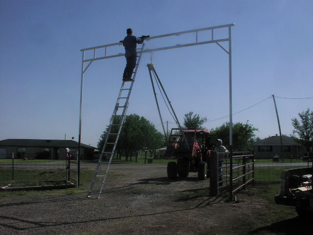

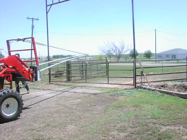

This is the set up I used to set some gates and to set the arch way for my entrance way. The gin poles are about 10 or 12' long. This worked very well.

Did the arch way seem heavy when you were going up with it? Your branson is a little bigger then mine. It could have 2.5" cyl. mine are 2". The arch way does look like the pipe is good size. Thanks for the pictures.

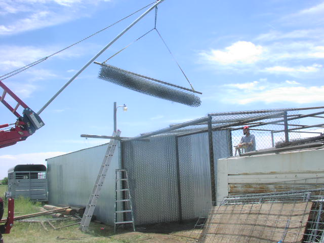

I believe this was 12ft and in pic the panel is 15ft. I did pick up some heavier/longer/thicker panels, but doubt they weighed 300-400 pounds. I had a 2000lb, 12 vdc winch on it also. I have moved 750 pounds with the un extended boom pole. There is an old thread about these circa 2006?

It was heavy. The vertical pipes are 3" with 1/4" walls. The horizontal pipe are 2" and 1/4" wall.

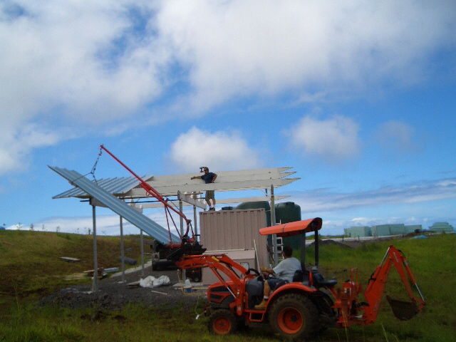

No loaded tires here, but the backhoe is a big help. Still easy to get tippy. Now if I had level ground...

No pics, but it is possible to raise my boom pole, then use the winch to lift. Usually minimal tractor movement if doing so.
