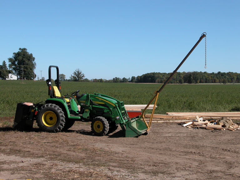

Thought I would post a pic of my boom pole used for setting trusses when building pole barns. Works like a charm and was cheap to make.
/ Boom Pole
#14
That one looks like a modifled TSC (or KingKutter) brand with an extended boom. One I was going to copy but didn't have a pipe bender. Wonder if it'll pick up a 525# FM...without a box on the back. :)
