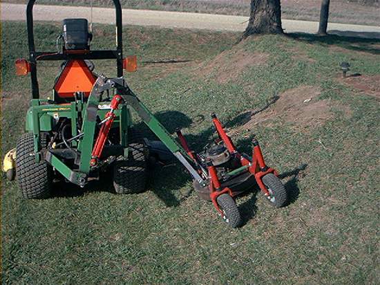

I just finished testing out the boom mower that I have been working on this winter. Except for the carb float developing a hole, it worked great.

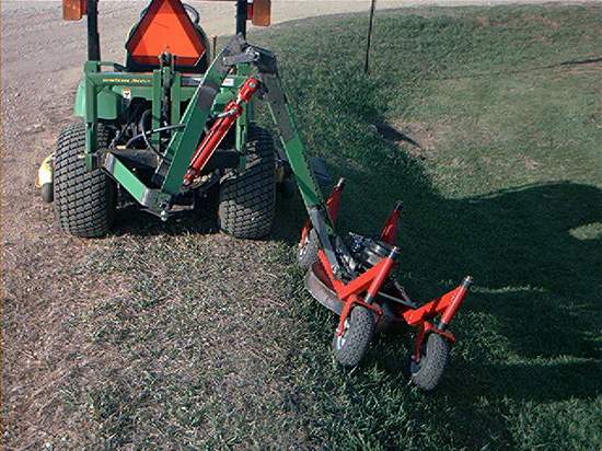

It is powered by a 4 HP Tecumseh 2 cycle engine

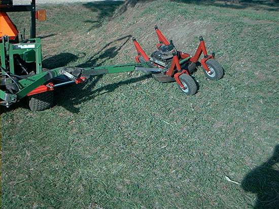

From the top close to the tractor

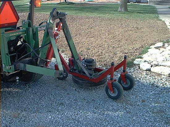

Reaching down the bank

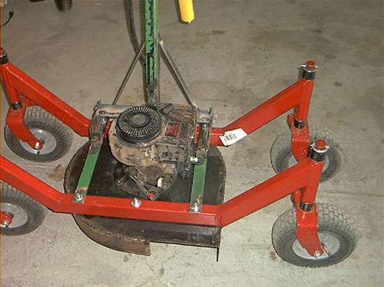

From the bottom of the bank reaching up

Kind of like a 21" weed wacker with a seat. /forums/images/graemlins/smile.gif I will probably use it as is this summer and when all the bugs are worked out I will sandblast it and paint it.

Doxhound, unfortunately, there are no plans or drawings, just many hours of doodling and dreaming. I will answer any questions I can.
There is only one valve and the three point. I used the bucket tilt valve, push right to extend, pull left to retract.
It is not tippy at all. The boom pivots on the hitch and is supported by the gauge wheels on the mower. I can't hold the boom off the ground, it will only extend and retract.
It works perfect on our 1/2 mile of steep roadside. /forums/images/graemlins/smile.gif

Would like to see more close up detail of the mechanical workings so that I could copy it. Do the wheels castor?
The pictures all show the wheels straight.

The wheels do caster. I will try and take some close up pictures in the near future. Thanks for all the comments guys.

I have roughly $465.00 invested in actual parts. The gauge/caster wheels were $199.00, cylinder $50.00, hoses $25.00, motor (used) $75.00, carburetor $65.00, scrap iron $50.00. The arms are the reel lift arms off a junked 922 grain platform (free). The blade and blade holder came with the motor. Hope this clears it up a little. /forums/images/graemlins/smile.gif
