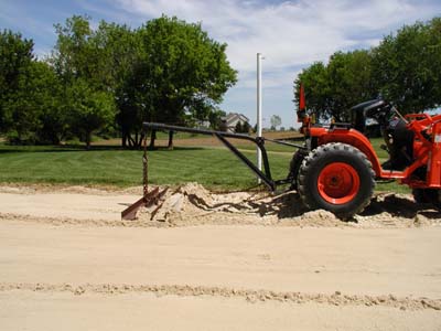

As you said, I'd rather use the FEL for most lifting. It is easier to control, and it's out in front where you can keep an eye on it. Just watch out that swinging loads don't swing into the radiator.
I built a BP before I got the FEL-equipped Kubota. Every once in a while it came in handy. As others have pointed out, there's a real limitation of BP lift capacity on the smaller tractors (ie: it's easy to pick up the front of the tractor).
Since getting the Kubota, the BP has only seen use as part of a drag I made. Here's a shot of smoothing out the sand volleyball court.........................chim
