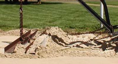

How about a chain from the drawbar to the "drag". Then you could "safely" pull the drag without fear of flipping the tractor, and still have the ability to lift it clear with the boom pole.
   / boompole #32
Re: boom pole
Rdam, here's a closer look. The chain from the boom pole is just for picking it up..................chim

It's a real backsaver. I made the drag for our stone driveway back in '90 or '91 when the only tractor I had was an old Cub LoBoy (no FEL, no 3PH). Back then the only way to turn the thing around at the ends of travel was to unhook the two drag chains, drive the tractor to the other side of the drag, and flip the drag over.
My first welding project after getting the Ford 1210 (3PH, but still no FEL) was the boom pole. Life was good. I used it to pull a number of wooden fenceposts with a simple chain wrap around the posts. Some popped out easily and others were pretty stubborn. Had the front wheels off terra firma on the stubborn ones.......................chim
