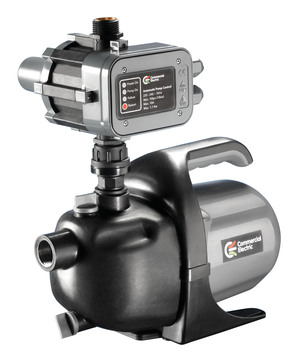

I recently bought this 'Constant pressure' pump for my bore. ($139 at Bunnings). Its just used to water the garden at the shack. It will be replacing an old pump that had a large pressure tank. I understand how the old pump worked: when the air pressure in the tank dropped, it triggered the cut-in switch. But how do these pumps with no pressure tank work? I understand that if it detects a flow rate of 2 litres a minute then it kicks in. But how can there even be a flow to detect if the theres no pressure tank? Just wondering.
A flapper valve switch mounted in the output line. With no water flow, the flapper is straight and when it senses water flow, by bending, it activates the pump.
In order to have a pressure switch, the pump has to have a compressible vessel of some kind, be it a bladder or pipe with air trapped inside, a spring loaded cylinder, much like an accumulator, and there may be others.
/ Bore Water Pump query. #4
How might the initial fluid flow be initiated?:confused:

Pumps like this have a built in pressure tank. Also there is a pressure sensor (transducer) located somwhere in the line. This senor read pressure and tells the pump when to turn on, speed up, or slow down. This pump is similar to the Grundfos MQ style booster pump.

Heres my situation. The pump I bought (shown in the first post) says it will suck from 8 metres down, and pump up to 40 metres. The water table is only about 2 meters down, and I'll be mainly using it to feed 4 garden taps at ground level. But I also want to connect it to a tap thats on our first floor deck thats about 4 meters above ground level. My question is, will the controller be confused by this? The old pump (with a large pressure tank) that I'm replacing never seemed to come to grips with this problem. If I adjusted it to turn on and off at ground level, it then wouldn't power the deck tap. (That could have been my fault of course, and the pump was stuffed anyway). And my other question is.. .Is there any benefit in plumbing the old pressure tank from the old pump into the new system?

Id suggest that if this pump is to be used for watering a lawn etc. it be running constantly. This will be best for power consumption and electrical component life. The operation can be set up to operate on the line pressure.:D And yup, it don't need a pressure tank to work!:p
Nope, when the pressure falls the pump starts and viola; Flowing water at the spigot :D
The on demand pump in my camper has no pressure tank but will start up when I open a spigot and deliver water.:D
For years I watered an acreage lawn using a centrifugal pump with no pressure tank. Worked well! When I closed the spigots the pump shut off. On opening the spigots the pump started.:D

Now on to the constant pressure pump. They have a transmitter in the system some were and slow the pump down to keep the same pressure all the time. The transmitter will some logic in it or the pump as to when the pump shuts off when water isn't flowing.
Most standard well pumps can pump faster than the faucet discharge and the well tank (captive or old style galvanized) cushioned then to keep pump from starting and stopping on every faucet opening.
I remember many times hearing people complain the pump will run when the toilet was flushed or faucet was turned on usually the tank was water logged.
