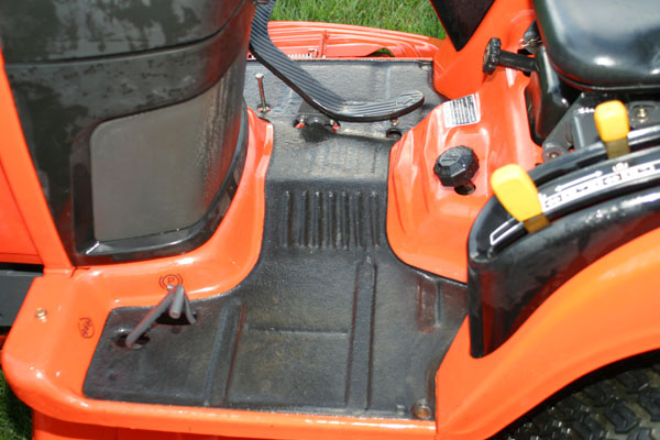

I had the guys at Rhino Liner here in WNC to spry mine. I simply removed the platform, washed it off and delivered the platform and original mat to them. They masked off the area the mat covered and taped the holes on the bottom side with metal tape.
Looks great, is NOT slippery at all, and best of all (the reason I had it sprayed) dirt doesn't get UNDER it. I originally thought I would re-install the mat over the rhino to keep the original look, but I like the look of the Rhino.
I'll post pictures when I get home.
   / Bota floor mat #9
OK, so here it is.

Looks excellent! Sure fits in all the crevices nicely. thanks for the pic

Spray job was about $80. The removal was quite easy. Just a few bolts. The go pedal did have to be removed, but was only two bolts also.
The hardest part was reinstalling it eafter it was sprayed. I had the hole for the brake pedal sprayed over so that I could cut out only as much as needed. After fighting with the hole saw for a few minutes, I decided to just cut a long slit in the general area and slide the pedal thru. There is an open space between the brake and go pedal that has no metal.

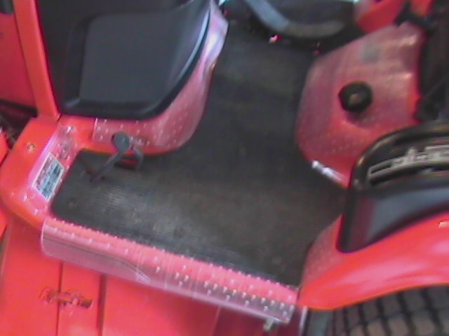

Thanks for the pics and other thoughts. In the end I chose to go inexpensive. Roll of rubber mat traced out by the original mat and adapted to cover the unprotected areas. Then I put the original over the new cutout and secured with replacement clips. I think it turned out perfect for what I wanted. Seams like it will hold up too. For a couple bucks I purchased extra plastic clips so that the mats can be removed occasionally. Here is the pic
