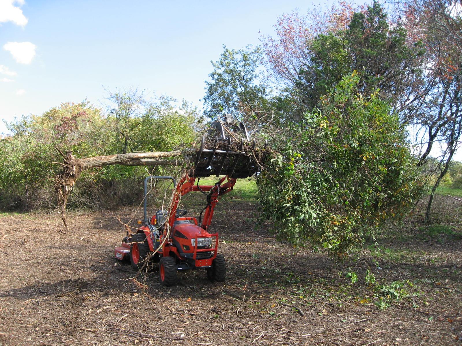

I can pull an intact 4-5 inch tree out of the ground with my Kioti CK20 and Millonzi grapple so I am sure you can get even bigger game. My technique for the ones I cannot just directly "lift" out of the ground is to start to push the tree over then use the grapple teeth to soften up the roots around the base then push it over a bit more so I can get under the roots at the base. Then just curl or push ahead to finish popping it out. Works well for me with a 2000lb tractor and the equivalent of a 352/402 loader so you should certainly be able to get even bigger trees.
