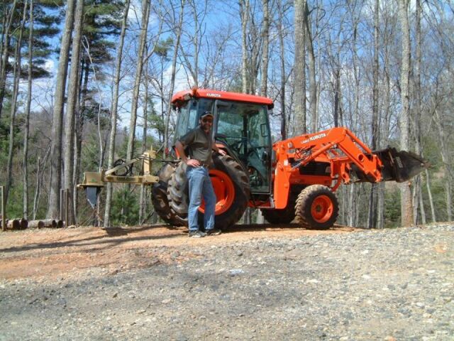

thanks, Beenthere. I may need to paste your post on the dash of tractor!
I only have postion control on tractor, not draft. I should have just waited and got a one bottom instead of two bottom I guess, but was anxious. Really all i wanted to do was break up new ground for a pumpkin patch and also plow for a medium size vegetable garden to get it ready for roto-tiller yet to be purchased.
only plowing I had done before was with Jack and Jill (two mules) many years ago.
my tractor is Kubota 4610 by the way. here's photo

Well, guys, it was a little more involved than just 'reversing the pto brackets"! I had every manual and parts description for bottom plows i could find online printed out and lying on ground beside me. I went to 2 neighbors farms who had bottom plows and couldn't find anything quite like this one i've got.
The brackets were totally different and the arm running from toplink bracket back to rear of plow was slightly bent in middle.....i am guessing it was to make the arm flush against the plow to be bolted on. But when i turned it one way, it wouldn't fit flush against the toplink bracket, turned the other way, wasn't flush against the rear of plow.
The flanges that the U-bolts at the front of bracket held down were strange too. one side was straight up and down, the other was at a slight angle.
Was really frustrating, mainly because I kept thinking I shouldn't be the one to have to do this.
But.as someone stated.....maybe TSC is just a do it yourself firm now and maybe I would have paid more for a plow from a full service dealer. But whatever the case, I've never been one to complain or make a scene....never even sent food back or complained in a restaurant before.......but I must be getting old and stubborn. Just seems I see a lot lately where customer service is a thing of the past......pay huge sums of money for a product and get very little helpful service. Seems that's a trend. I'm not sure if TSC is just a do it yourself firm now....or if they just can't good help and could care less.
anyway, I stopped my bitching and whining long enough to try the plow out. And it works great...sliced that packed red clay soil open like it was hot butter! I ca'nt believe how my bota 4610 HST pulled that sucker through either. I would have to feather the throttle some and it would act like stalling once in awhile but that was because the operator couldn't figure out the proper settings
I had the rear plow doing just fine but the front plow wasn't digging down as much....nothing i could do with adjustments seem to fix that........but when dropping down in a rut like someone described on here......it was great!...cut down about 14 inches.......kind of felt a little spooky on the minor slopes when i dropped down too..........my angle inclinometer showed 20 degrees a time or two....made my knees weak.
