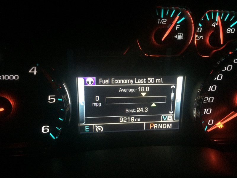

Wow has it already been that long?? Doesn't feel like it. I'm still loving the truck, the honeymoon phase hasn't worn off yet. I only have 9,000 miles on it right now(yeah I know, but this thing really is used for farm work and short trips between my two farms so doesn't have many miles put on it). I have had about 3 recalls so far and have to take it in for two more, waiting on my 10,000 mile service to do everything at once. I honestly haven't had a single issue except for the loose front seat that is pretty common I hear. Never had to take it back for any issue that couldn't wait. I'm not experiencing any of the other issues I've read about, just the loose seat and it's not really that loose but you do sorta notice it.
Truck gets awesome gas mileage and also tows like a dream. Best mpg I've gotten was 24 and I usually average about 20/21. Heaviest I've towed is only 4500# though so far. I still plan on putting on a leveling kit and 275/70/18 tires sometime because the stock tires make the truck vibrate.

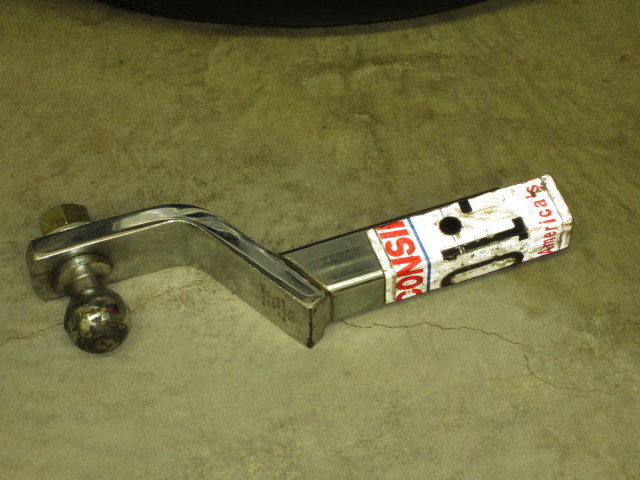

Oh and also if you are considering one of these trucks be aware of the headlight issue GMC owners are having. They have terrible lighting apparently, thankfully mine isn't affected since its a Silverado and an LT model. Also don't waste your time driving a truck with 3.08 gears, you won't save hardly any fuel and performance suffers greatly. If you leave your trailer hitch in all the time it will rattle and you'll swear it's the truck, it's not, it's the hitch. I've never had a truck do that before and it can be annoying as all heck.
The newer Ford and GM trucks have a looser receiver than the older trucks. I made a shim from a flattened licence plate because it is the perfect thickness and easy to work with. You must really flatten it, and make a angle piece that is only on 2 sides of the insert. Drill a hole for the pin and your done.

Not to stir the pot but just take the hitch out?

I rarely take it out because the moment I do I'll need it. It doesn't constantly rattle but you can hear it shifting sometimes if you turn or something.

I take the hitch insert out when not in use. The shim is to keep it from clucking when towing.
