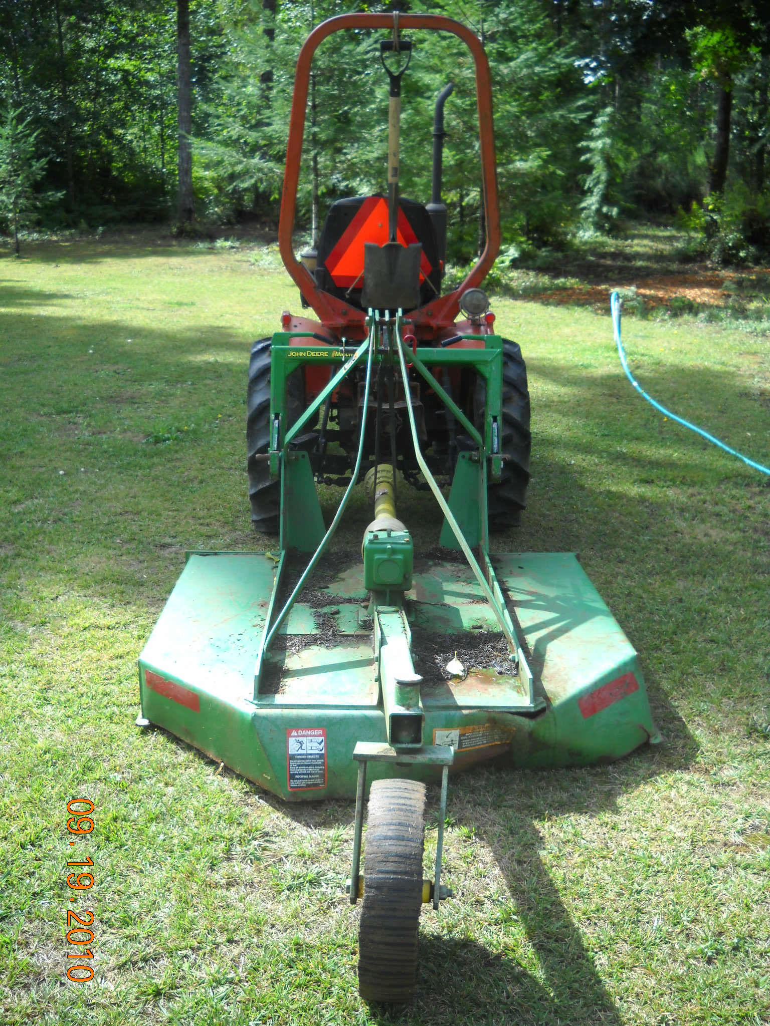

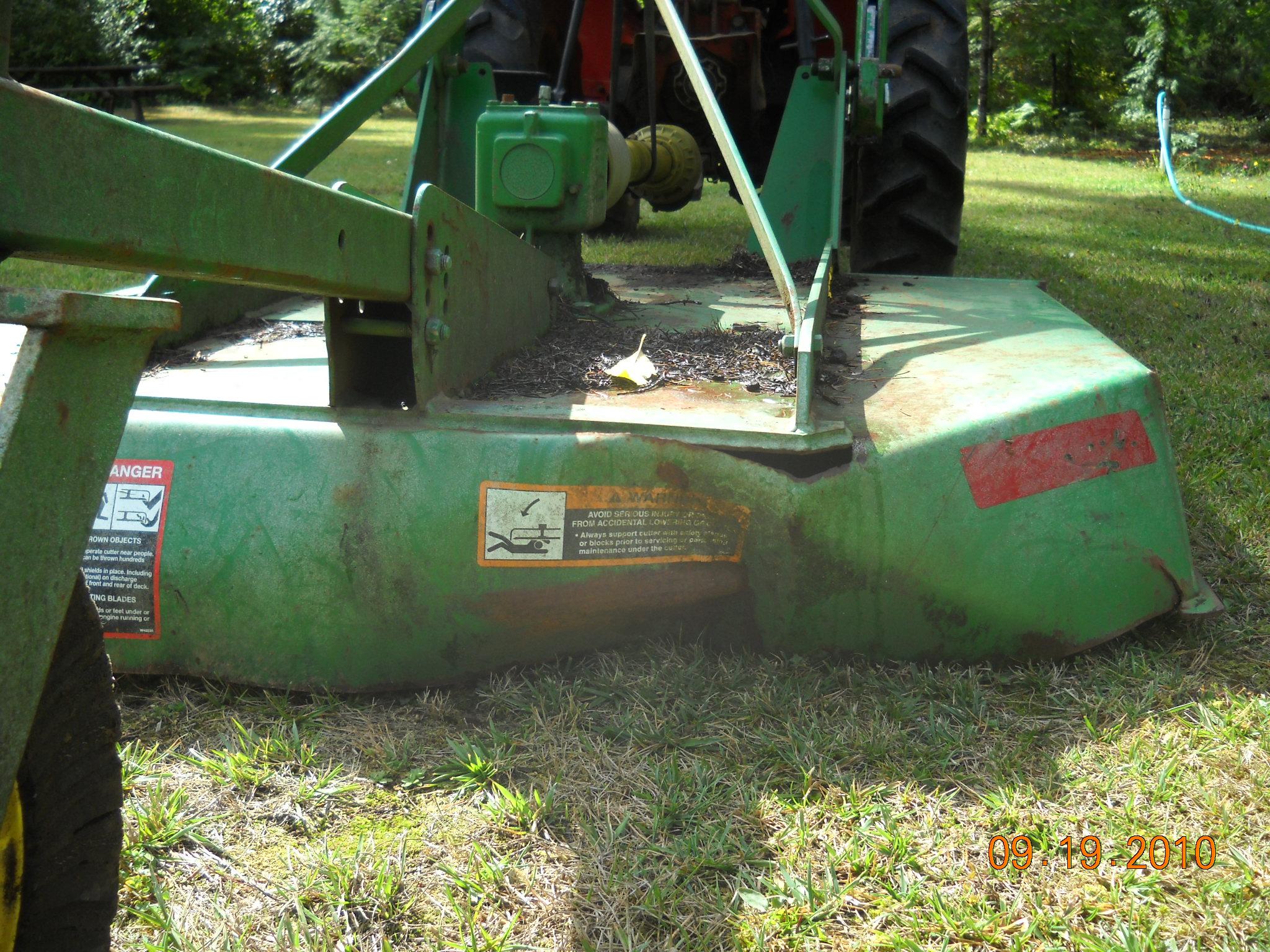

Thats not to promising, i got a pretty good bend in the rear lip, i think it was run into a stump. Any advice on straitening it out effectively? I need to get it fixed up. The pictures show it best.
   / Bought a John Deere 613 Rotary Cutter #8
What would happen, if you lowered the cutter over a short stump and used the tractor power to bump it out as you go forward? If this was tried, I would suggest being VERY careful in low gear. Ken Sweet

I like Sweets suggestion for fixing the one in the picture. If you can find a stump somewhere it might get the job done, but do it in small gentle tugs at first to see what happens.
