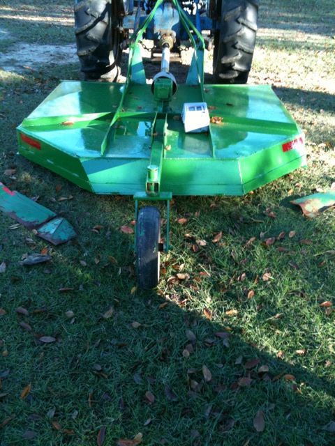

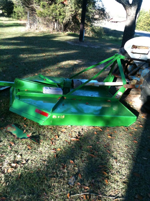

I worked on the shredder yesterday and today. I cut the entire rear portion out and welded in new 1/8" plate. It was a little challenging because the center and right portion of the rear are angled back, while the left portion is vertical. You can see this in the pictures posted above by JohnDeere3720. It was a challenge, but I like a challenge.
After getting it all fabricated back into place, I welded 2" X 3/8" strap around the back. I then used a brush and a quart of implement paint to try and seal it from the weather in an effort to keep it from rusting away.
I forgot to take pictures before I started so I will take some pictures of the metal I cut out and the end result and post them. If it's not raining tomorrow I should get the pictures up then.
After the fabrication work, I pulled it outside my shop door so I would have more light while painting. Just as I finished it began sprinkling. I put it back in the shop for the night.
The fabrication OR the paint work won't win any car shows, but I think I now have a very good shredder to use for minimal cash outlay.

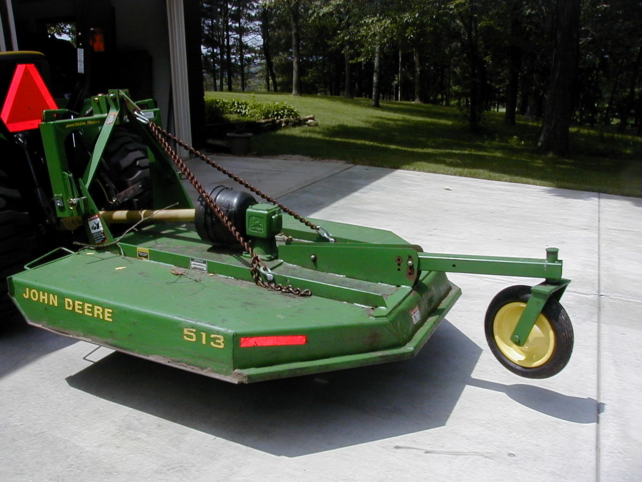

...................If I get it straightened, I am planning on stiffening the whole rear edge with 2 inch angle. Do you think this will be enough meat, or should I use something bigger.
Thanks for sharing your experience.
I have the 513, and I like to back into brush with it. Had the same problem with the rear skirting. I had my welder pound it back and weld on 1.5" square tubing along the lower edge and the angled sides. It is just enough to be able to back into heavy brush and strong enough to lift or stop movement. Works great. Your angle iron may just do as good as the square tubing.

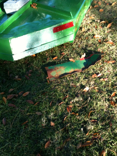

The pieces of metal on the left and right lying on the ground are the pieces I cut out. This was all that was left of the rear skirt. I forgot to take pictures before I started cutting.
I'm kind of proud of my work with piecing the plate together in the original angled configuration.
Here are the pictures:
