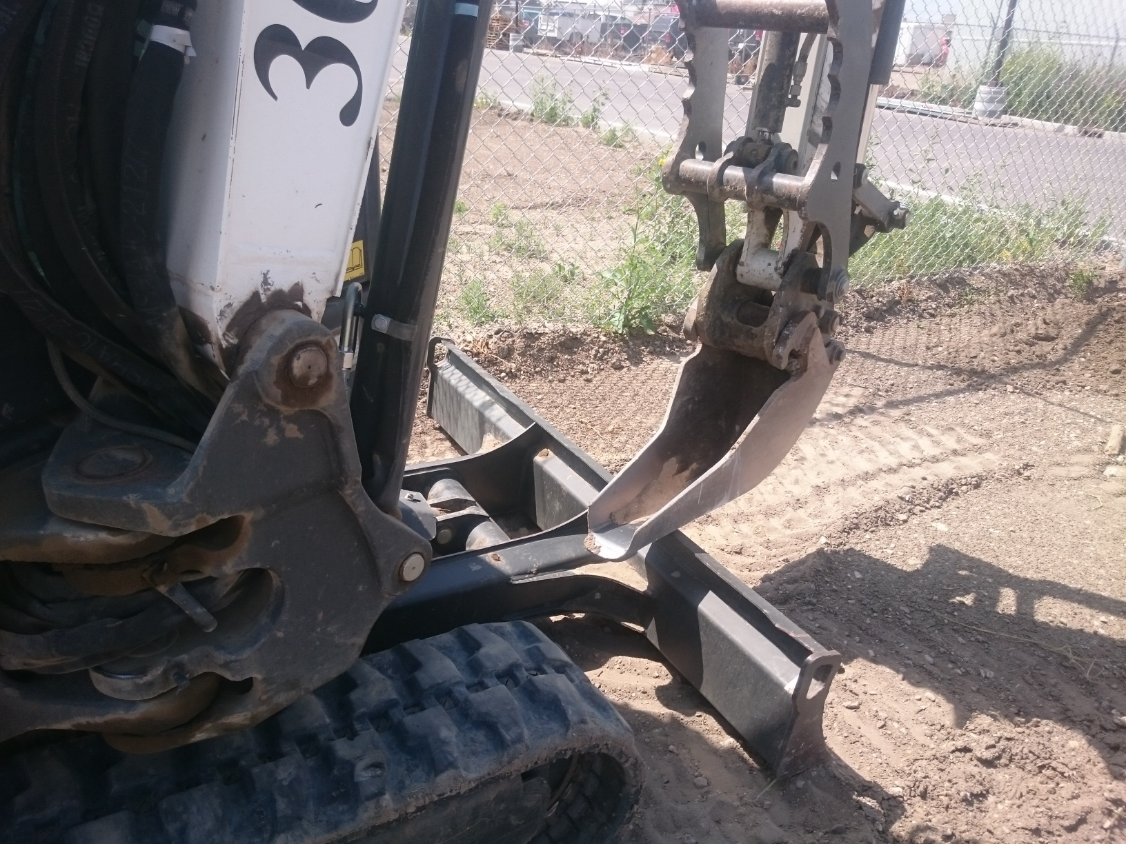

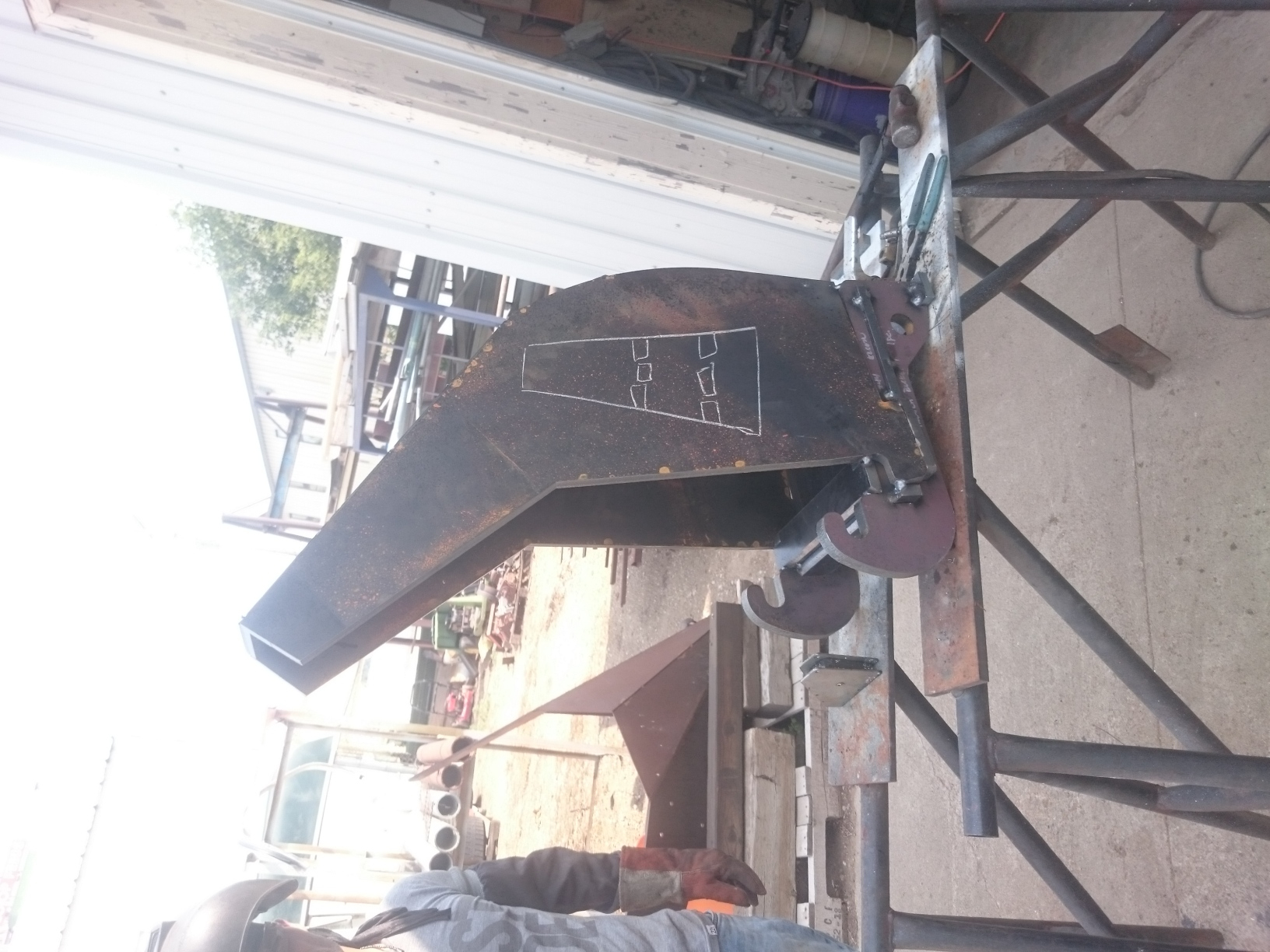

18 to 24 inch deep, not sure what you are doing but I wanted to install some electrical and water on my property, the EX had the 16 inch bucket but way too much of a trench so I made this bucket, it will go down a good 2 feet, made from 3/8 plate 6 inches wide at the tip with a grader blade edge the top is 12 inches, had it drawn on cad then cnc plasma cut, hardest part was figuring the X change breaking it into pieces but after that we have made many mounts and attachments, some being a 32 inch root rake, 36 inch x 10 tall grader scraper, root cutter, auger mount even a attachment with a reverse bucket we can dig the opposite so digging away from the machine, this one takes a bit to get use to
I am a electrical contractor so do alot of conduit. I agree even the 12 inch bucket is big for what we do at times. I love your bucket, might have to break out the welder

when you are ready I could give you the cad file to have parts cut at a cnc plasma or water jet shop,
