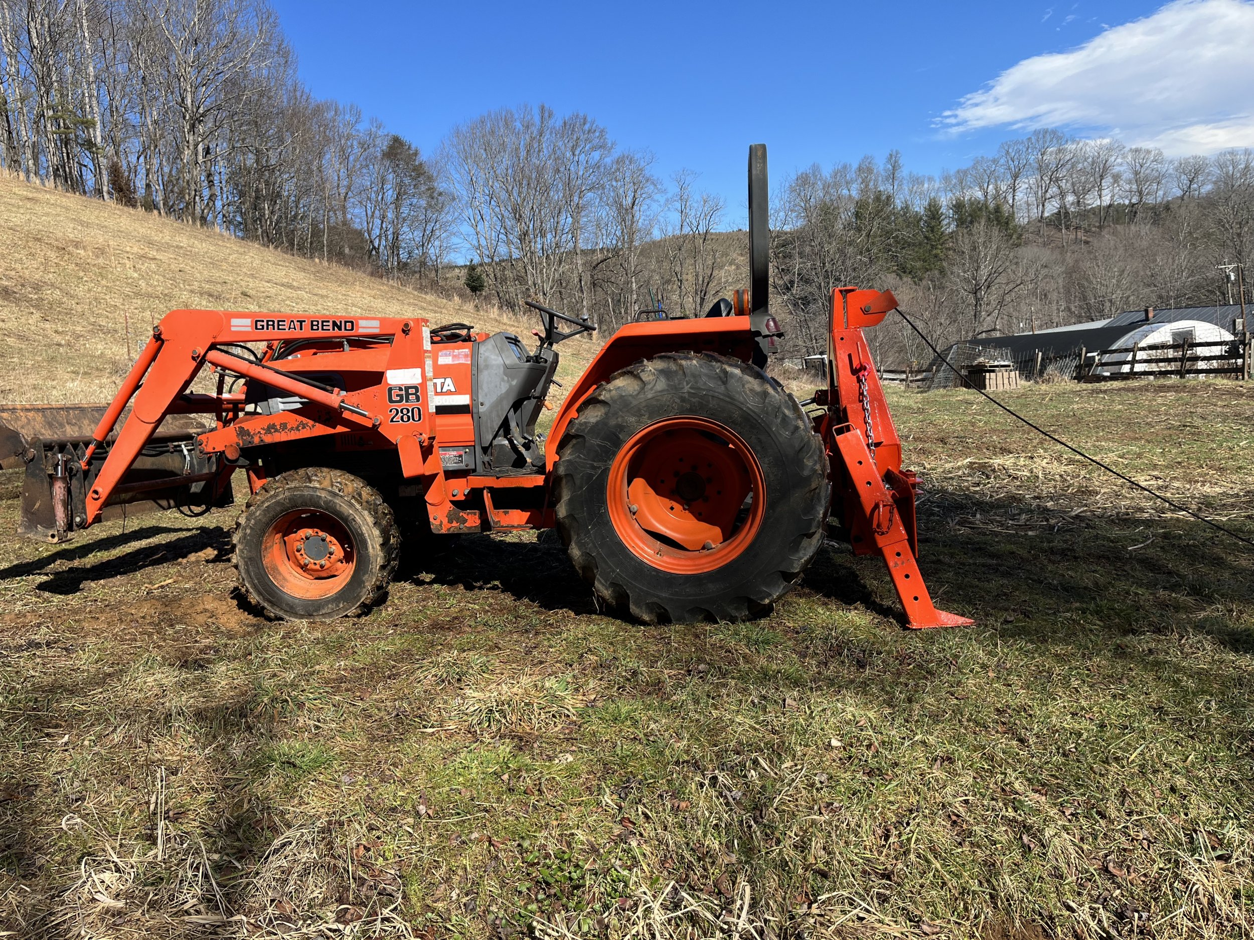

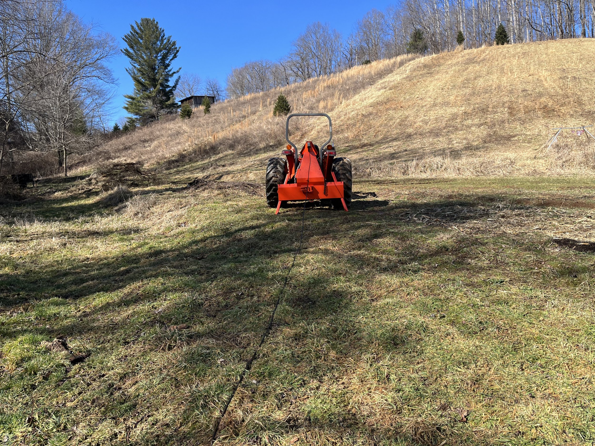

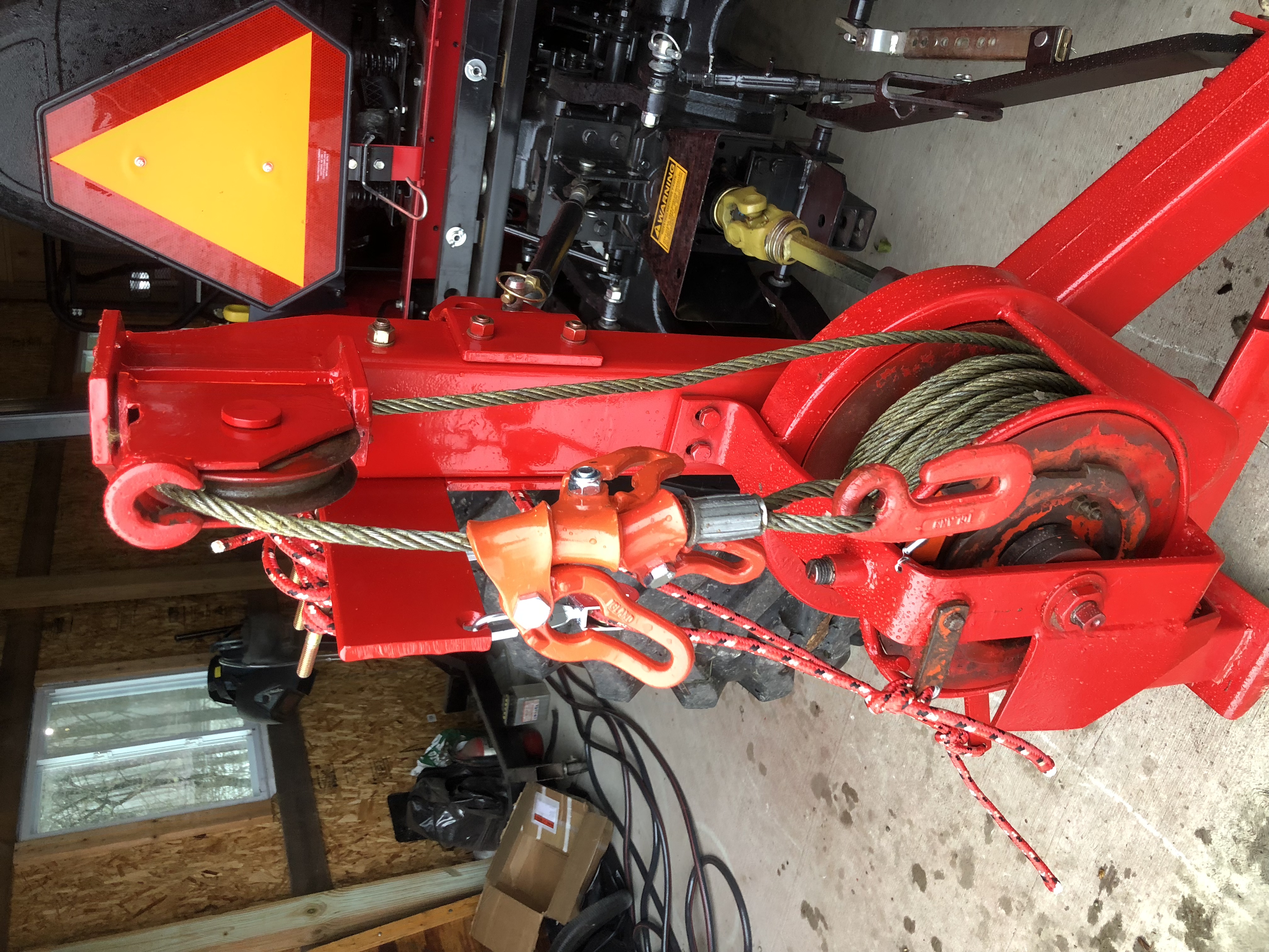

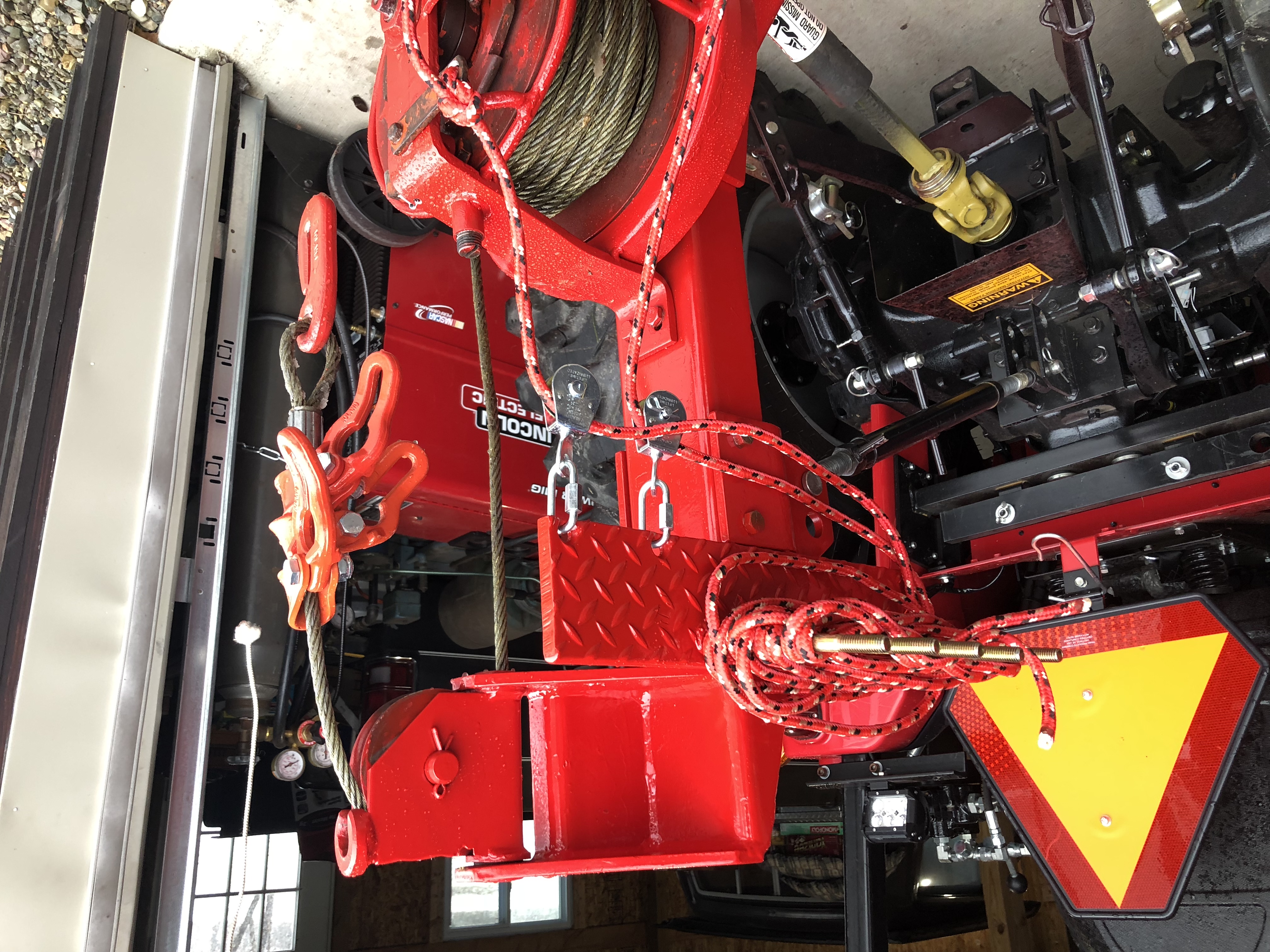

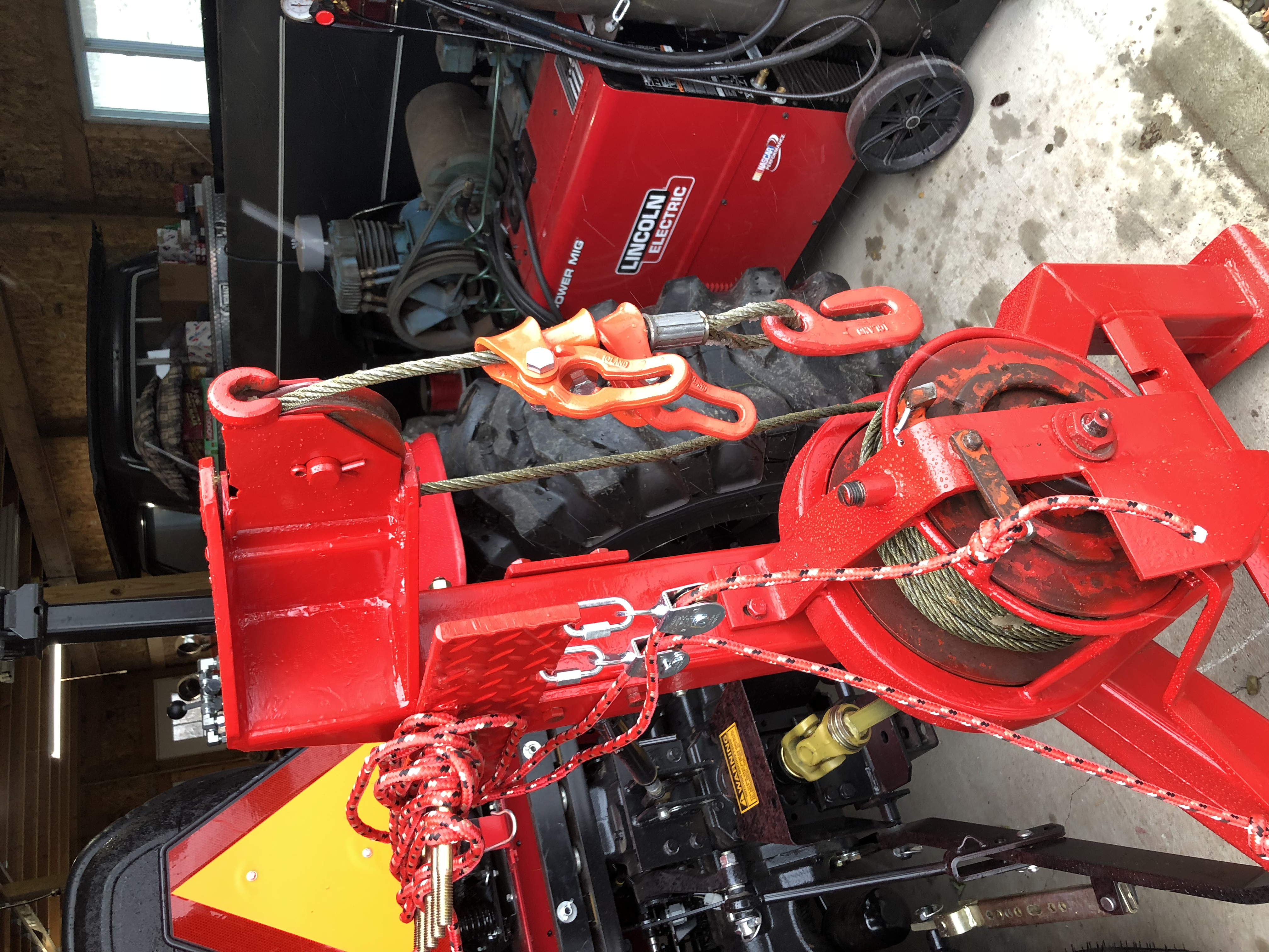

I picked up a Farmi PT410 last fall, just now getting to use it. It was in good shape mechanically, just looked rough. Repainted, replaced the clutch and brake ropes(different size and color works great).
You got a great deal on your older model, mine is maybe a 1984 model, paid about 3K and was glad to find it. I'm like you and trying to log on steep slopes. One word of caution, don't try to winch a single log downhill. It will roll in bad places and your winch and tractor cannot stop it. Two or more logs together seem to be ok.

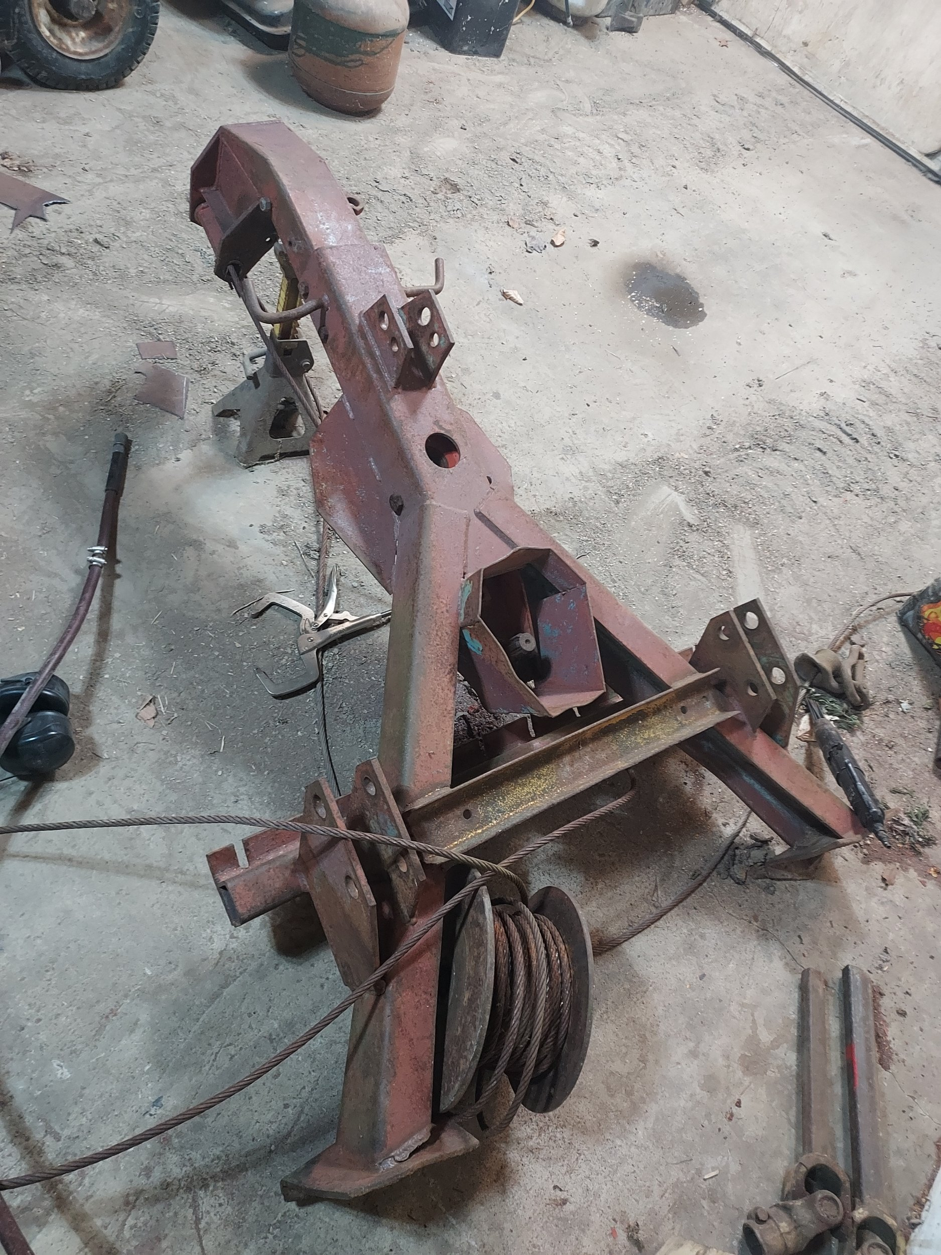

Did you have to repair or replace the leather clutch face? That is the only thing wrong with mine, it slips. And I can't figure out how to fix it.
Bill
There are adjustments for that.
Have you had it apart? On my first winch the leather (?) had come unriveted from the clutch disk. I put it back together using some brass bolts I had on hand, and never had another problem. I did also take the drum to a machine shop and had the flywheel surface turned.
