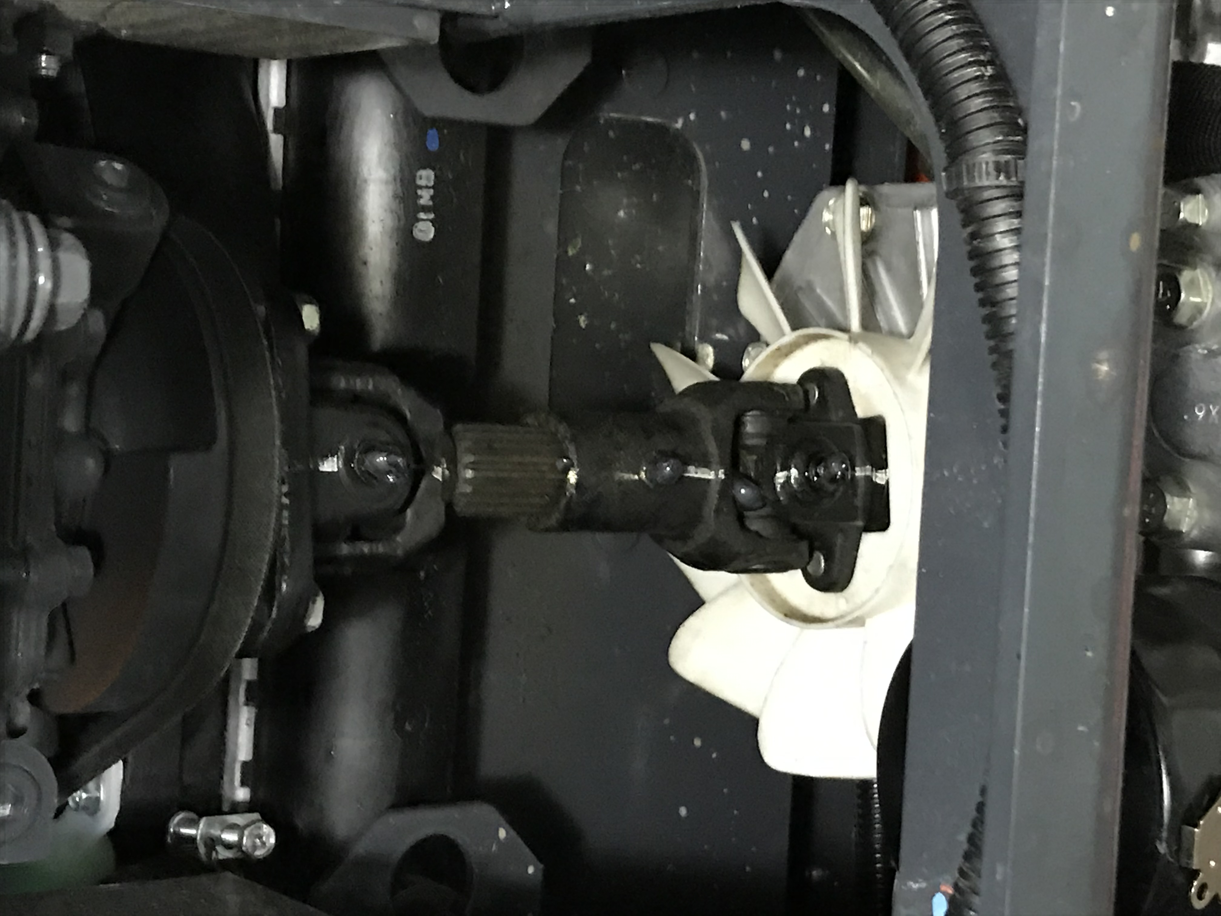

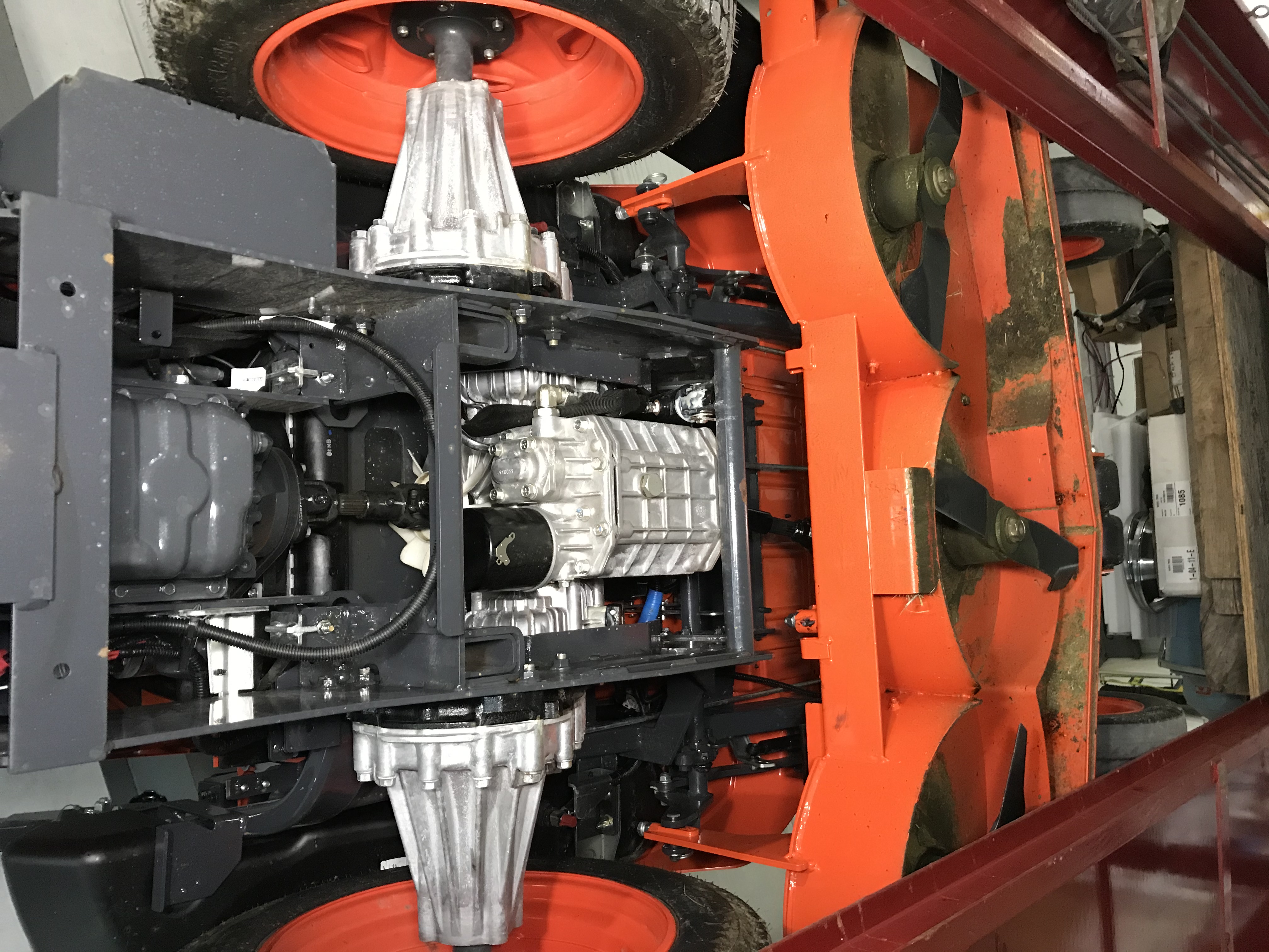

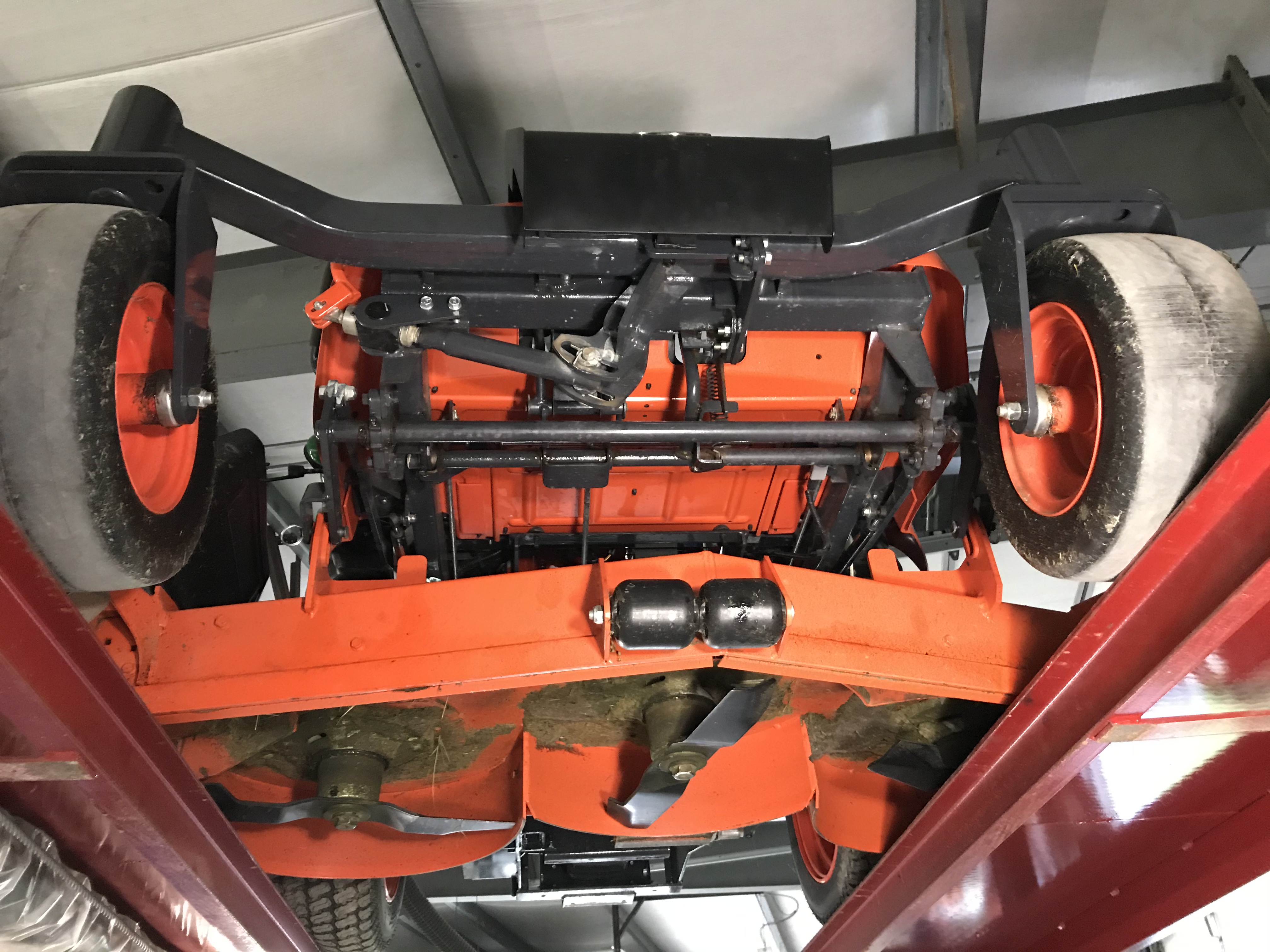

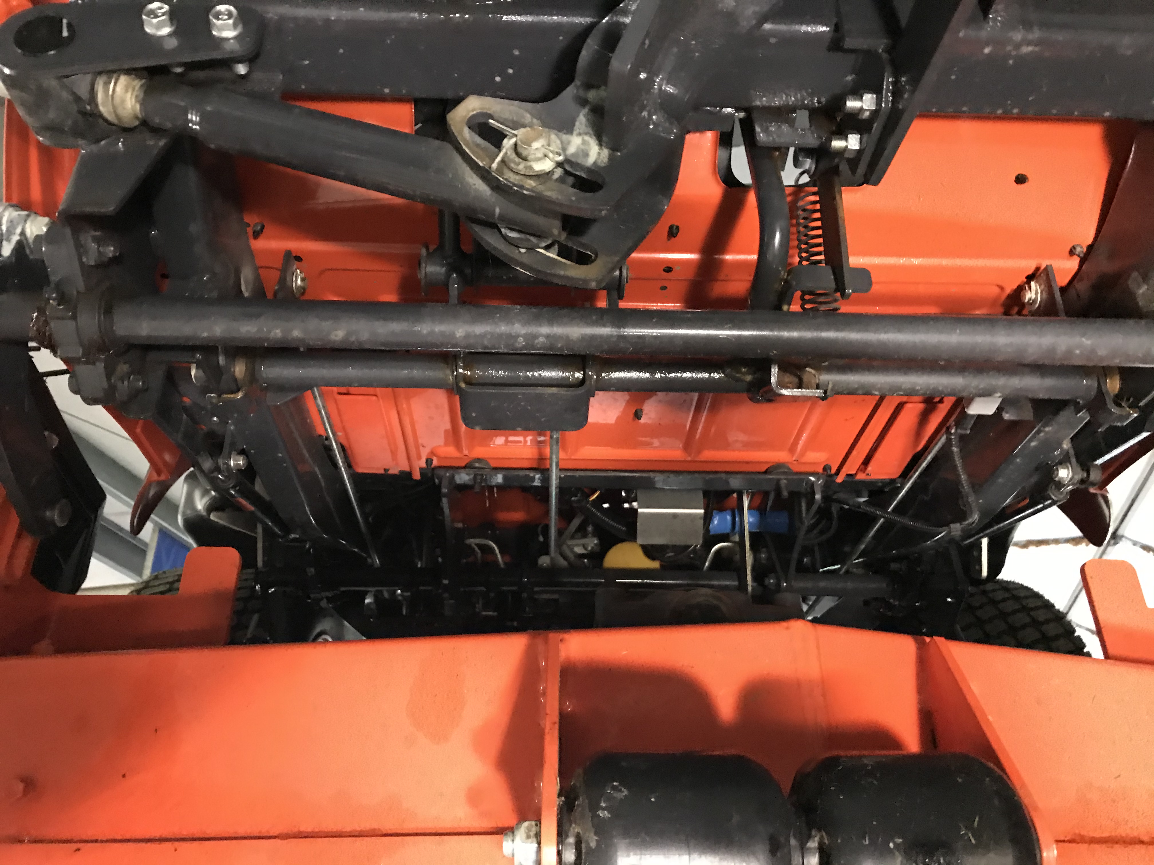

I ran the ZD 1211 up on my lift so I could inspect and touch everything, well designed and heavy.
As you can see the front wheels were just wide enough to run up the runway so locked the front axle just in case one of the wheels went off the edge.
After giving it some love (grease) one caster did roll off the runway with no consequences.
The hydraulic filter is located under the engine/transmission between the frame and the HST filter (yellow) is under seat. If you look closely you will notice I put a powerful magnet on the hydraulic filter. I did the same to the HST filter.
3 grease fillings can be seen on the engine to transmission input shaft.
The mower deck shaft is basically identical however I had to disconnect the shaft from the transmission to grease the universal on the gearbox.
Reading the operators manual I noticed that the mower gearbox oil specification is different among deck models.
Mine requires 10w30 engine oil while others require SAE90 GL3.
Curious as to why?
I noticed the universals do not purge like automotive applications so I carefully greased until I felt resistance.
When greasing the mower deck gearbox you should cover the belt so grease will not fall on it.
Any pivot point without a grease fitting got a touch of oil.
During my inspection I found the tires were at 18psi, 12 is the recommendation but I set mine to 10 which seems work well.
Hope this info is useful.

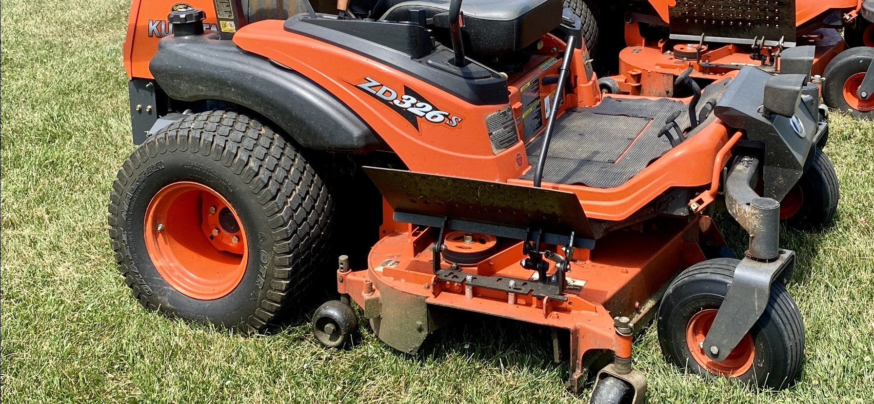

   / Bought a new ZD1211 #10
I assumed you meant your 60” deck did not have rear anti scalp wheels at all, and saw photos of other new 60” decks that were the same. My older zd326 has rear anti scalp deck wheels. Do you want a photo of that?
If you have a left rear wheel, there should certainly be one on the right.
#11
I assumed you meant your 60 deck did not have rear anti scalp wheels at all, and saw photos of other new 60 decks that were the same. My older zd326 has rear anti scalp deck wheels. Do you want a photo of that?
Yes a photo would be helpful.
There is one on left rear but not on right rear.
