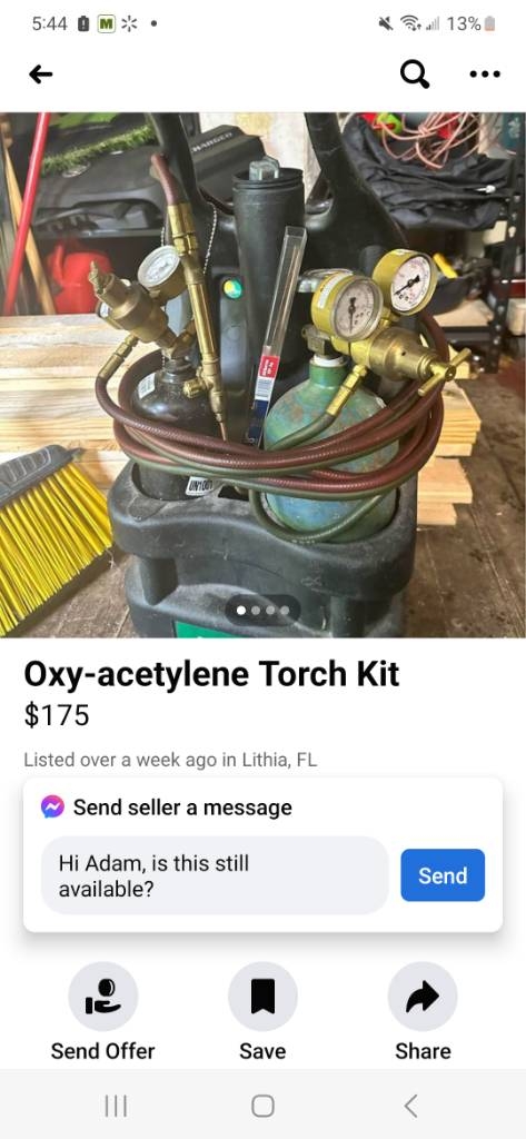

What's an outfit like shown in the pictures worth for resale?
Well, to buy the O/A kit set up new is probably $300. The stand alone is what we used 20 years ago when I was a plumbers helper, for soldering, and also, rarely to try to melt lead out of Old cast iron DWV lines. For resale; I would probably guess $125-200.

Lotsa folks are confused about oxy/acetylene torches as opposed to oxy/fuel torches. So I will try to help explain. Oxy/acetylene flames burn very hot. Though not the hottest flame oxy/acetylene is pretty close to the hottest. This means that the flame can be used to melt steel, which is what you need to do if you are welding steel.
Common oxy/fuel flames, such as oxy/propane, don't burn as hot, so are not good for welding steel.
Though this seems wrong, common oxy/fuel flames have more heat energy than oxy/acetylene. So even though oxy/acetylene burns hotter that oxy/propane, the flame itself, when burning properly, is smaller, and so delivers less actual calories of heat into the work. The upshot is the different flames are better for different jobs.
Most of the time when really concentrated heat is needed oxy/acetylene is the best choice. When cutting steel though oxy/fuel is the better choice. This is because the torch flame only pre-heats the work enough for the oxygen to start burning with the steel. Oxy/fuel steel cutting is an exothermic process. This means that the oxygen reacts with the steel and produces heat. The reaction is fast enough that the steel melts, and some actually burns.
Oxy/fuel is also usually plenty hot enough for brazing and silver soldering. And air/acetylene, like that big tank and torch shown, is great for soldering copper pipe. Once again the acetylene flame has enough concentrated heat to get the job done better than air/fuel.
When soldering, whether soft soldering like plumbing stuff, or hard soldering, commonly known as silver soldering, it is vitally important to heat the work fast. This is because the flux is absorbing oxygen and so keeping the oxygen from contaminating the solder joint. But the flux can only absorb so much oxygen and the longer it takes to melt the solder the more oxygen the flux needs to absorb. If it takes too long to heat the joint the flux will absorb all the oxygen it can and the solder and the parent metal will start to oxidize and the solder will not wet the metal and will not flow. Air/acetylene torches will heat the copper pipe so fast that the copper doesn't have time to wick away the heat before the joint comes up to temperature. So soldering copper pipe with air/acetylene is much easier than using air/propane or air/MAPP.
I know the above explanation is brief and a lot of info is not included but I did cover the basics. So you need to decide if you need the tiny oxy/acetylene set. If you plan on doing any copper pipe plumbing requiring soldering then you should keep the larger tank and torch combo. It is way better than using propane or Mapp gas.
All the tanks shown are owner tanks. If they need to be re-filled most places will just exchange them, they won't re-fill yours and then give them back to you. If the tanks are out of date then you may need to pay a charge for them to be tested. In any case there is no benefit to having your particular tanks re-filled, exchanging them for a full tank is fine.

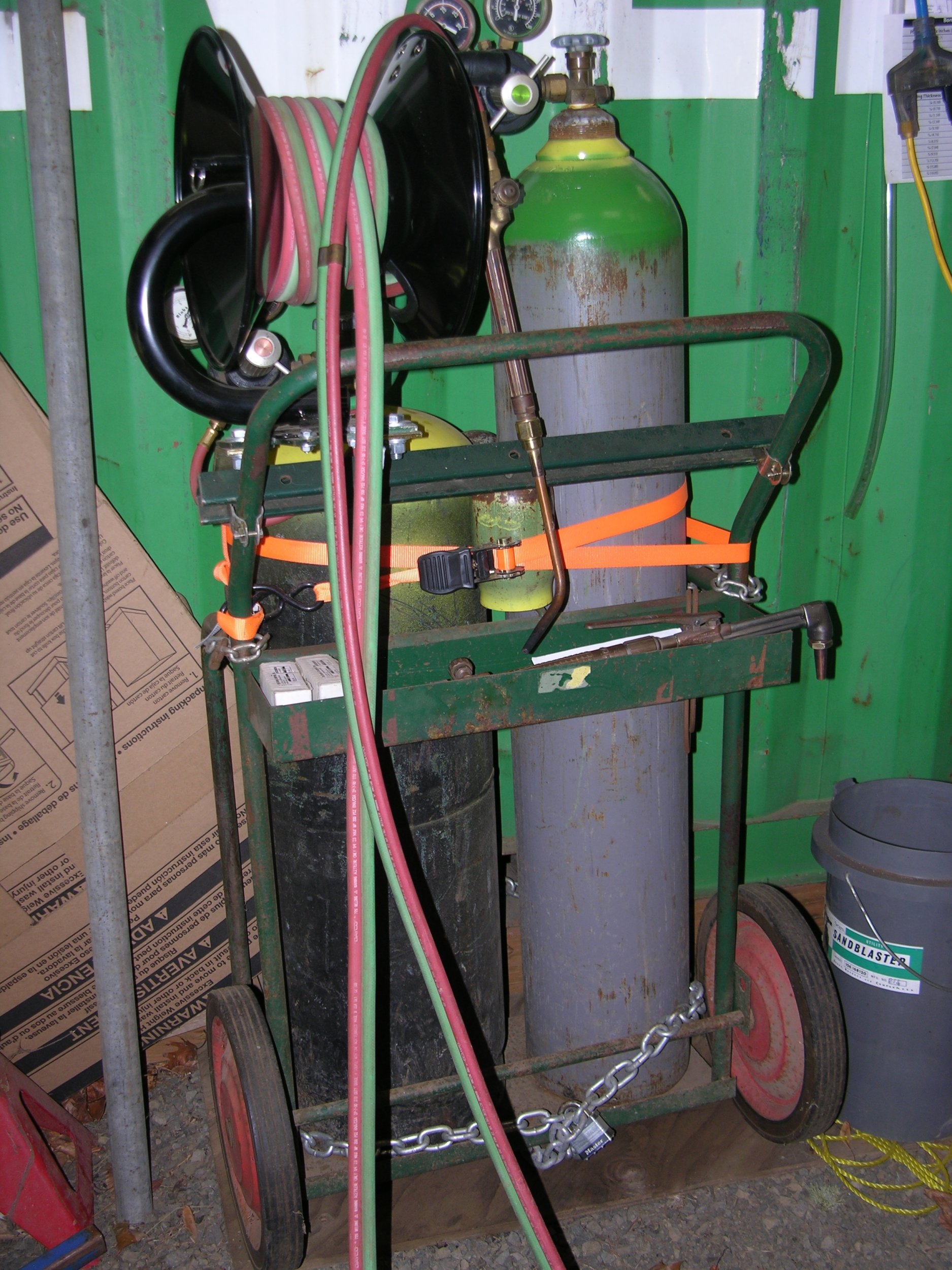

Either way, if you plan on using even the SMALLEST rosebud you should be using the LARGEST acetylene tank available - possibly even manifolding MULTIPLE acetylene tanks if possible... Steve

Mostly all I do is heat up stuff that won't come apart and sometimes burn a little. I have my numbers out on the cart but think I keep ACY at 5? or so. I'll get the card later. I can't remember OXY but got the numbers when I took a welding class at a tech night school 15 years ago. I have flashback arrestors and view myself as as cautious.
I don't remember my tank sizes but think OXY is 120 and ACY maybe 90 but that's a guess. I keep a file and they're in there. Any help appreciated.
   / Bought a portable oxy/acy setup and need help understanding #20
I hope you don't really mean "keep" (as in, NOT backing off regulators when not using) - I owe the previous 60 years of my life to NOT being quite in the path of an oxy regulator's stem when our so-called weldor replaced his oxy tank - when he (not slowly) opened the tank valve and the regulator stem missed my head by about 2" before going thru 2 plywood walls and bouncing off a parked car outside -
I was 19 at the time, and when my legs stopped shaking I drove to the nearest welding supply and got one of their safety booklets on acetylene - near as I could tell, our "weldor" did NOTHING right. I told him to let me know if he was going to do ANYTHING with the torches so I could be SOMEWHERE ELSE.
Best advice I can give is to not SKIM the info in the previous link; I believe there's no such thing as too much info when dealing with explosives... Steve
