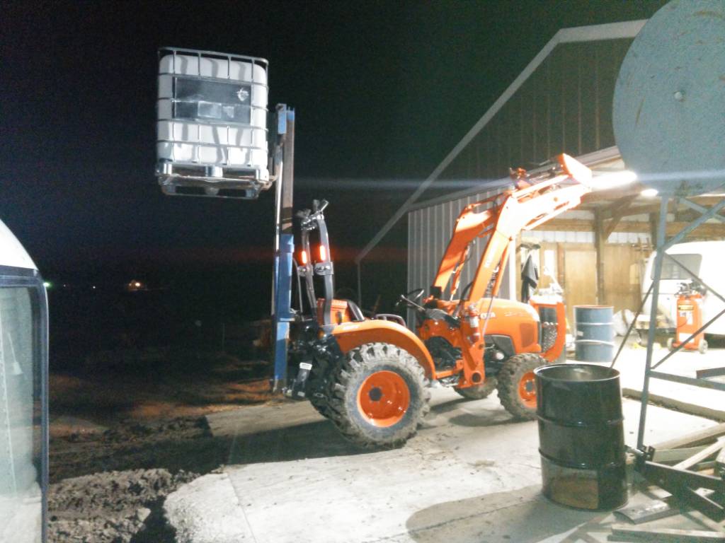

I had a 3pt forklift briefly for my L3200. The lift capacity of the forklift ended up the same as my loader. I ended up selling it as it didn't get me much for the extra complexity.
I could lift an IBC totem 1/3, maybe only 1/4 full on each, it's been a while. Whatever it was it was the same amount. The 3pt stalled out while the cylinder in the forklift was still going strong. I didn't want to overload & damage the 3pt so I never messed with seeing how much the forklift itself would do. It was a bit further back as i use a quick hitch. Might have gotten more lift without the QH, but again a lot more hassle.
I like the clamping bit on your forks. Thought about doing something like that on the forks for my new L4060. But that eats up lift capacity that's still in short supply. That & i have way to many projects already.View attachment 663633View attachment 663632View attachment 663631

Those extensions are a little scary. I wouldn't put much weight on them, one looks bent already.
Yes it is and I have plans to stiffen them up. I may just remove them and make something up that is much heavier duty. I wouldn't consider lifting anything with the end of the forks like they are.

Can you fix your attachment pictures so that we can see them. I agree about overloading the 3pth. Breaking anything back there would be expensive to fix. The forks have axwidth range of about 2 to 6 feet. They will grab in both directions.

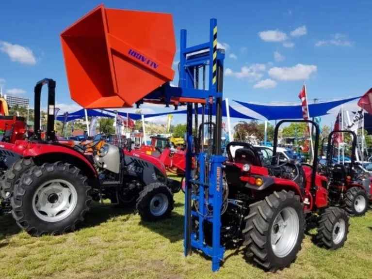

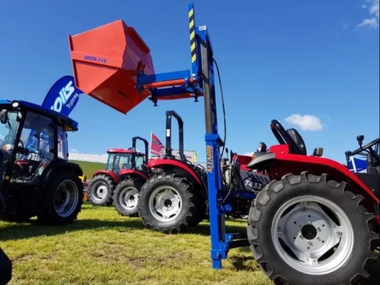

They do make those lighter forklift for tractors. Not exactly for SCUTs though but can work. It's used a lot in orchards to carry and load the boxes full of fruit. I don't know exactly the name of the boxes but it's the size of a IBC tote, but half of the height.
This one does have the dumper attachment, but it can quickly be removed and it's just the forks then. It's fitted to a TYM T393
And a video of a slightly bigger forklift on a slightly bigger tractor but barely bigger than the TYM. It's a 70HP Antonio Carraro with a reversible operators platform that makes for a very nice off-road forklift.
