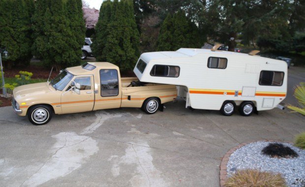

I googled bumper pull camper for 1/2 ton truck - out of curiosity (have 2 and a 5 year old) and find this. Too bad you cant get stuff like this anymore. 1981-Toyota-Dually-Pickup-620x380.jpeg
