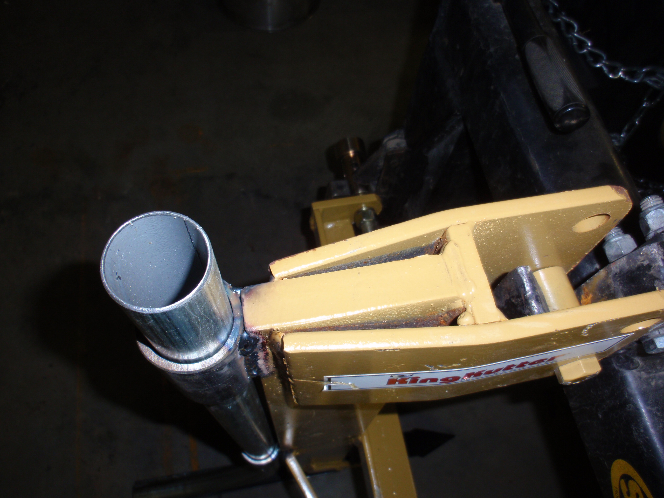

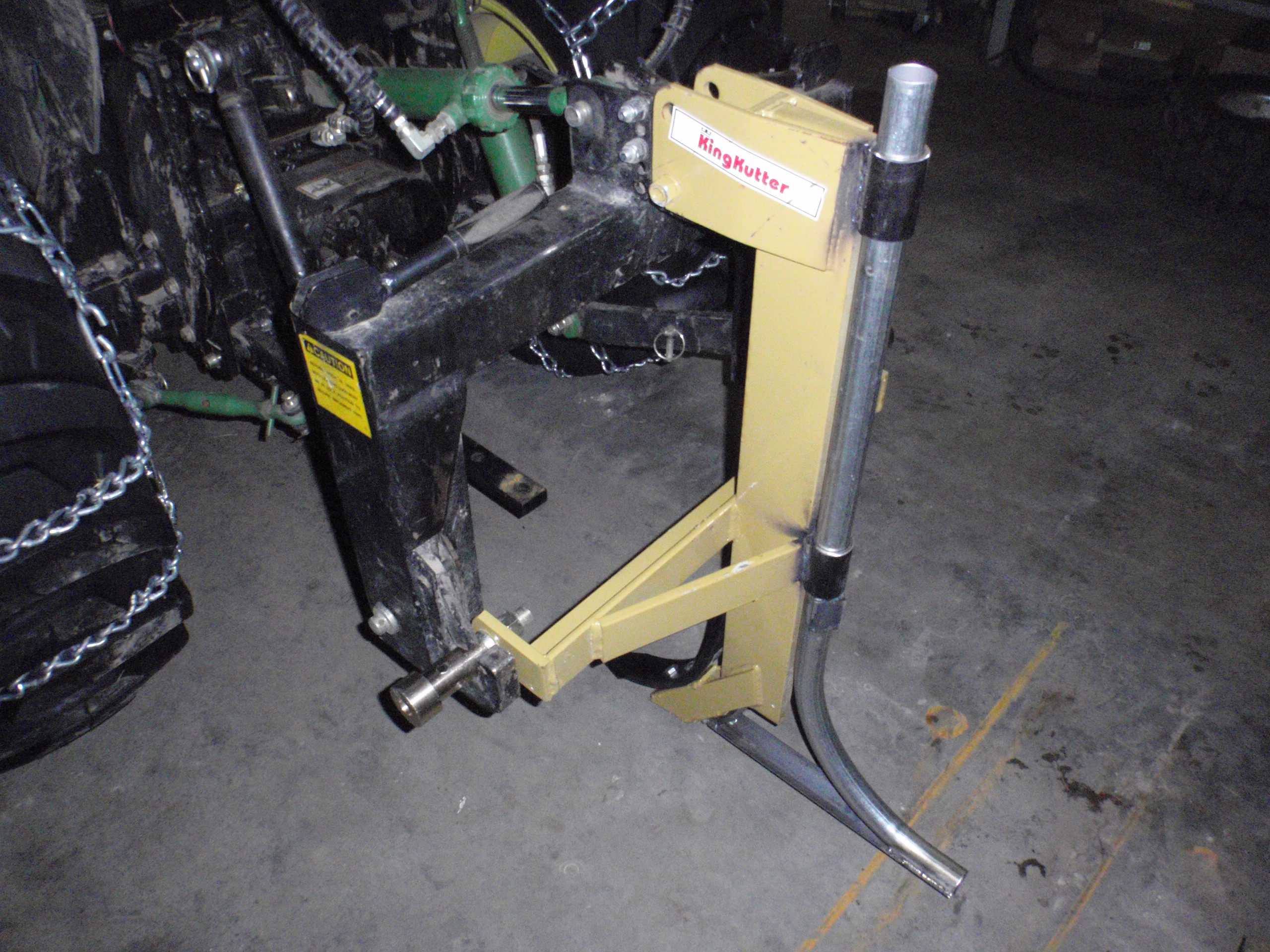

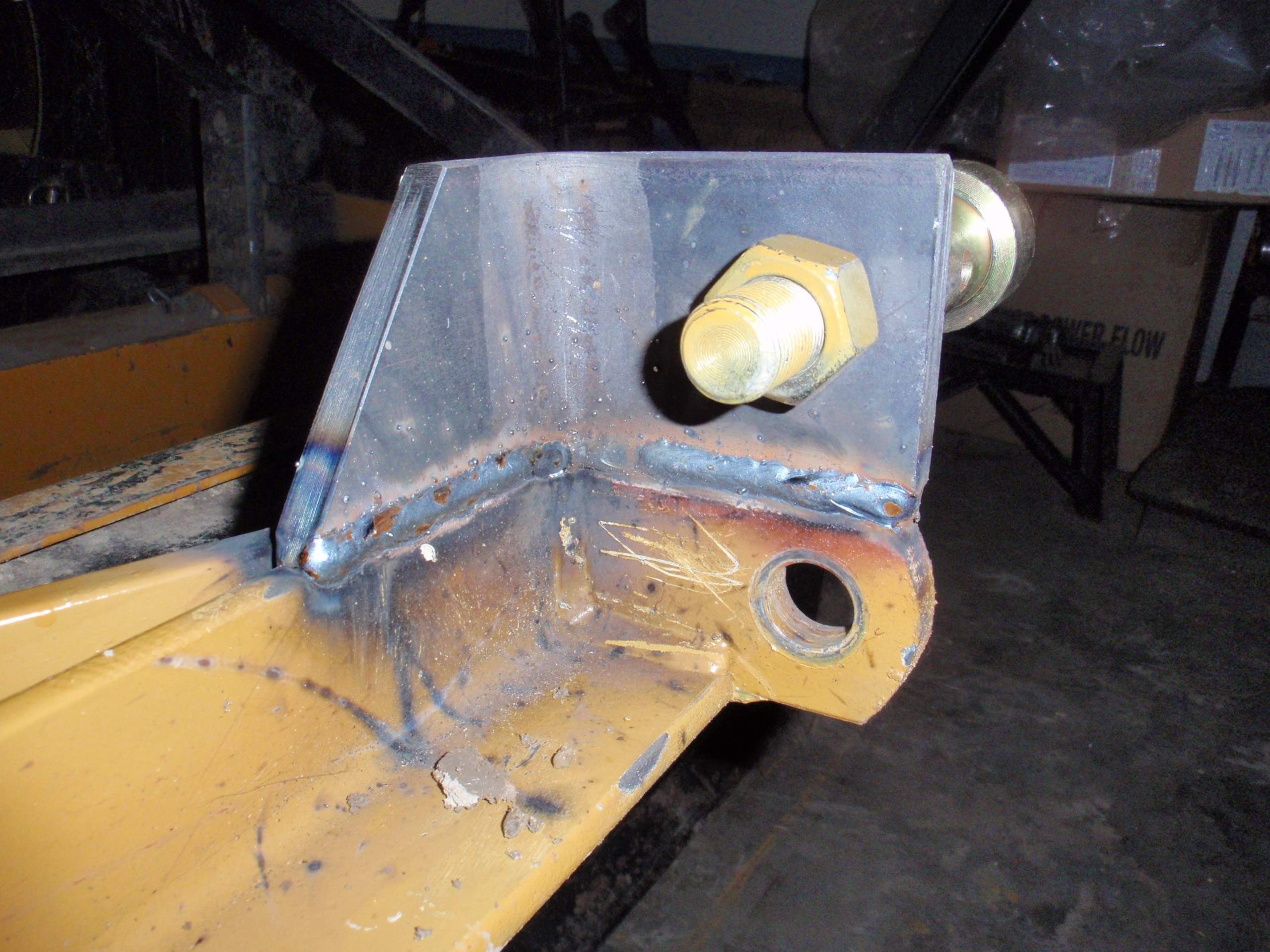

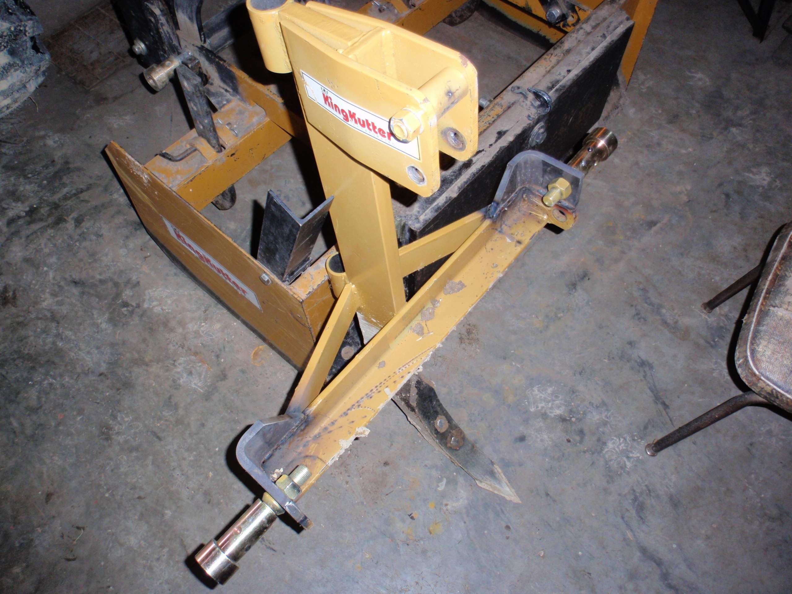

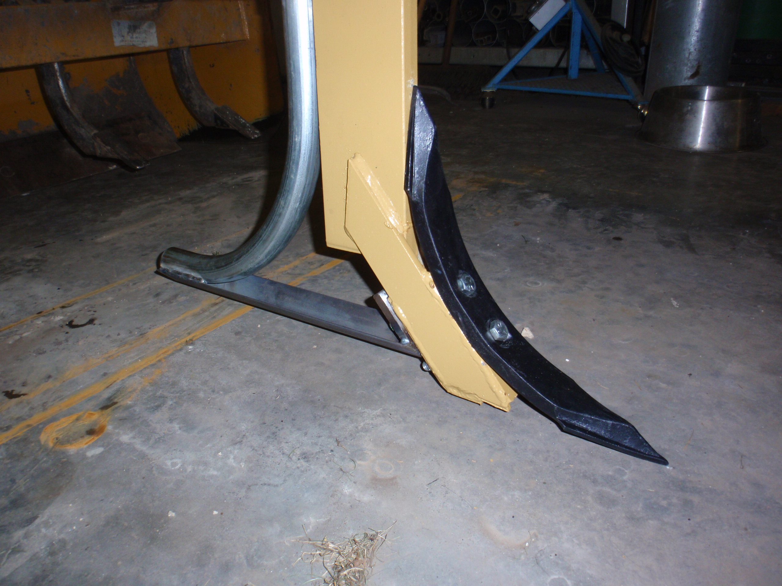

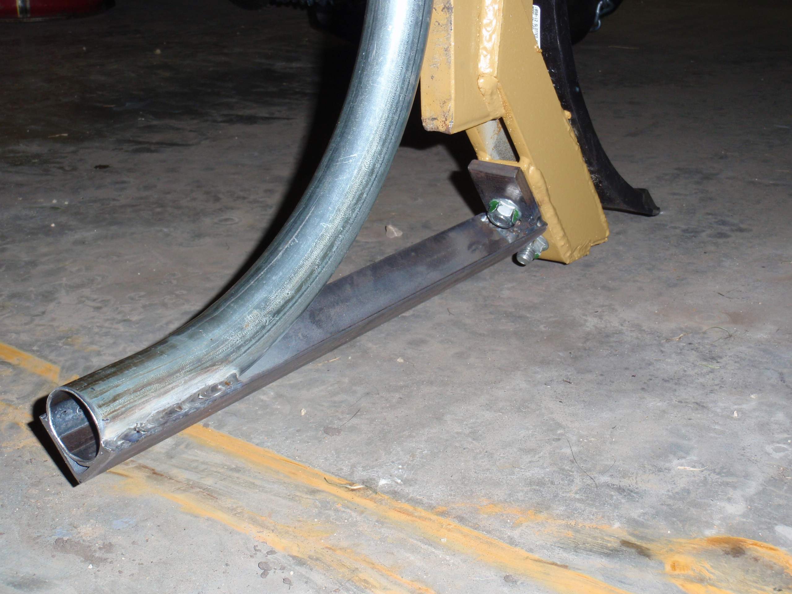

Last week I picked up the King Kutter middle buster at my local Fleet Farm store. Also bought myself a tillage tine, as shown in the picks. When the middle buster "plow" shape is unbolted, I can then bolt on the tillage tine, and the holes line up just fine. That makes it into a different animal. When that was done, I immediately realized I had to fabricate and add the cable and irrigation tubing layer addition to it. After trying it, I saw that it doesn't go into the ground as far I liked, because my tractor's draft arms go only so close to the ground. So I added a 3 inch flange to it with a new lower pin mounting hole. Now the point will go in about 16 inches. I will get this repainted as soon as possible.
