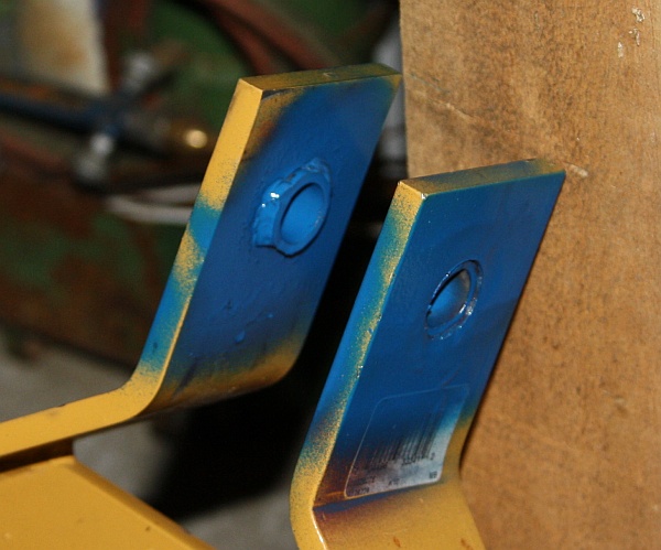

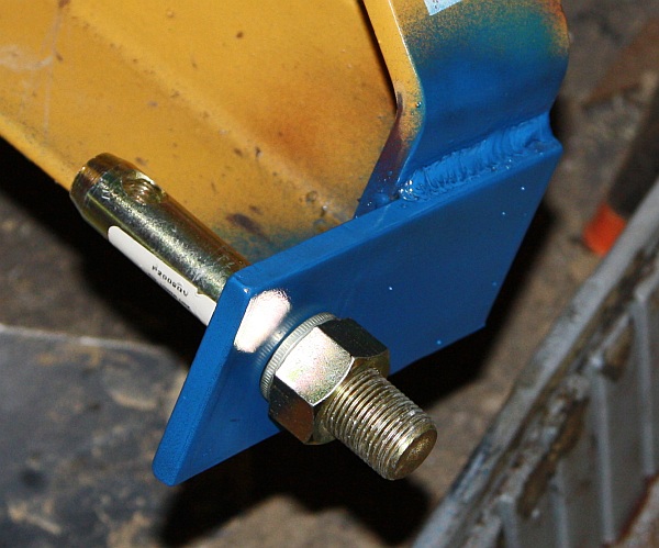

I bought one of those 2 to 1 bushings, cut it in half and had the local welding shop weld it in. I also had some tabs welded on so I could mount the pins facing in for easier mounting on my narrow 3PH.

I got to playing with it today, thought I'd post a couple pics. I also have a question. The lift pins are standard cat 1, but the hole for the top link pin is huge, the head of the pin will fall right through it. Kinda like they drilled it for a cat 2 or 3 pin. Anyone ever run into this? Is there a pin with a large head that won't fall through or will I just have to weld a doubler plate on it with a smaller hole? The spacing is also really wide like it's meant for a bigger top link.

I don't have one with an L shape, the pins on either end of the top link are identical. Came that way.
I was watching one of Everything Attachment's videos and noticed they used a big fender washer on the pin to keep it from falling through the hole. I just closed the hole up with a bushing so it would be the proper size.
