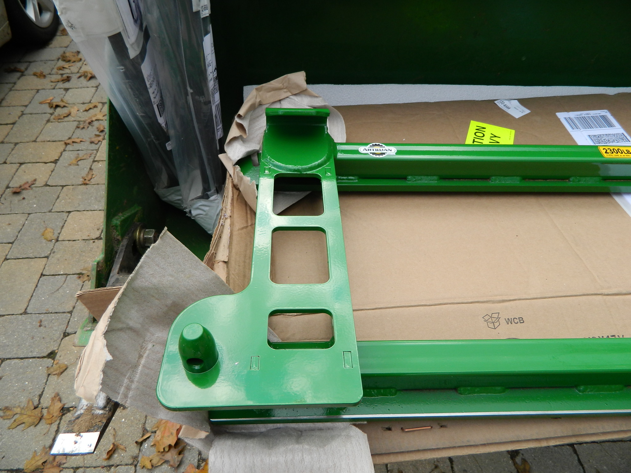

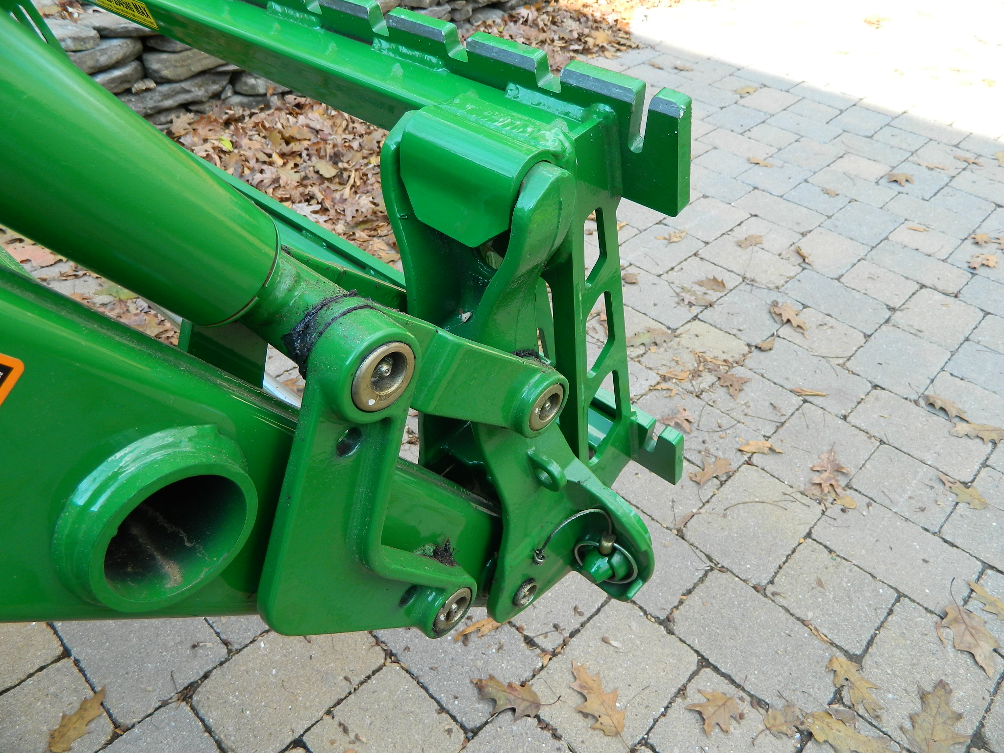

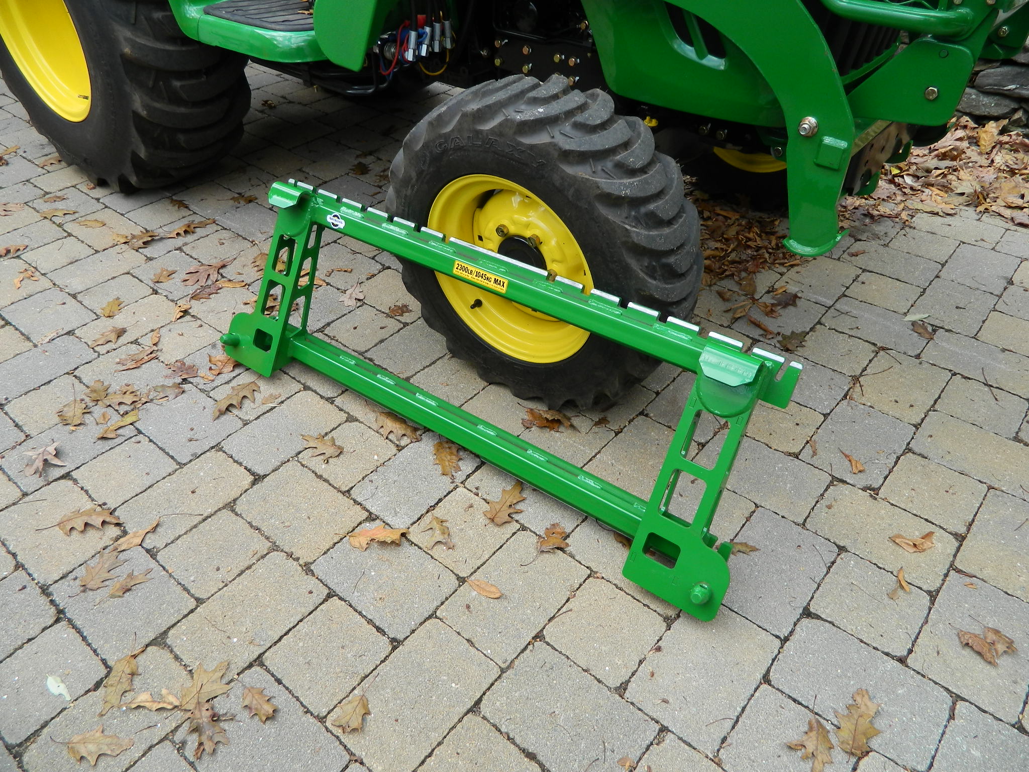

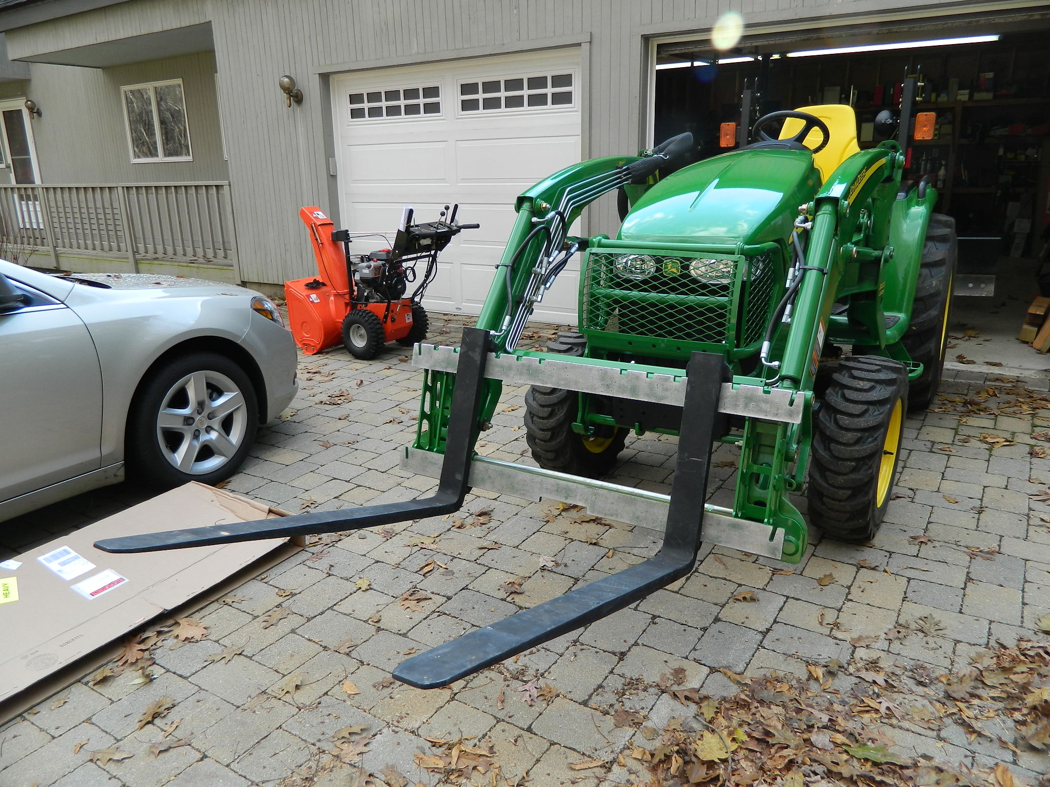

Well all the tree damage from the Northeast snow storm forced my hand. I got a set from Chris Perry at Artillian.com and I must tell you that the design, material quality, fabrication, welding, painting and packaging are excellent. The tolerances for the QA frame are perfect. Hopefully the pictures show you the details of fit and finish. The tines are 42" which for me are the right size. Another feature on the tines is an over-center lever instead of a pull-pin for locking the tine to the rail. Chris spends a lot of effort on packaging/product protection for the QA frame. It took more time removing the protection than putting the unit together on the loader frame.
Functionally, they work great with excellent visibilty. Also find the chain slots on the rails good for securing the load.

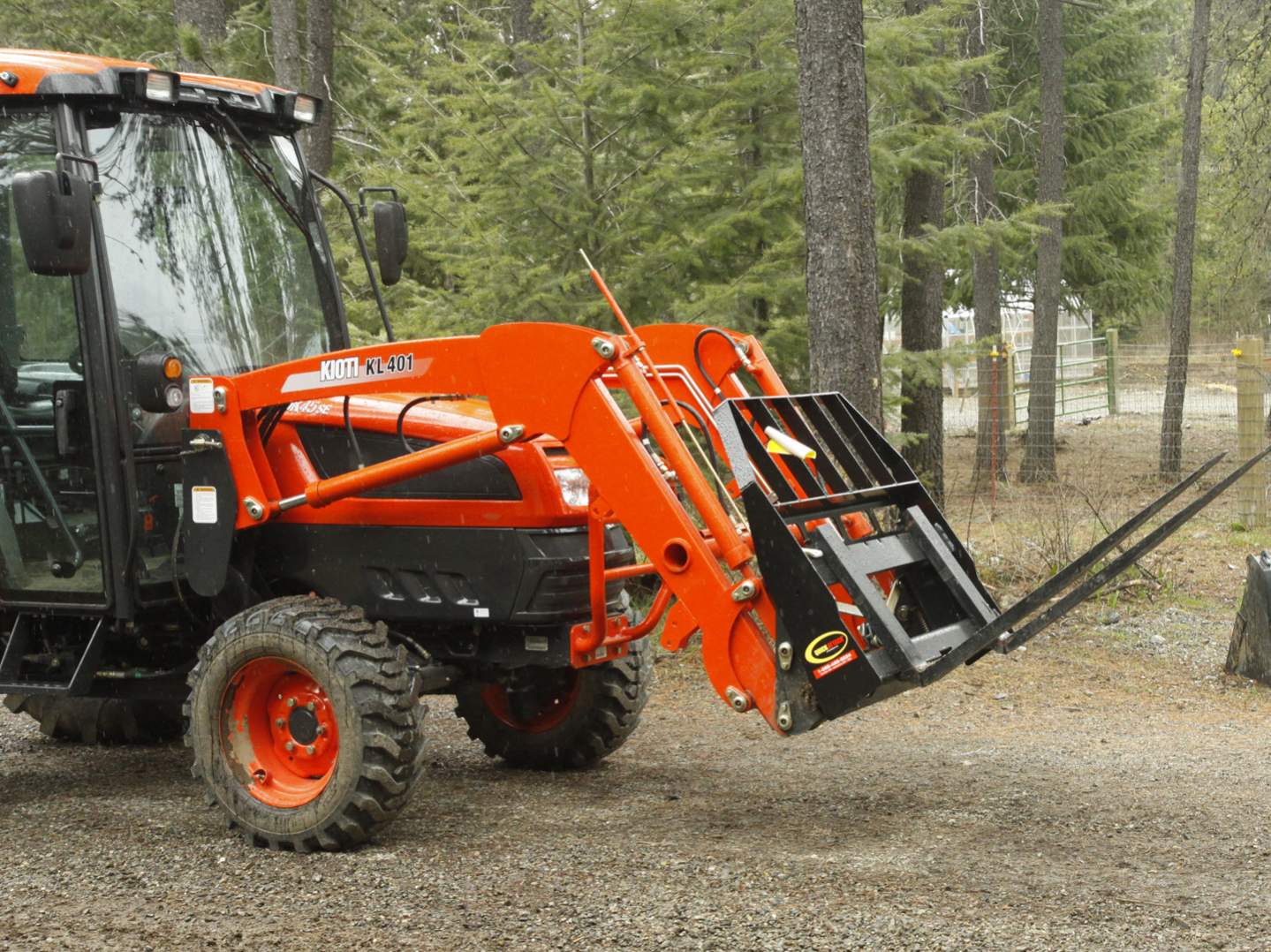

They look nice. i love mine . i do more with them then i ever thought i would need to. I even moved my hot tub with them.
Mine have a kind of backing plate though to prevent things from coming over the top of the forks. I kind of like that safety feature, but it does add to the overall weight of the forks.
some people here say then never take their forks off, hehe. I dont see that happening, but its amazing how much stuff they can be used for.

Looks good. Not much protection on the top. Be carefull not to roll one of the logs onto that goodlooking tractor ... not to mention right down the loader arms to the operators station.

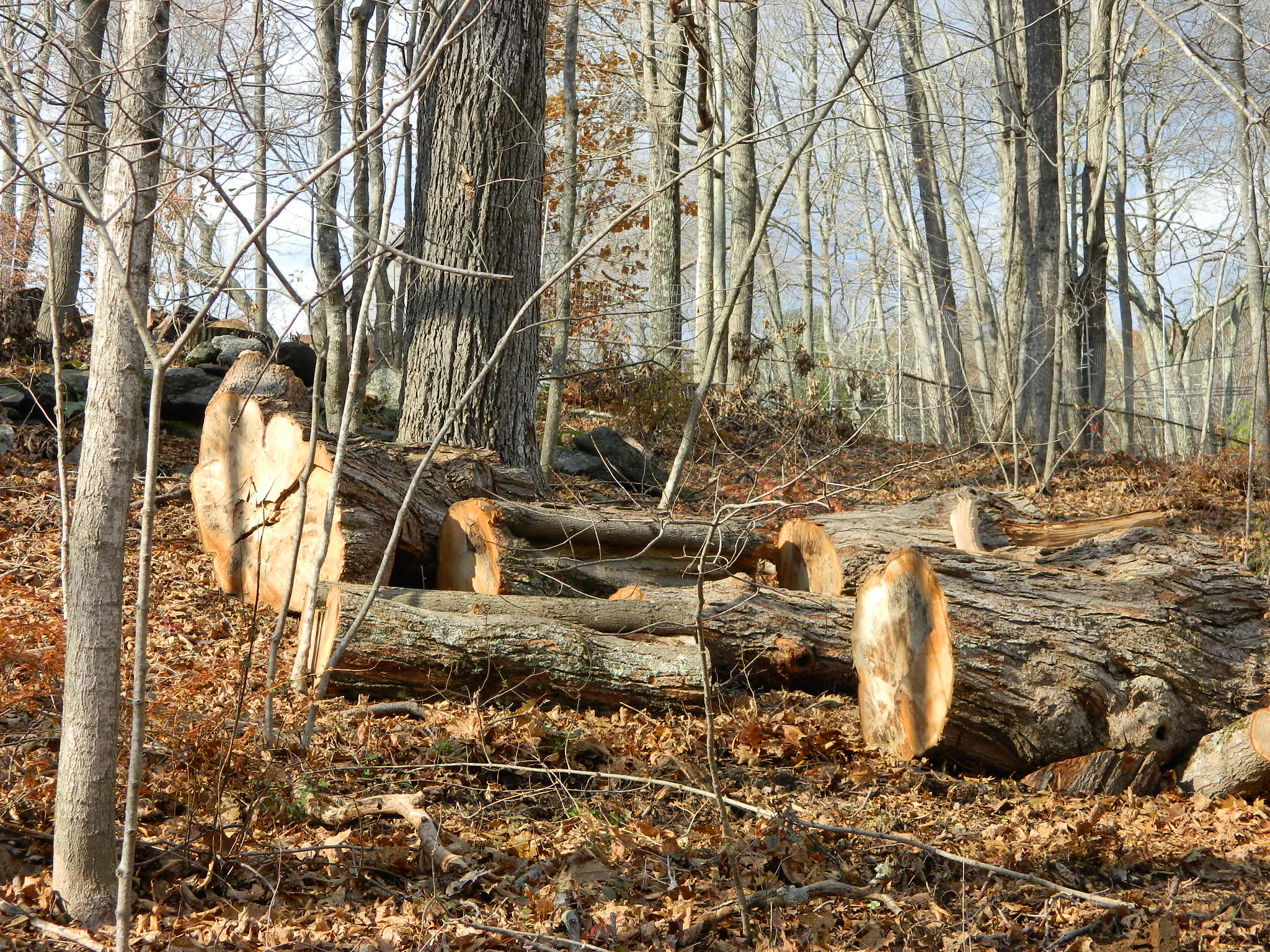

Thanks guys for the comments. One thing these light weight forks give is good feedback to a load imbalance when doing the initial pick. Set it down, and try again. It seems the 'sweet spot' for stability is when the heel of the forks is at the same level(+ -) as the center line of the front axle. The pix is a 35" dia 46" long sugar maple. As you have said I need a taller protection bar for sure.
There have been numerous times when guys comment about implements being designed to work in tension or compression. My question is what's your experience with using tines in the 'dump' position to back drag wood out of a hole so you can load from the front? Doesn't seem like a good idea, but what do I know.

I believe I'd add a backgard above the upper rail. One time something comes over the top and you'll wish you had a backstop.
far as a tolerance on a Bobcat style QA plate, about 1/4" is acceptable.

Yeah. They may have fine fit and finish but without a backstop they look dangerous to me.

With regard to a backrest on the forks, I fully understand these preferences. When these forks were conceived, the original intent was for use on a 2305 subcompact machine with little lifting capability. Every ounce of weight mattered (matters). The 18" of frame height was considered enough backrest protection. Still, for those who wanted to add something higher, the frame was offered in an unpainted state for folks to add further additions as desired. It has always been a plan to design and offer a backrest when time allowed.
As of now, we have prototyped a backrest and it is in use however it has since been redesigned for improved mounting, lighter weight, and higher capacity (1000 lb vertical load @ 23-25 lbs). At present, we are working diligently on optimizing the cost of the backrest and trying to get it offered asap.
This backrest is targetting the following novel characteristics, 1- It will be field installable, 2- It will be removable, and 3-It will be shipping friendly. The field installability is so that those who have already bought their set of forks can later add the backrest, if so desired. The removability is so that when you don't need the extra protection, you can store the frame aside and retain the lower weight and better visibility.
As for shipping, we are currently able to ship by less expensive and much more convenient ground parcel services over freight or truck shipping. By having the backrest be a separate component, we can continue to stay within the ground services constraints. If it were joined as one piece, this would no longer be possible.

I have found my forks (not like yours) to be very useful for loading logs into my trailer and shifting the load around for more logs by dragging them back to one side or the other. Also when I drag them from the woods to a pile I drag some apart for loading. About 12' long.

Not sure if this helps, but would there be any benefit from removing the forks (or not) and using the chain hooks to attach the object (tree trunk?) to the frame with chains to get it out of the hole?
