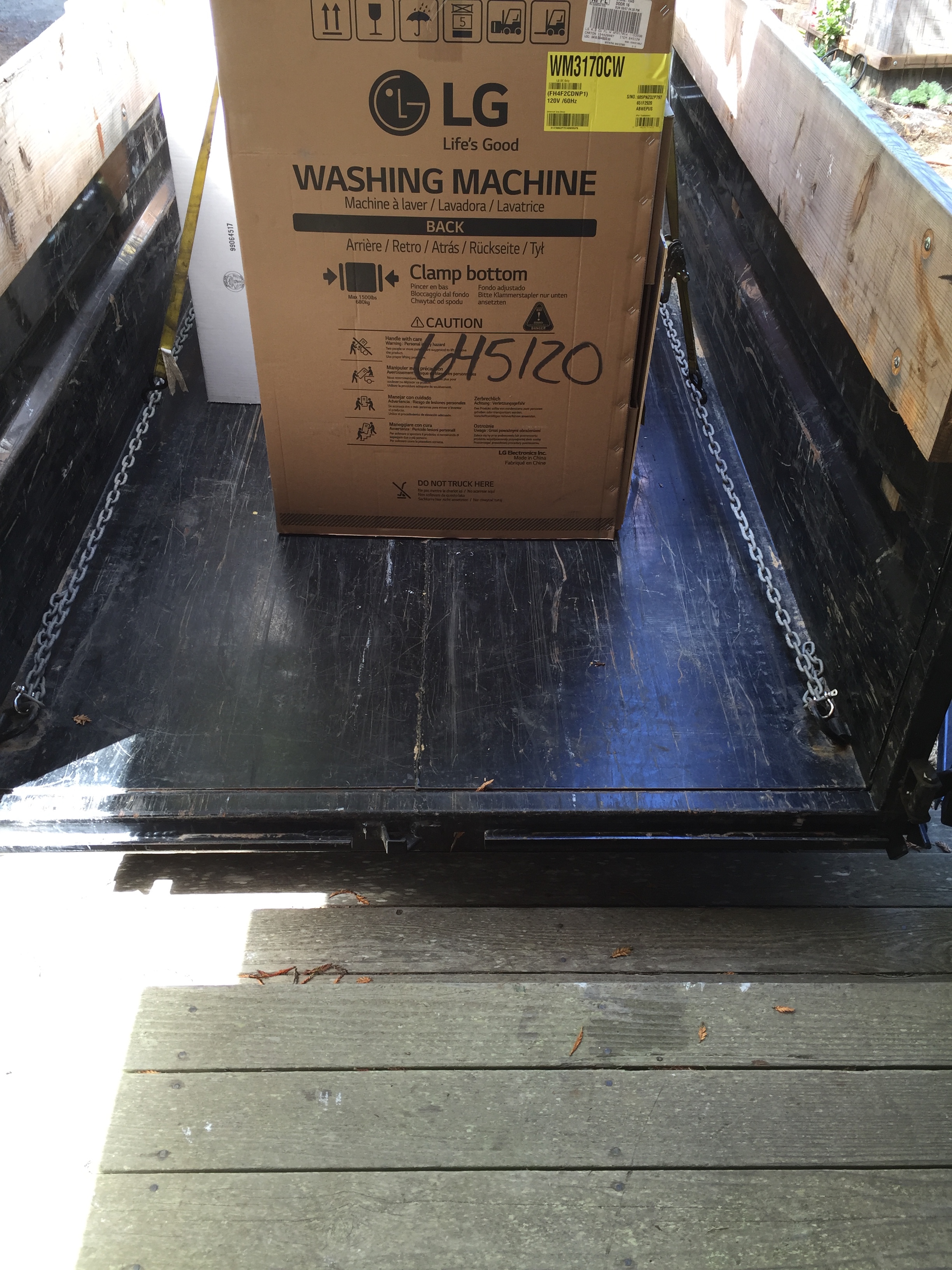

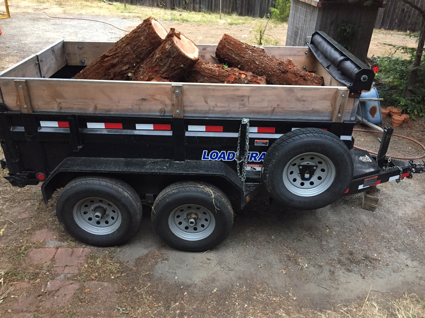

I got a 5x10 Loadtrail which is nearly identical to the PJ. It has the same charging system which works well. I also got the roll up tarp which is a great time saver. I added 2x12s on the sides for total of 36", my B21 can dump over the sides OK. I also added chains inside stretched from front to back, this allows for easy cargo tie down and does not interfere with dumping. I like the small footprint, it can fit anywhere and is easy to move around. I use it for many different chores it is much handier than I thought. My wife likes it too, I have made huge progress on landscaping and property clean up since getting it.
