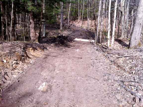

Was wondering if anyone has some advice on how to properly build retainer walls from boulders? Have a big clean up project behind my house which involves getting rid of a ton of rocks and boulders (to grow good grass) and looking for things to do with them.
If you can tell from the picture attached, that is a bridge that goes across a creek. You kind of walk down into it and I want to make the side walls a little higher and do boulder walls on each side and have the wall taper on both ends. Figured it would add a nice touch.
What is the proper way to do this?
Also wanted to ask while kind of on the same subject.... On the other side of the bridge is completely muddy and wet at all times other then middle of summer. Would dumping some of the smaller rock and gravel from the back area into that mud and ruts begin to build dryer terrain and more solid ground there?

There are a few good books on building walls and things out of stone mcraven is the author i have a few of. [ame=http://www.amazon.com/Building-Stone-Charles-McRaven/dp/0882665502]Amazon.com: Building with Stone (0037038005509): Charles McRaven: Books[/ame]
As for building this is what I like to do. Dig down a bit 12-16'' on a big free standing wall (two good faced wall), on a retaining wall(one good face) that hits the side of a bank I will sometimes do less digging, then I put in gravel and compact it. Then the fun starts you stack and haul stack and haul. You will have good days stacking and days when you need to stop and just haul stone. The less you think about it the better you will do.
this wall hits into the slope behind it, which means you can put your filler rocks just about anywhere and save the nice ones for the front and cap.
you can see how long it is, to keep the size the same run some masons twine and some stakes.
I will try to take some pics of how the wall looks now and how I set up the stakes.

I'd cut a drain for your wet area get the water away from your wall is going and yes fill with some small rock but put fabric down first,, also use fabric under and behind your wall...
The wife and I built one last year and are doing a bigger one this year,, I hope you have a have a hoe with a thumb,,

Thanks for the advice. No backhoe but have a front end loader.

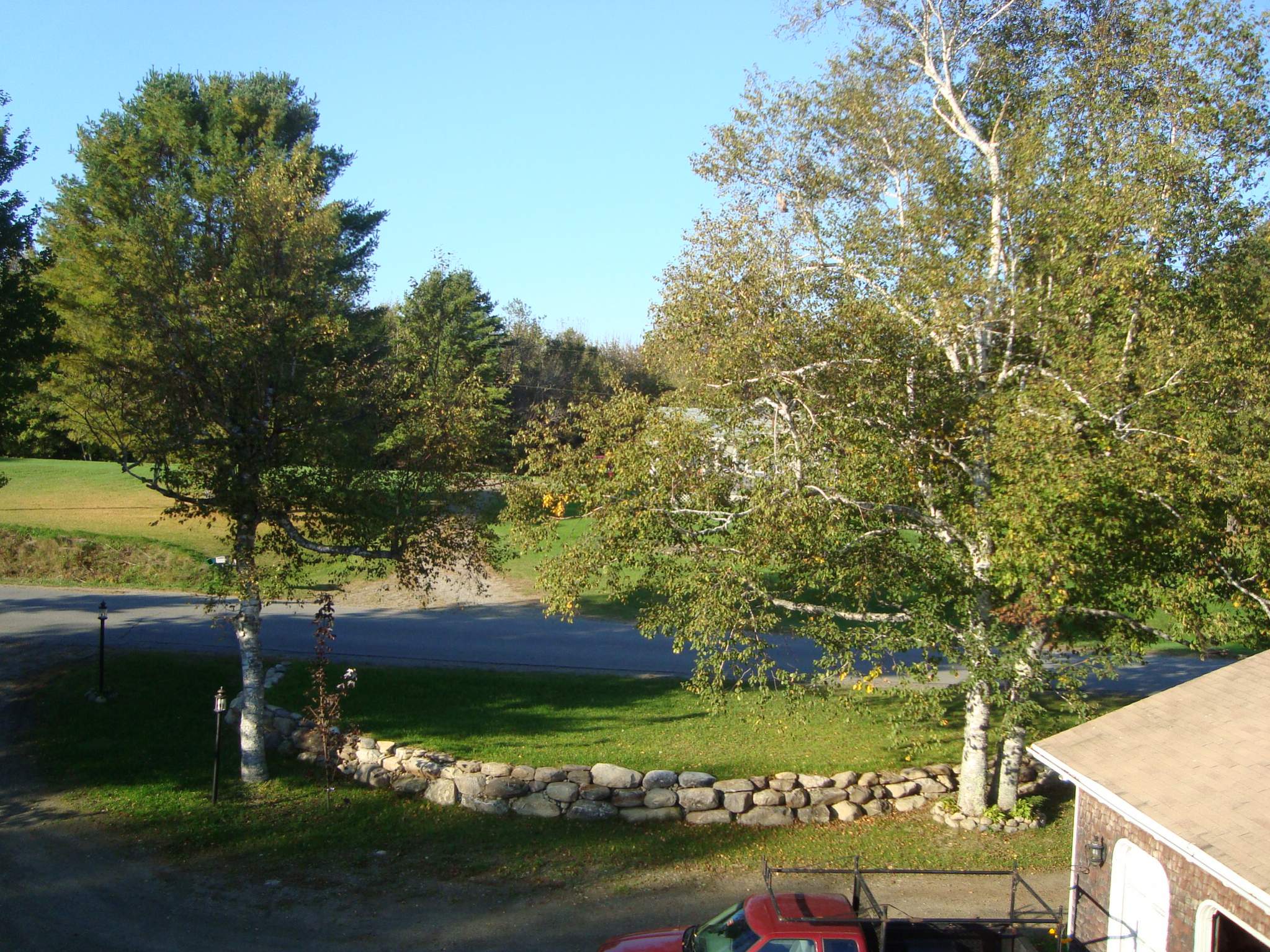

Here's a picture of one of my neighbor's stone walls. All round rock around here.

For round stone walls there is a ratio for strength - going up and going wide at the base.
Something like - 1.5:2. For every foot or foot and half you go up the width should be 2' wide. IE: 3' high = 4' wide at base. Also, contrary to popular believe - you put the big heavy stones on top. Gravity forces the weight down and locks everything in place.
