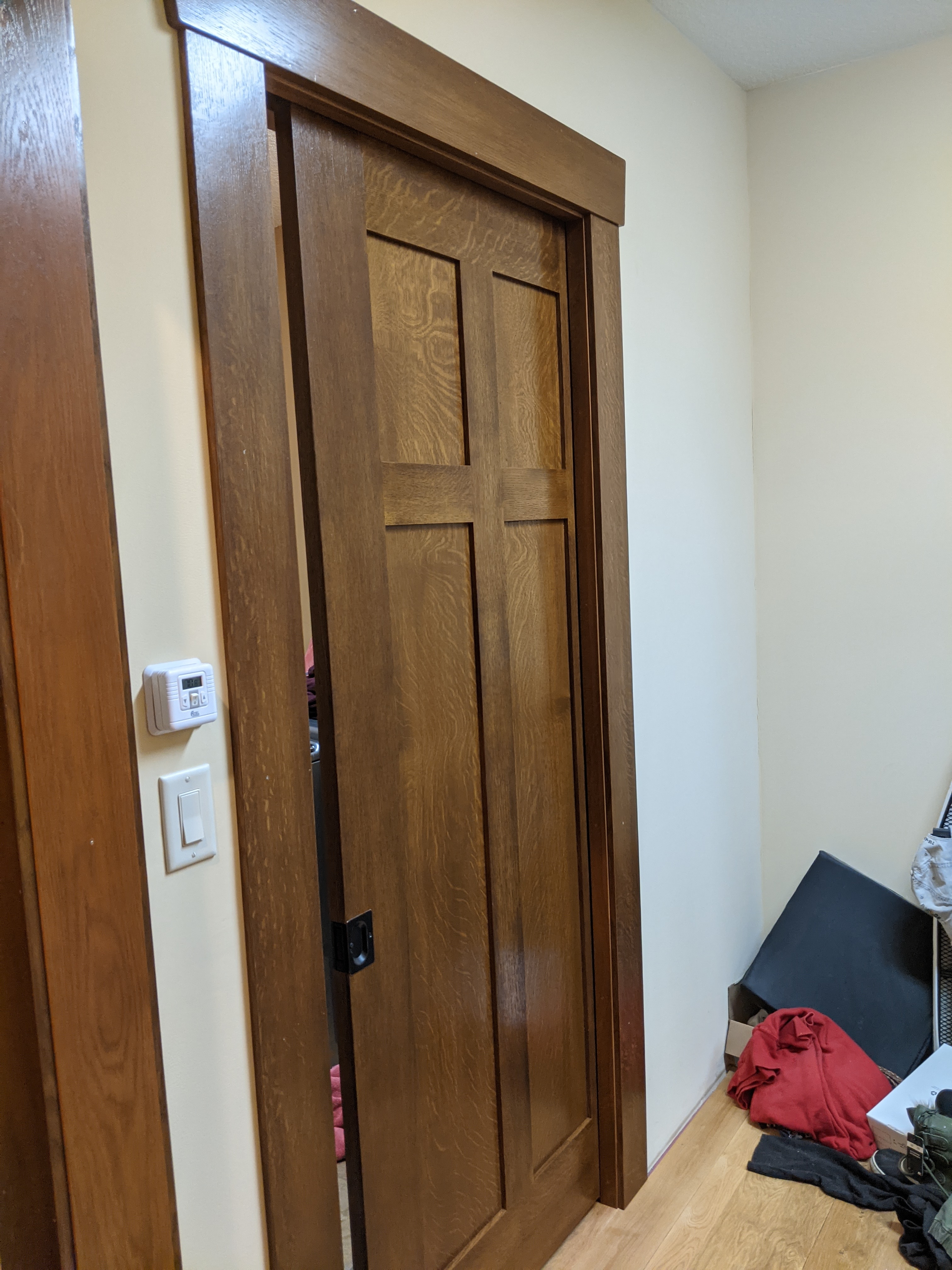

A bit more on the soft open/close that I did not state earlier. It does what it says, obviously, and makes it so you can't slam the door which is pretty significant on heavy pocket doors all by itself. But the other key advantage is that the mechanism also HOLDS the door in both positions (at least my higher end heavy duty Johnson hardware does). So if it is one nanometer out of level it won't drift open or closed by itself. And it is very hard to get them that perfectly dead level...and then the house can move/settle over time too.
I used the hardware on slider doors for 2 closets each with 2 doors that bypass slide that are 36" wide each and made from solid White Oak so are very heavy. The slider hardware is functionally the same as the pocket door hardware, just a different track style and no framing for the wall pocket. I also have one pocket door for the laundry room and that went in during framing, years ago. At the time Johnson did not have soft close hardware for that line so it is not soft open/close and you need to be very careful when you open it so it doesn't slam as a 36" wide white oak door is very heavy. The closets only were finished a year or two ago, so I was able to use the newer hardware with the soft close as that did not require anything special for framing. They do now make a retrofit kit so I could add it to the pocket door now, but it does require cutting a hole in the drywall which I never like as I can't make a decent drywall repair to save my life. Even still, I am considering it given what a PITA that door can be for slamming.

Thanks! There were 23 total doors (I count 2 for the double doors) and it took a few years to make them all in between many other tasks on the build. I made the first door in 2016, I think and finished the last one 2 years ago this month. Here is one of the double bypass sliders that used the soft close hardware. The one side is sitting slightly open with the closet light on. If you push it any farther from here the soft close mechanism takes over and pulls it shut.
