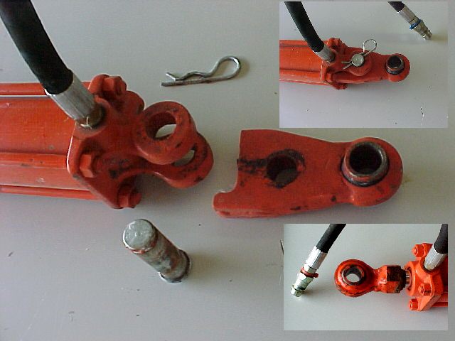

If you already have a hydraulic remote, and you have a welder a hydraulic top link is a pretty easy project.
Get a new cylinder, hoses, and QD fittings, and two swivel ends that have a CAT 1 top link size pin holes. Tractor Supply Co. I think the pin holes are 3/4".
Cut off the end of the rod and weld on a cat I top link swivel end.
The other end needs an adapter. A piece of steel that’s cut to fit into and is pined into the cylinder fixed end. I cut a 1/4" plywood template first, then transferred it to steel. Us a quality 1" hole saw for the pin bore if you can't afford or don't have access to a twist drill bit. Weld another swivel to the adapter.
Mine cost about $120 in materials. My first project.
Photo.
Jim Poux

cool what size cylinder did you use
   / box blade advice #14
KJN128,
I made a hydrualic top cylinder with a 2 1/2" tie rod cylinder.Around $65 for the cylinder,$30 hoses,$30 for set of 2 - 1/2" quick couplers.
I had a bent top link that I cut the ends off of and welded to the hydraulic cylinder.
