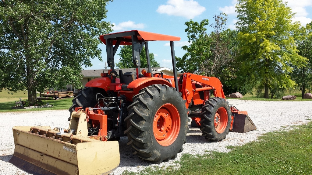

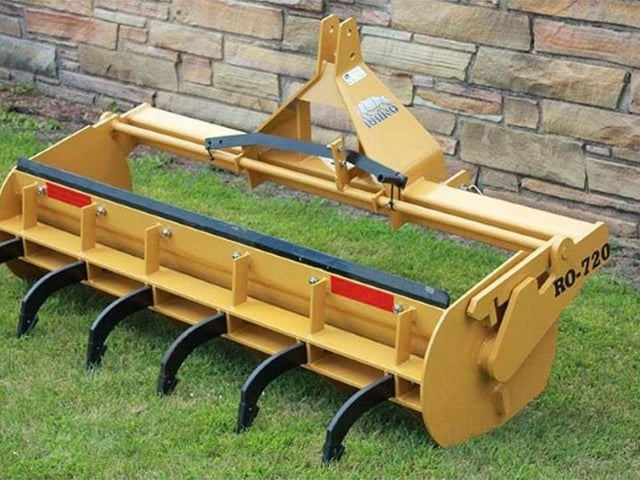

This is mine. A roll-over box blade. As such it's built like a tank. Since its a specialty item they are not cheap. I use mine to maintain trails where I can't turn around and this allows me to pull, push or drop the scarifiers.
You sure keep it looking nice!!!
