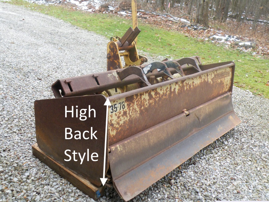

Also there there are two basic types, Standard and High Back:
If you have a big tractor you might like the High Back.
   / Box Blade alternatives to EA?
#18
Define "big"
I've got a Kioti CK4010. I assume that doesn't meet the definition of big?
