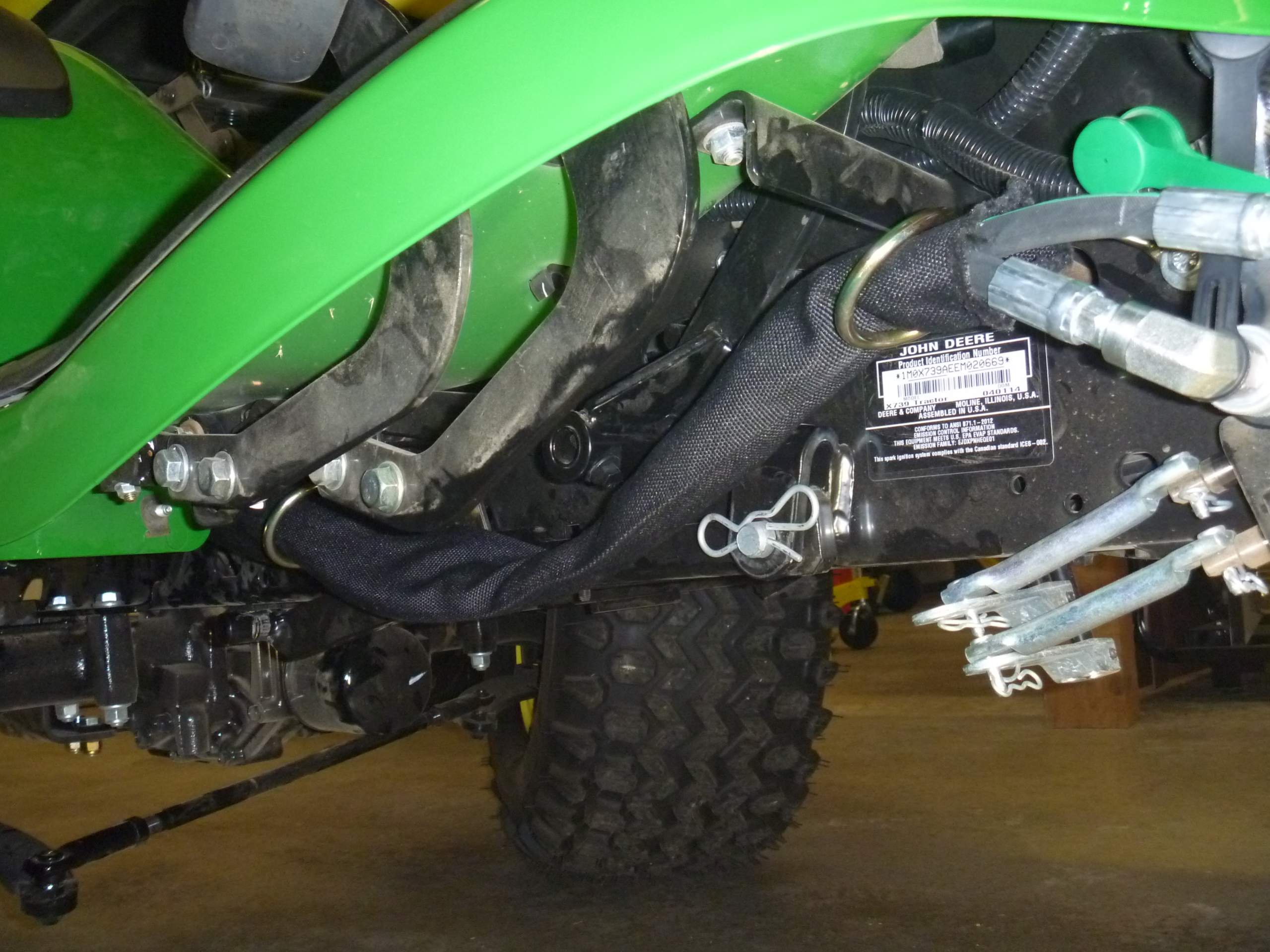

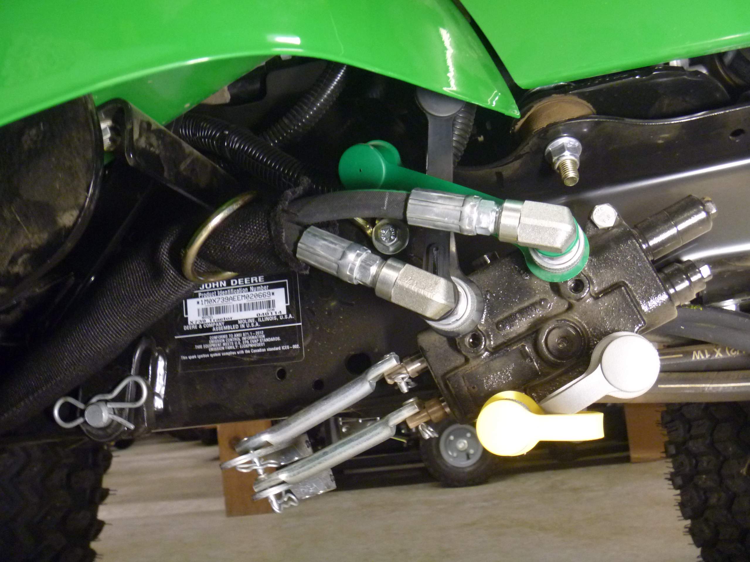

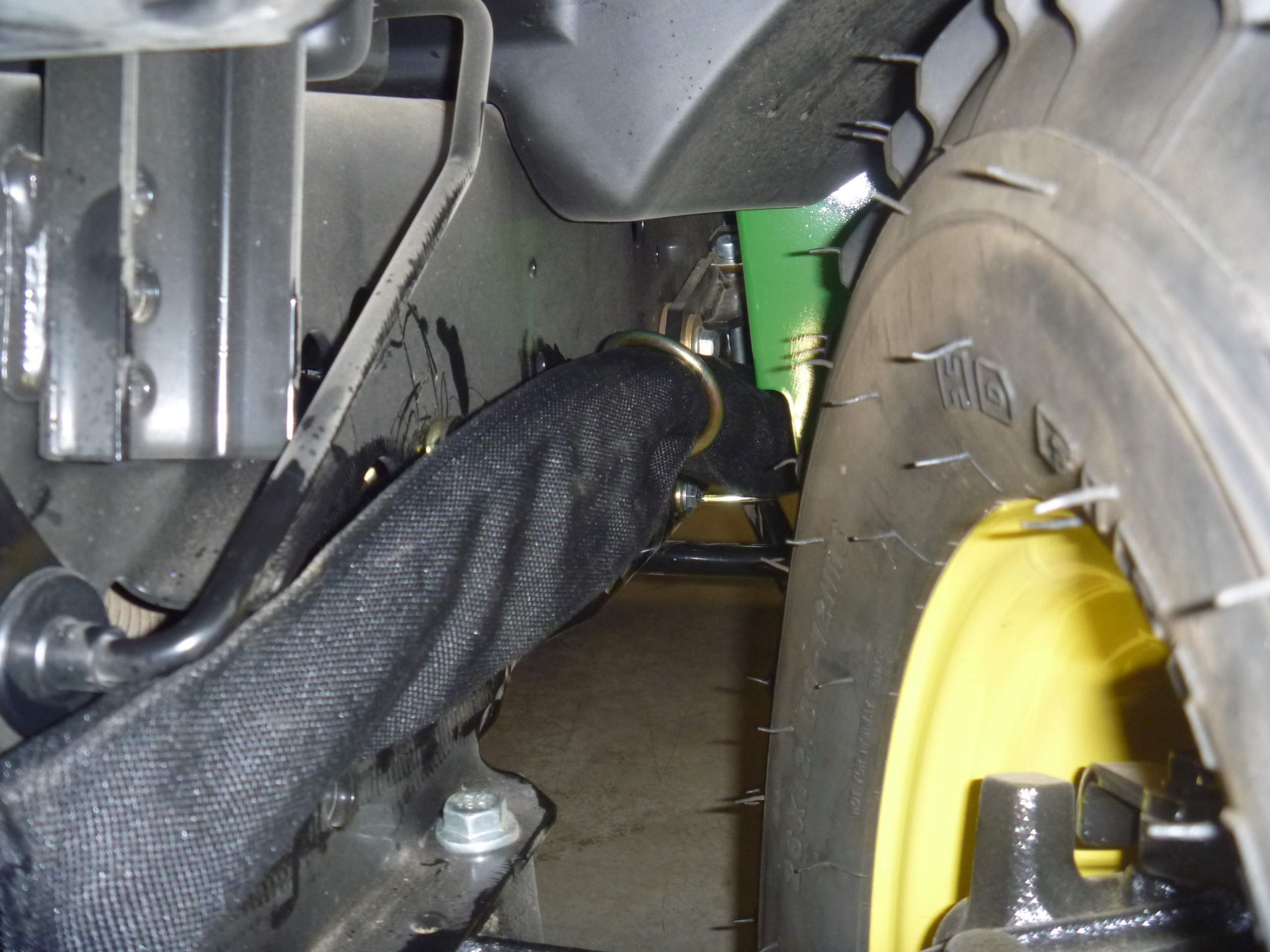

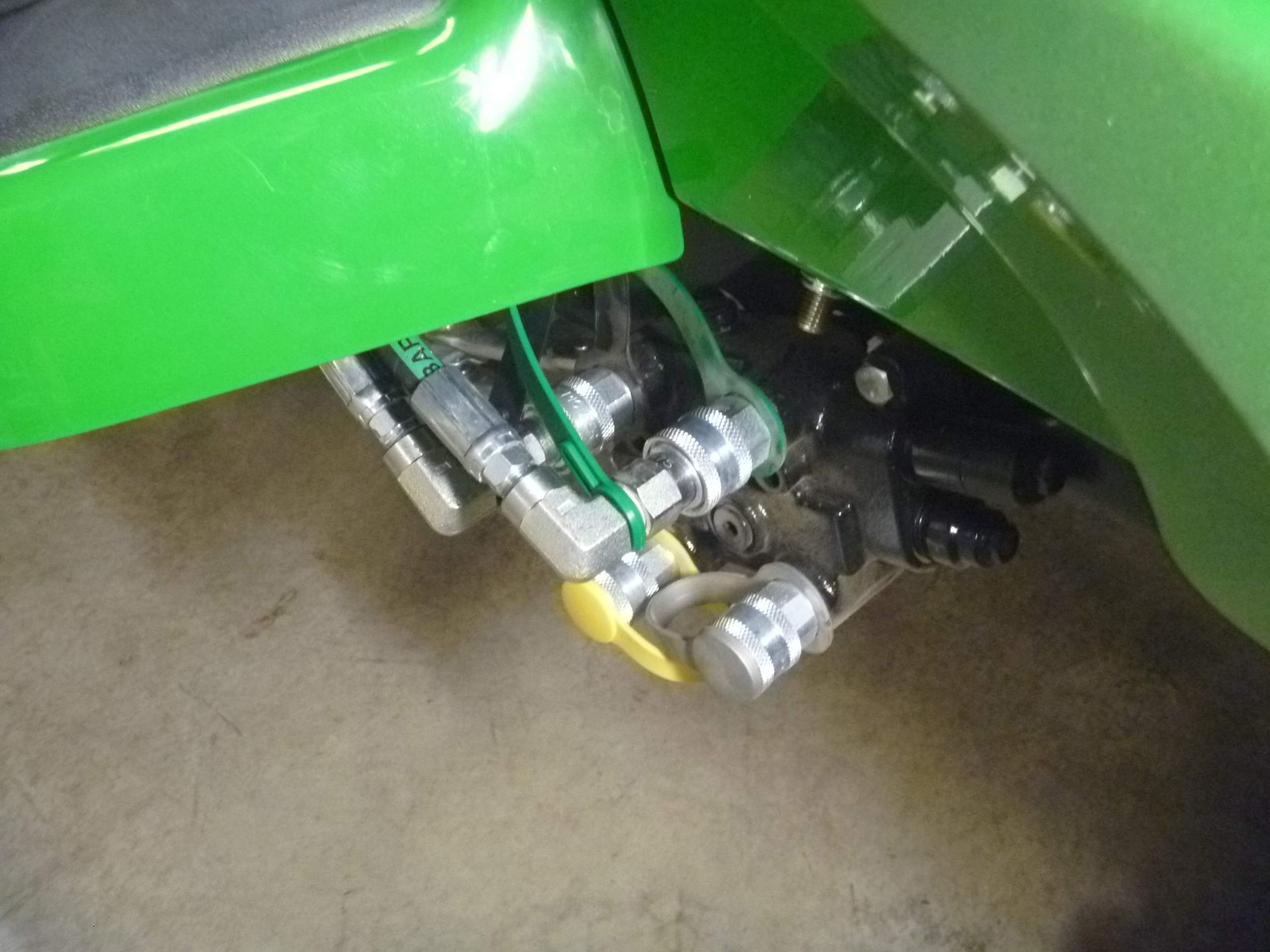

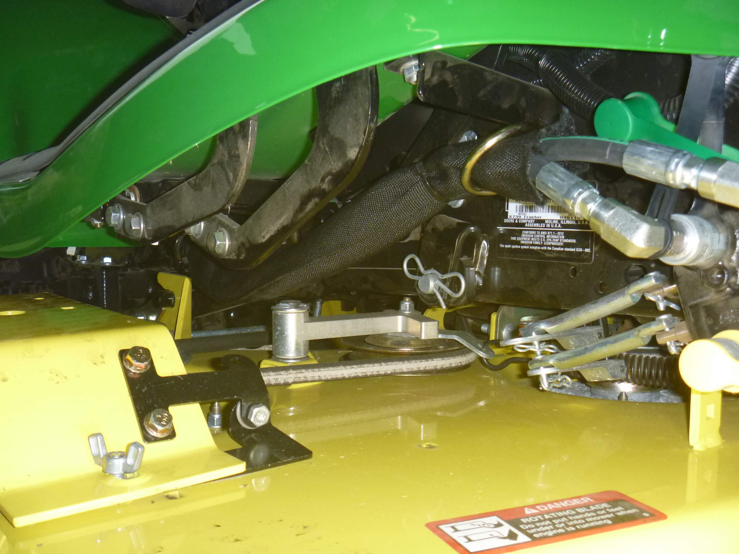

Installed the rear remotes today, the kit is very complete and fits the X739 well even though it was designed for the earlier 2 wheel steer models. Only needed to bend one hose hanger near the rear wheel to make sure I had plenty of clearance for the 4 wheel steering.
X739 hydraulics 018.jpg Rear couplers.
X739 hydraulics 022.jpg Plenty of hose clearance with rear wheel at full right lock, probably didn't even need to bend the hanger.
X739 hydraulics 010.jpg Hose routing and hangers.
X739 hydraulics 023.jpg Mower deck fully raised, no interference issues.
X739 hydraulics 006.jpgX739 hydraulics 007.jpg Front couplers.

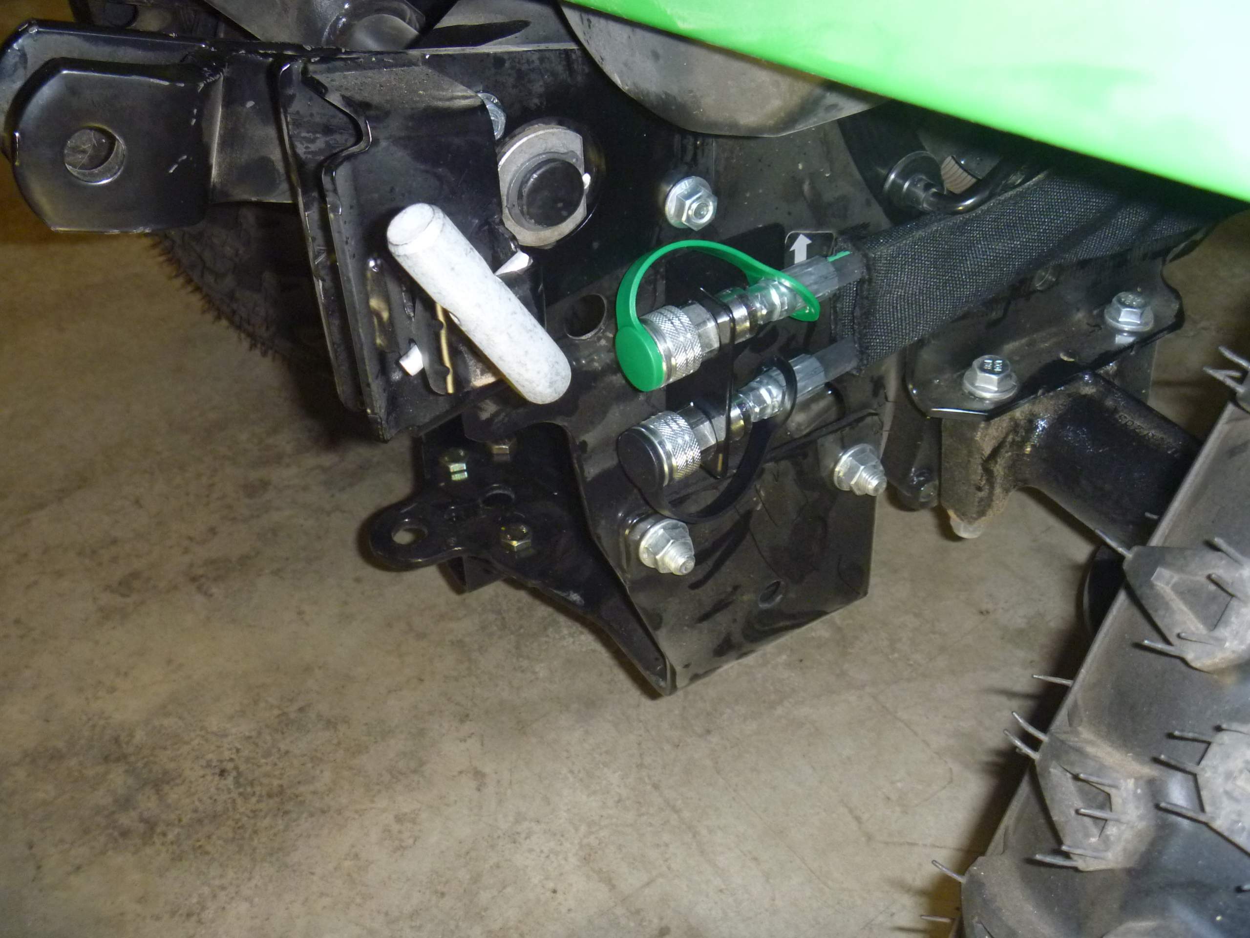

How accessible are the ports with the hitch on? The seem to be set back pretty far.
   / Box blade and hydraulic top link on X739?
#27
Just below and set back a little bit from the click N go bracket. Not as handy as yours but for the little use they will get they are fine. Plus its unlikely they will get banged by anything where they are.
