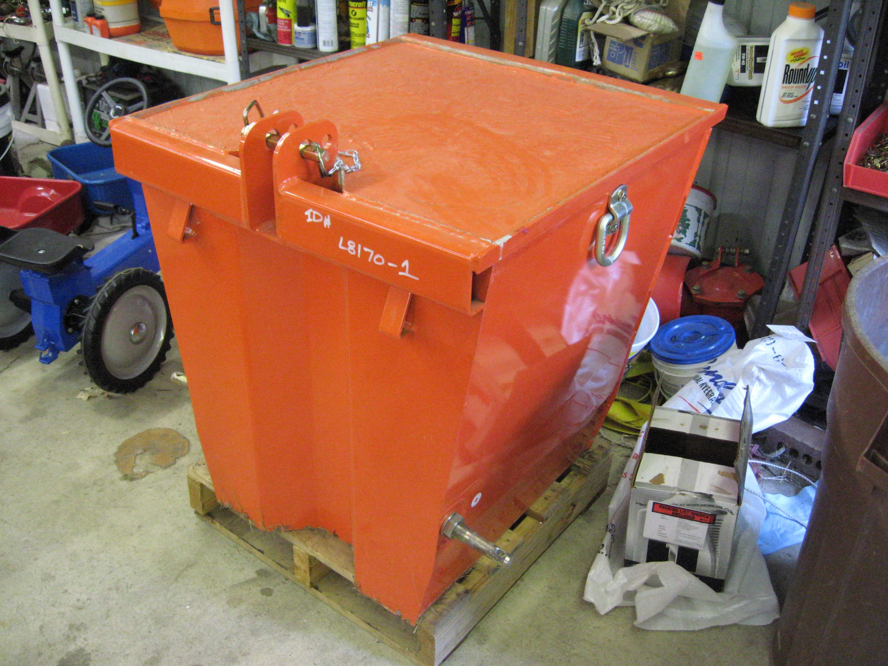

I will not fill my tires due to 75% of my work is finish mowing. This ballast box weighs 1250 pounds filled with cement. It stays all winter when I have my snow blade on. Nice and compact and heavy. Sometimes I use it for FEL work when I am close to maxing out bucket and there is no need for a rear implement. My other ballast is a 1150 pound 6' heavy duty box blade with hydraulic rippers, or a 925 pound pulverizer, depending on what the job requires. But, those wider and longer implements can get in the way if you are working in tight quarters, which has been my case at times. Philip.
