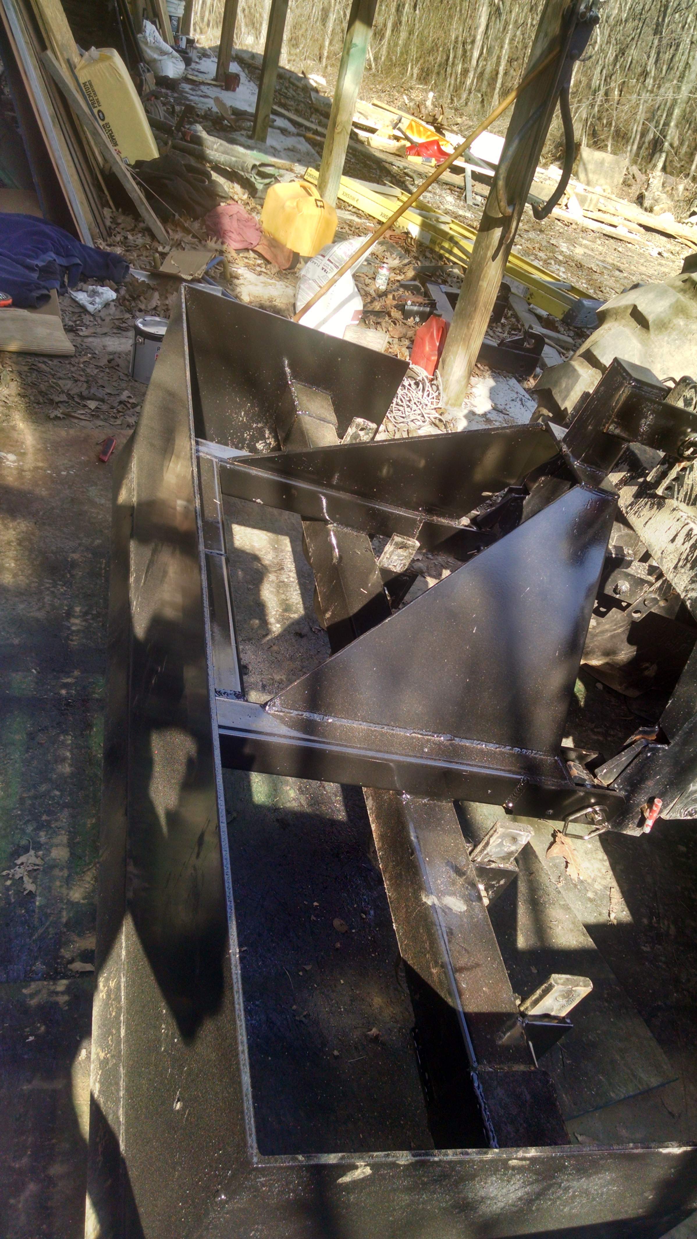

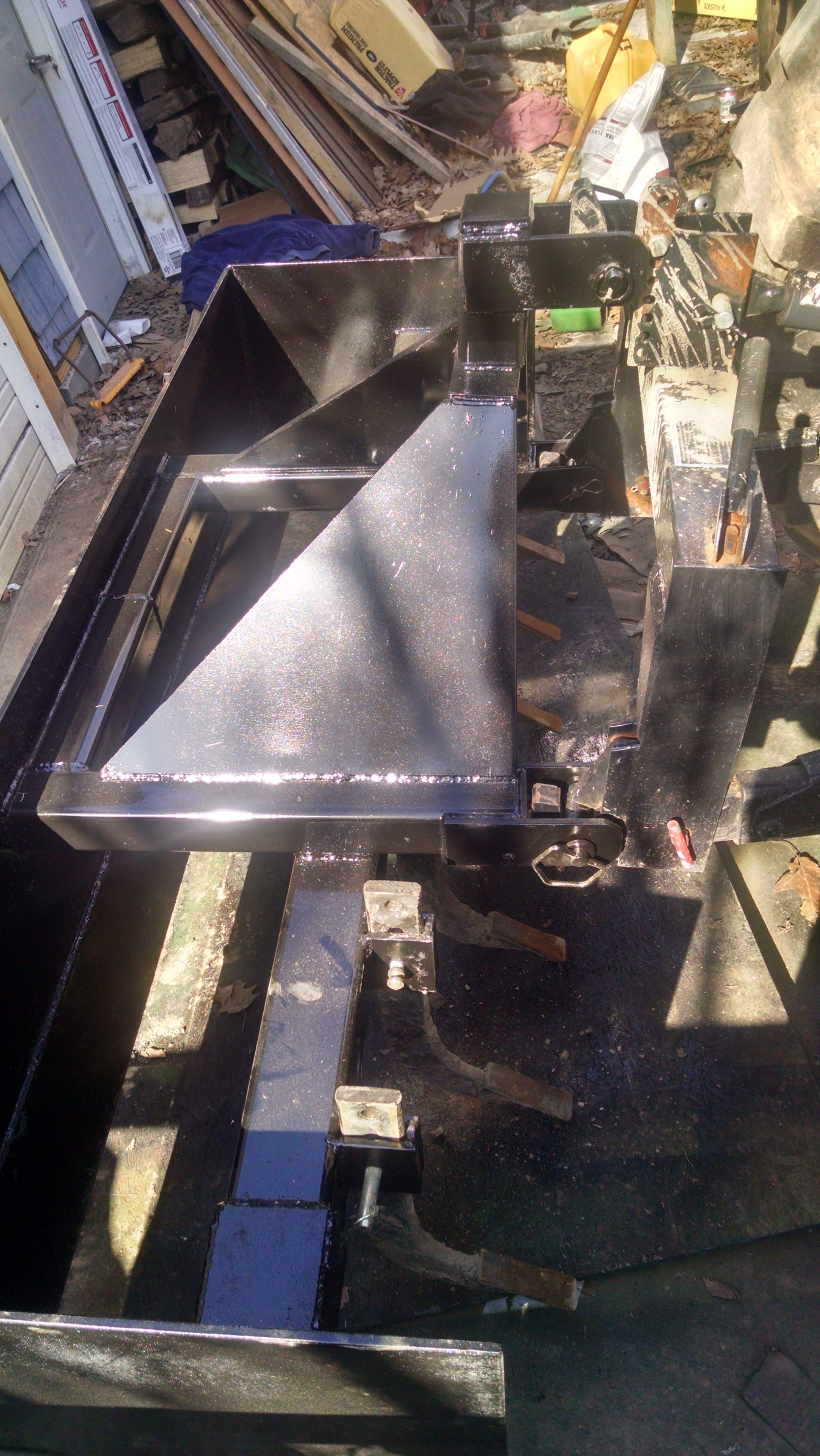

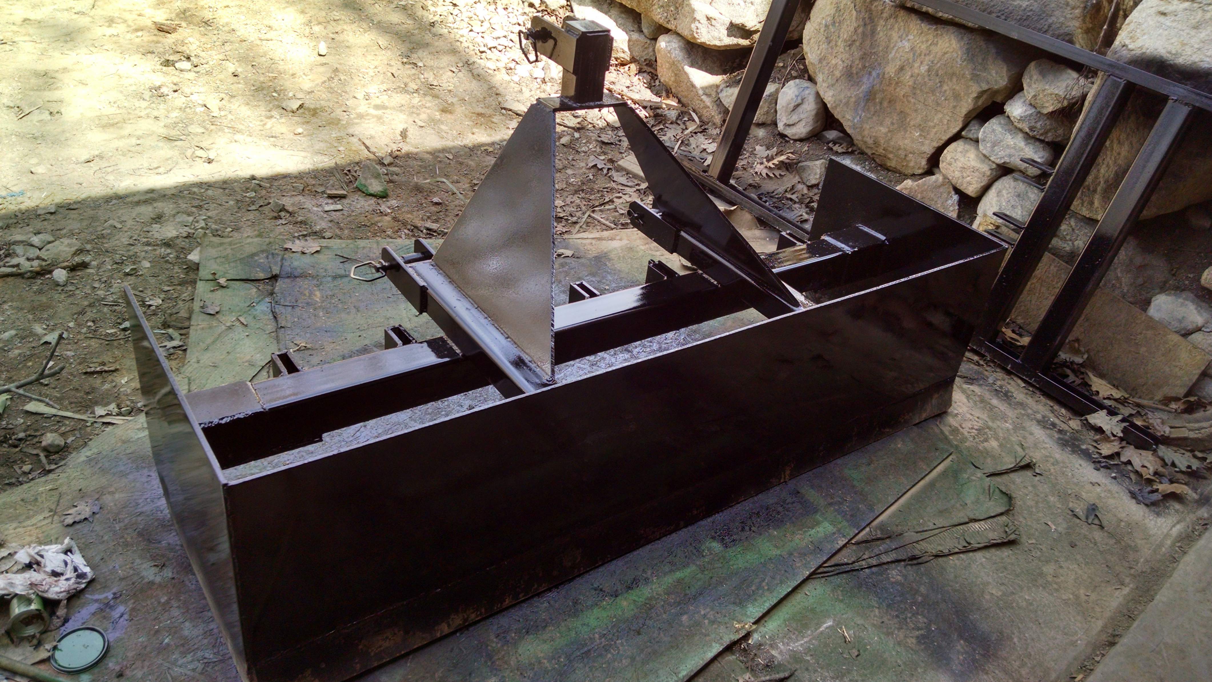

I wanted a box blade a little heavier than what I could get at tractor supply, and wasn't happy with the price on the heavy ones.

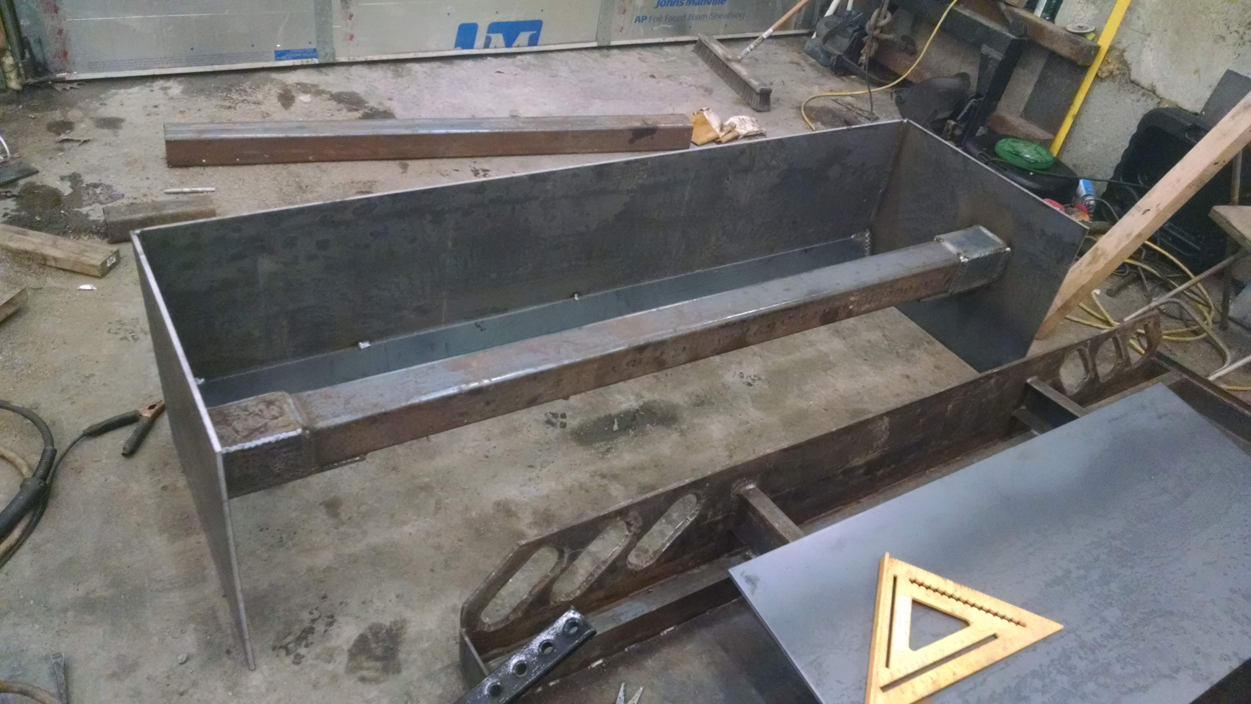

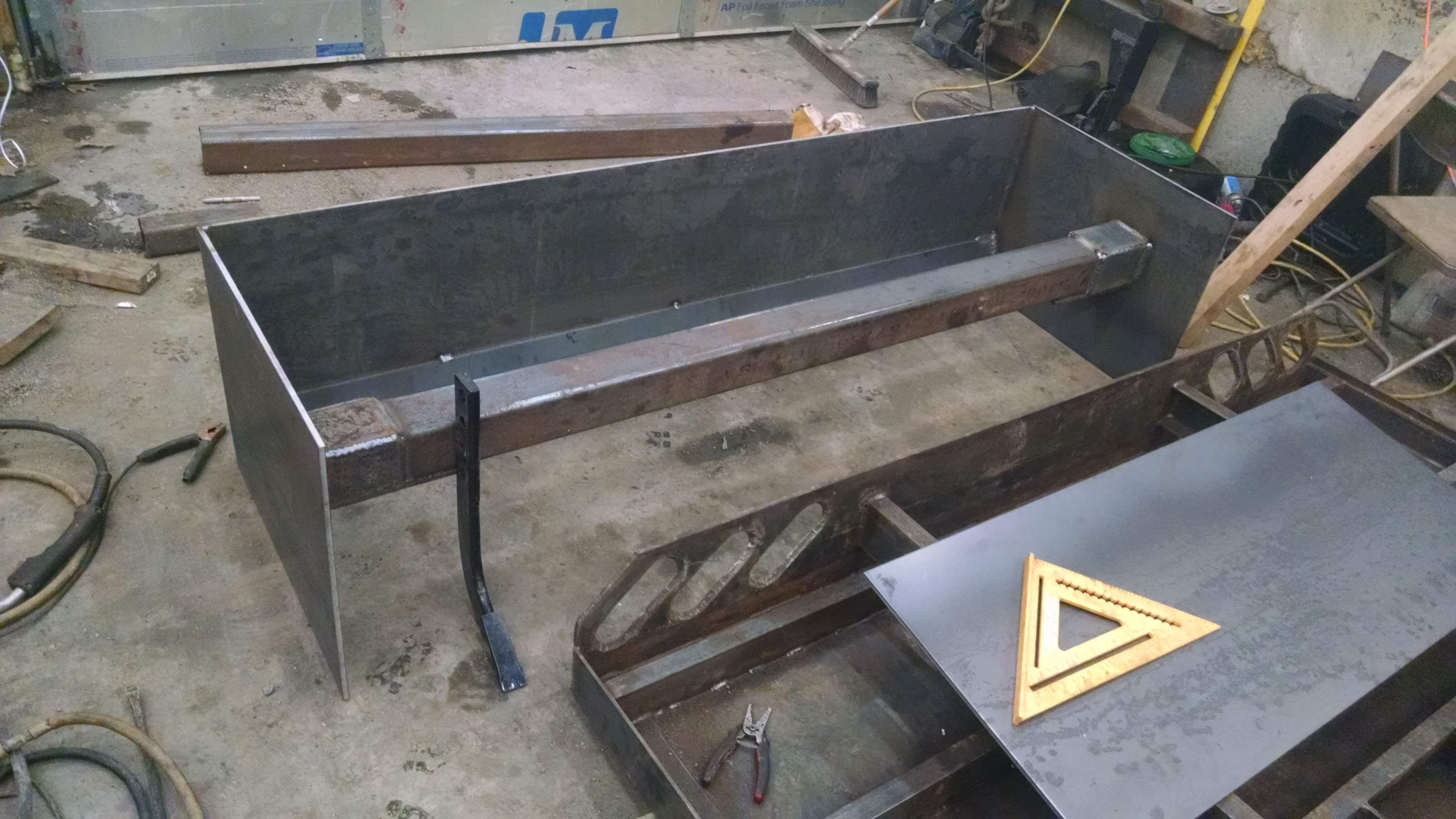

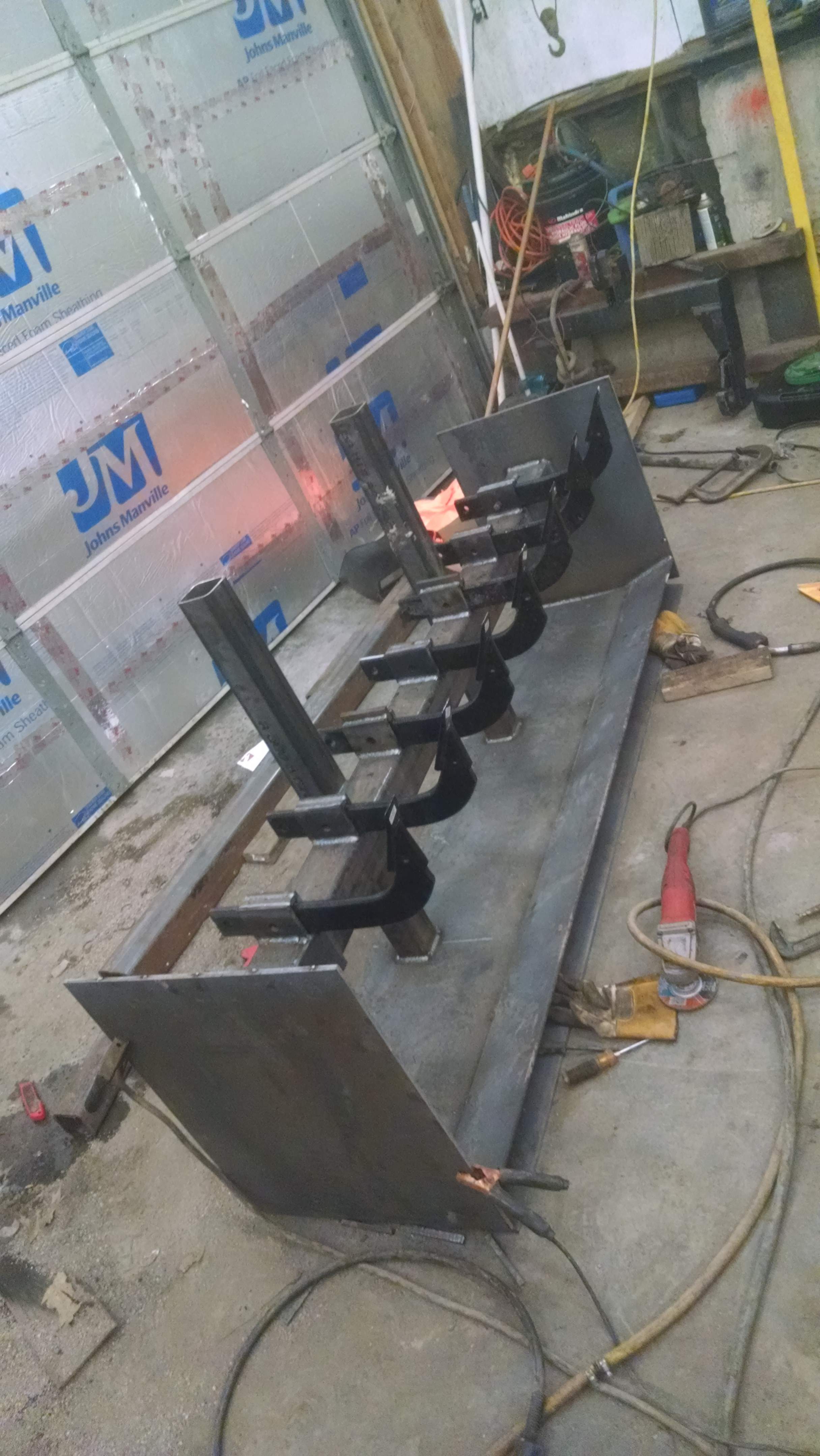

I used 3/8" mild steel for the box, and a piece of 4" by 1/4" wall box tubing for the crossbar.
It went together very quickly, I had all the parts sheared by my steel supplier.
$335 including tax for a 4x8 sheet cut to size.
It's 20" tall, 24" deep, and 76" wide
