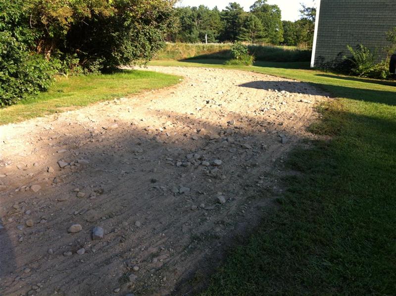

Hi All, newbie tractor and box blade operator here. I've been working on my 400' gravel driveway which has not seen any major maintenance in the last 10 years.
I have no problem ripping up the driveway with the scarifers, but find it brings a lot of undesirable 4-6" rocks to the surface. After I spread new gravel and angle the box blade to smooth things down, I find these rocks get caught in the blade edge and get dragged along the box blade path, leaving tracks and thus an unsmooth finish.
For my driveway I've been hand-raking out the large rocks and am happy with the results, but I'm about to do this all over again for my mother's 150' gravel driveway. I anticipate I'll have the same rock problems over there. Short of purchasing a landscape rake, I was wondering if there are any suggestions for dealing with these 4-6" rocks. Thanks!

Not naturally there. That picture was of a driveway extension that got put in 10 years ago and went in over an old barn yard. I remember the excavator bulldozed a few inches of top soil away and uncovered the cement posts of a barn that burned in 1950. He then put down new gravel, I think he said it was #4. When the contractor was done with all the work on the property, he smoothed down the entire length of the driveway. The originally driveway itself is 100 years or more old, and has seen new gravel and a culvert replaced over the years, just not regular maintenance.
My Mom's driveway was put in 33 years ago, but probably no new gravel in 20 years. Some of the top gravel has been scraped away by snow plow and the driveway can get muddy in spots. Her driveway is 150' long, after I rip it up with the scarifiers I plan to spread at least 18 tons of a one-inch reclaim gravel aggregate.

Why do you need to rip it up if you are going to put more gravel down? Try angling the box blade so you are just cutting the top inch or two of soil off, and keep the scarifiers up, this way you will just scrape the soil and leave the rocks. Then when the box blade fills with dirt you can spread a thin even layer to grade. You don't want to disturb the base if you don't need to.
This will only work if you have a good heavy box blade, otherwise it will just skim over the hard surface.

I had been putting the scarifiers all they way down to rip up and bury the grass and weeds growing in the gravel. I've tried different scarifier lengths, but all the way down does a better job against the weeds. My box blade is about 500lbs, its the 72" TSC King Kutter model.

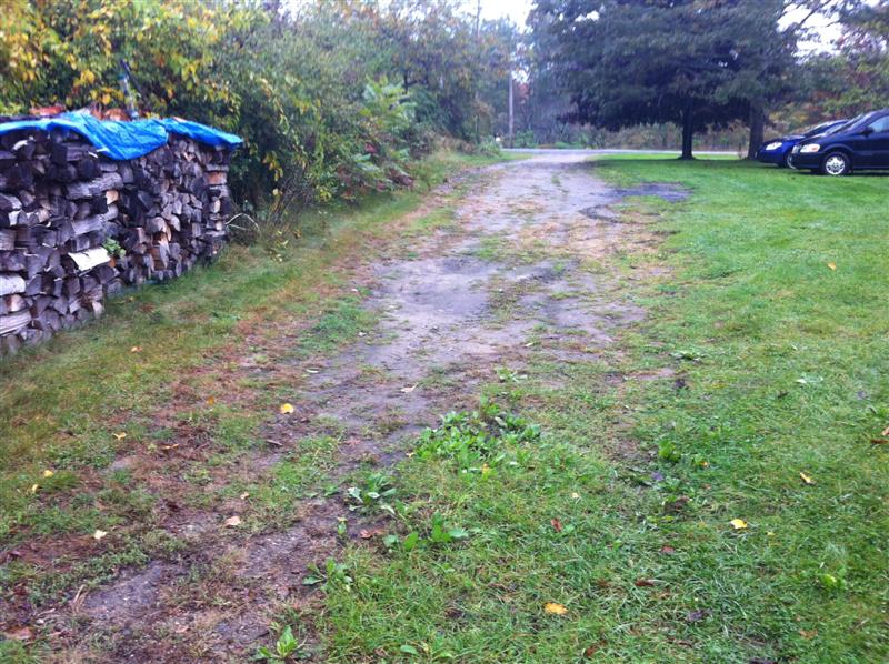

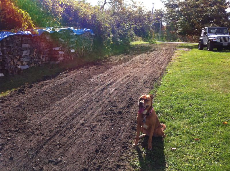

Update, I decided to rip up my Mom's existing driveway with the scarifiers and do a little hand raking. Yeah it was more hassle, but her driveway turned out not to be as rocky as mine. I did disturb several melon sized boulders, but too few I think to do any harm. By ripping up the old driveway, before spreading new gravel, it feels to me I'm doing a more complete job. I don't have any experience in this line of work to substantiate that perception, its just my personal opinion and it was bugging me.

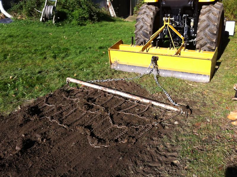

Here are some before and after pics. I hope to start spreading new crushed gravel on it in the next day or so. Also included is in the pics is a "harrow" I made from an old clothesline post and some old tire chains I found in the barn.
Now that I have the tractor and equipment, I plan to do annual maintenance on the driveways and not be as aggressive with the scarifiers.

With what I see in the pictures you posted I also would have dug it up at least a little. Around this area I have used "compaction" gravel (about 3/4" gravel) to great success in major repairs to old driveways. Then it takes minimal grading to maintain it I have found.

I like your dog, he appears smart enough to stay out of the mud.
If it were me reworking your mother's driveway I would have put down a 1 to 1 1/2" layer of 3/4" crushed stone, that is about it. No rippers because there was no need to. From all appearances there weren't any notable ruts or pot holes, just an old hardpacked driveway that needed some gravel on the top.
I think that now the weeds will be more plentiful than before as the amount of dirt on top has been increased. You will need more material now about 50% increase over what you could have gotten by with. For me having to spend an extra 50% on materials would cut my profit considerably.

From what I see in the pic of the tractor with box blade attached,the top link needs to be shortened. It looks like the BB is riding on the back edge and not the front edge. If so, then I can see why you were needing to use the scarifiers since the blade wasnt cutting in.
edit..after looking at the pics closer, I can see where you drug the BB into the edge of the grass and it wasnt cutting at all....just gliding over the surface. Adjust /shorten the top link for a more aggressive cut when needed. Lengthen the top link for a more smoothing action. You will find a sweet spot in the middle,where it will only cut in lightly and you can then skim the surface easier .

Really it looks like you are using the blade because you have it, but not because its needed. I find it a lot easier to control grass/weeds on the drive with herbicide rather than iron.
If the drive is properly crowned, and doesn't have pot holes/ruts that you are trying to remove, you are probably going to do more harm than good by reworking it with the box blade.
mom's drive looks like it still has a lot of soil in your 'base'. As long as you've got soil in there, weeds are going to grow vigorously. You would probably be better served by removing a few inches of that material and putting in 3-6" of new gravel, with fines. That kind of gravel packs very tightly and helps exclude weeds.
