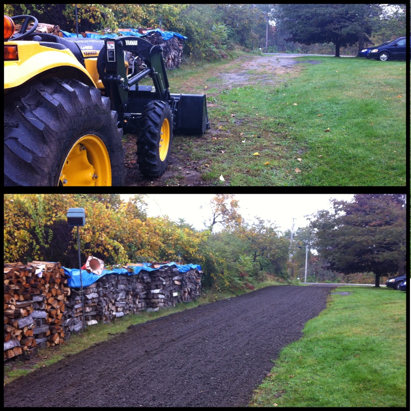

Thanks for the comments guys! Steve, I like your work!. My wife and I have talked about putting crushed rock over the recycled material after it firms up. I think we'll wait and see how this stuff holds up to winter and decided then. One problem around here with crushed rock is it winds up in the lawn once the snow banks from the snow plow melts.
Here's a before and after picture at Mom's house, I spread the recycled material two days ago. 18 tons of material delivered in one pile and all was spread 150 feet with the box blade--I didn't use the loader at all. I think the material is fine enough and thick enough to keep most of the weeds at bay. Cost was $190 for the 18 tons. Mom is happy, I paid for the material and did the work as an early birthday present. :)
One note about the material color, its very dark because its wet. We've had lousy weather this week in Maine, but the plants needed it. Oh yeah, my crazy 66-year-old Mom stacked all that firewood herself, and there's about 3 cords you don't see in the picture!

Katahdin,
That looks alot better.
If this new material sticks together then I recommend you rake the edges asap. Hard to know how this will hold up to a snow plow. About the gravel left in the grass here's a tool to deal with that. Don't know if it works or not and I haven't seen or used one either but I have donsidered building something similar just for kicks.
