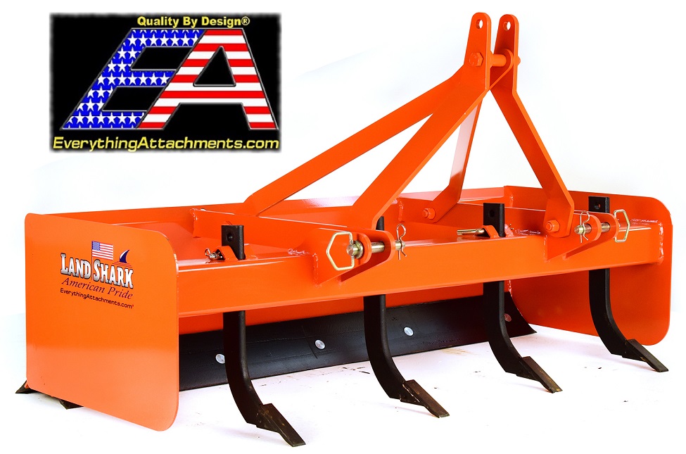

I am looking for a 48" box blade for my BX2230. I have lots of nasty clay. Can anyone tell me what the difference between these two King Kutter blades is? The orange one is a BB-48-XB for $549, and the yellow is a BB-48 for $599. Both are more than I want to spend, but finding a used one has been impossible. Thanks for any suggestions.

The orange unit has 3 rippers, the yellow unit has 4 rippers and clevis type hitch. The yellow unit is much stronger at the hitch.

The XB series has a Cat 0 hitch, or a narrower than standard Cat 1 hitch measurement, to fit some of the early sub-compact tractors.

Have you tried Land Pride from dealer? I have a LP BB1248 weighs 316 lbs. I haven't hurt it yet. 3 years ago $500.
Looks like the orange xb has 3 shanks not adjustable but flips up, 295 lbs. 12in. self-cleaning moldboard, Category 1 subcompact tractor hitch with Category 0 spacing
The yellow has 4 adjustable shanks, 377 lbs, 20in. specially formed self-cleaning moldboard, Category 1
For $50 I would go yellow if my machine could handle it.

The XB has a shorter moldboard. You'll get greater lift height with the XB vs the other

I ended up calling direct to King Kutter Corp. He (Lonnie) told me the XB was designed for sub compact tractors . Years ago one of the company "higher ups" had a BX when they first came out and they designed this XB units specifically for these tractors - he said XB is BX reversed and that was intentional, as well as the matching orange paint. Apparently the XB models are made for an easier hook up due to height and weight limits of the smaller sub compacts like the BX. Interesting conversation we had. Thanks
