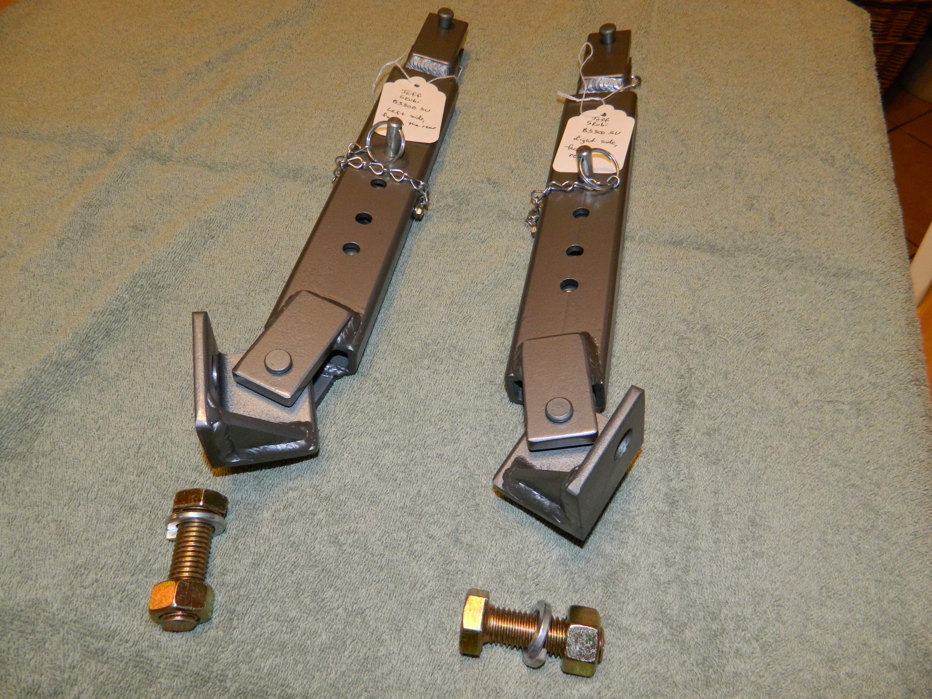

For a box blade to work well in most conditions, it really needs to weigh around 125lbs per foot width at the minimum. Your L3800 would do well with a box blade that is 66" in width IMO. I highly recommend one of these, they are a good fit for your tractor.
MtnViewRanch is the TBN Guru on box blades. I pay attention when he writes.

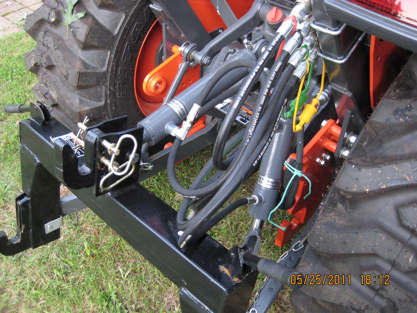

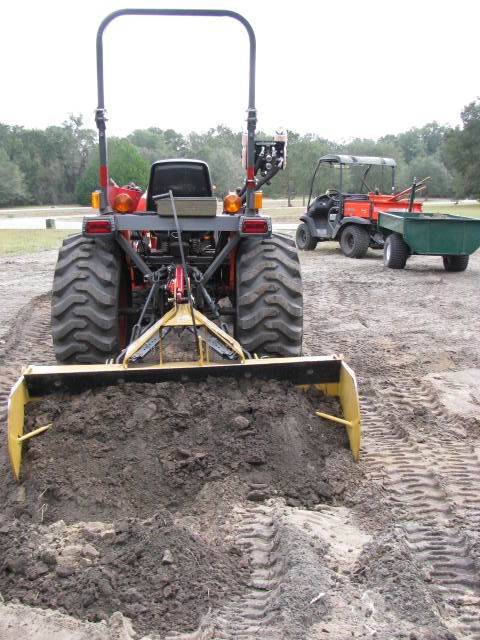

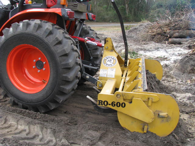

I pull a 60" Bush Hog (brand), 630 pound Rollover Box Blade behind my Kubota B3300SU/33-hp/1,900pounds, with satisfaction. My rear R4 tires are 59" wide. It has been often claimed on T-B-N that Dirt Dog produces the ROBBs that are branded Bush Hog.

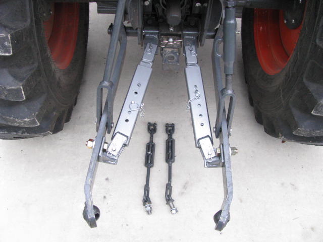

In my B3300SU Operator's Manual, under Implement Limitations, Kubota recommends 500 pounds max. box blade but I pull the 630 pounder without problem in Florida sandy-loam. I have aftermarket Stabilworks rigid, pin-adjustable stabilizers, which I substituted for factory check chains, which do not provide enough support when PUSHING dirt with the ROBB. I learned this when I bent factory check chains PUSHING dirt the first time.
I rarely use the rippers in my relatively soft, rock free soil.
I use a $250 HydrauLink air/hydraulic self-contained Top Link when pulling the box blade. Makes blade angle adjustments possible from tractor seat and HydraLink absorbs shock between the ROBB and tractor.
Photos #1 + #2 show the ROBB PUSHING dirt.
