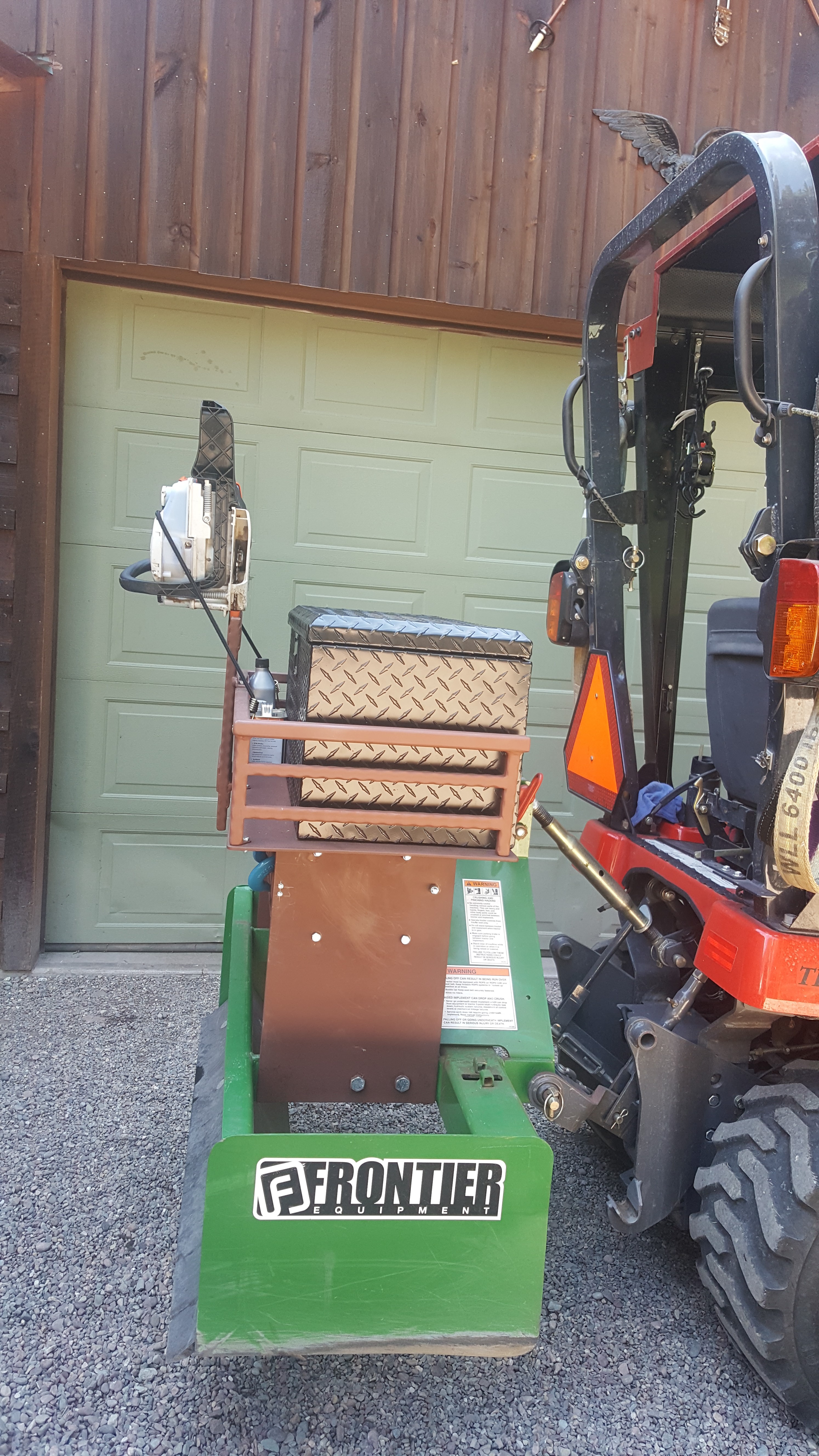

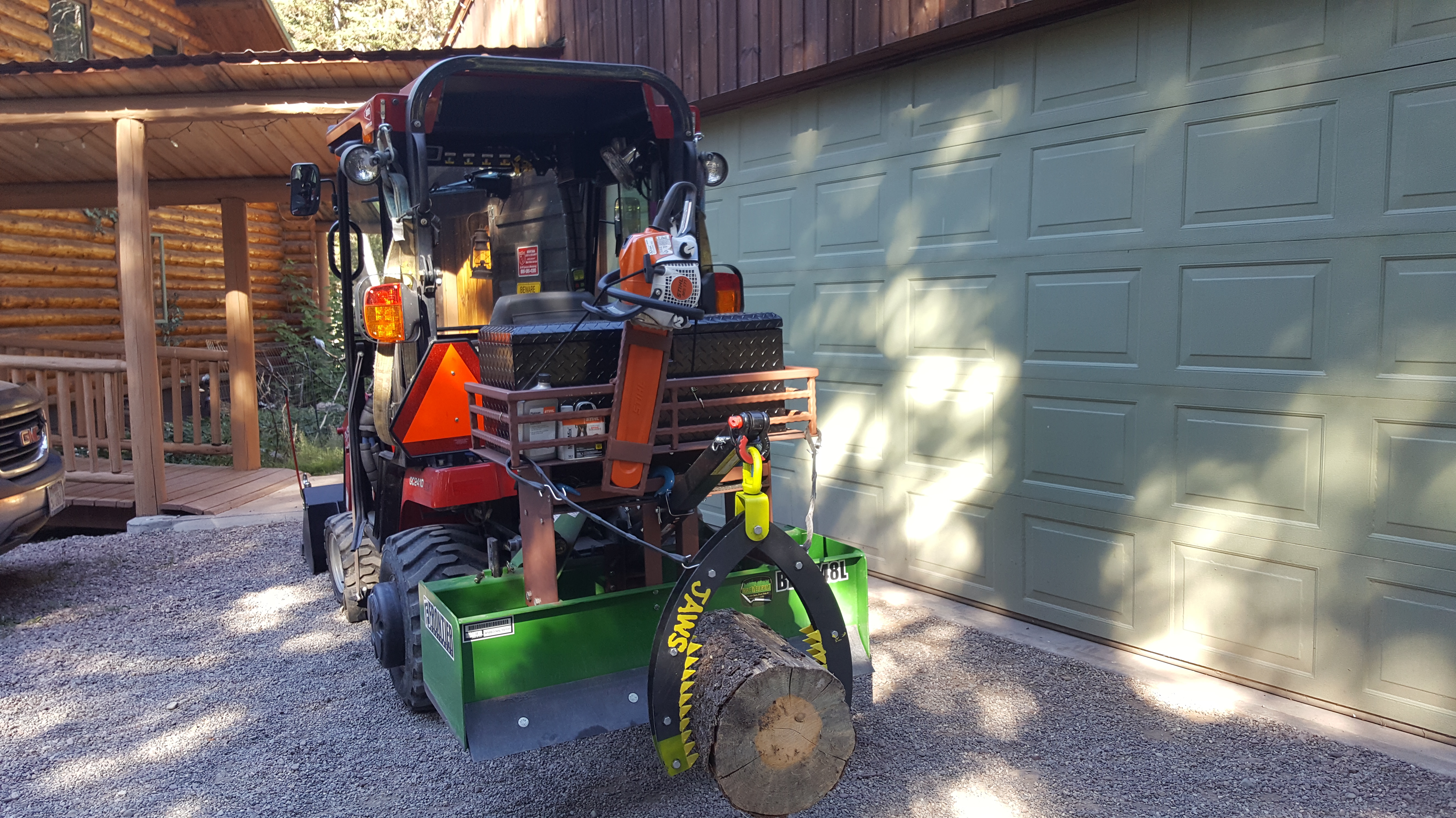

I have a Frontier Box Blade (BB2048L, weight is 275#) and the problem I've always had when using it to spread road mix for the driveway is:
On my MF GC2410 the Cat. I, 3 point hitch, only floats when the box blade is lowered all the way and does not provide for any down force for spreading of the road mix.
Last year I purchase an ATV storage box (36" x 15" x 15") and added 1/4" plate platform for two reasons:
1). I desired to have my chainsaw, fuel, bar oil, extra parts, safety gear, chains & straps with shackles, and "JAWS", with me while using the tractor on the property for convenience.
2). I also desired this extra weight on top of the box blade for better performance while using it.
I think I have added about 250 - ??? pounds on top of my box blade and I am very satisfied with the added weight.
I have used it like this for my neighbors driveway spreading about 40 - 50 cubic yards of road mix and the results were a better job in about half the time.
Here are a few pics of my addition to my box blade:

Thank you. Based on your experience, it sounds like I'd be better off with the heavier unit. I don't know much about my 3-point hitch...but I would assume it is the same as your and would float.
