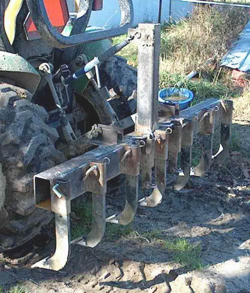

Hey Huckster.......
I lifted this photo off of this forum several months ago. I can't remember who posted it, whoever did, my regards and respect....at least enough to save a copy of it.
This ripper looks pretty aggressive.

Thats exactly what I am looking for. I am going to give the local land pride dealer a call and see if they have one in stock. Do you guys think that it will do a better job than a set of discs on a mostly clay based soil?

I have one of the land pride ones (i see someone beat me to posting it)
it will go down 3 to 6 inches in SERIOUS hardpack (like a driveway), put some weight on it and it will go down all the way (10 to 12inches).
It can stop my 33hp 4wd tractor dead if it's real packed, (just raise it up and hit again from another layer) and deep. Brings up BIG rocks. I go real slow and just let it work.
breaks up the compaction layer without really disturbing the top too much. (you can also add the York rake behind it to smooth things out again)
I use mine in preperation for tilling.
not sure why you want it for a motocross track.

There is other companies that make them. Check around a bit as you may find a better price.
