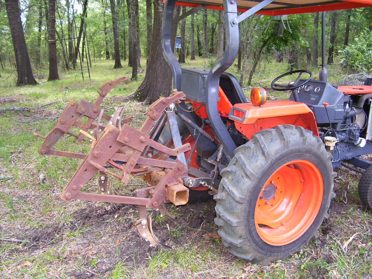

I made one to, ain't pretty but it's all I can pull. The things on top are being used as weights. But in reality they are upside down....they are a cultivating plow. The sweeping plows mount on top (top in the picture) and the little L shaped bracket normally holds the guide wheel(it'll lift the plow if a bump is hit).
I scrounged these parts from my uncles scrap pile. I can also remove the scarf and put on a middle buster, etc.
