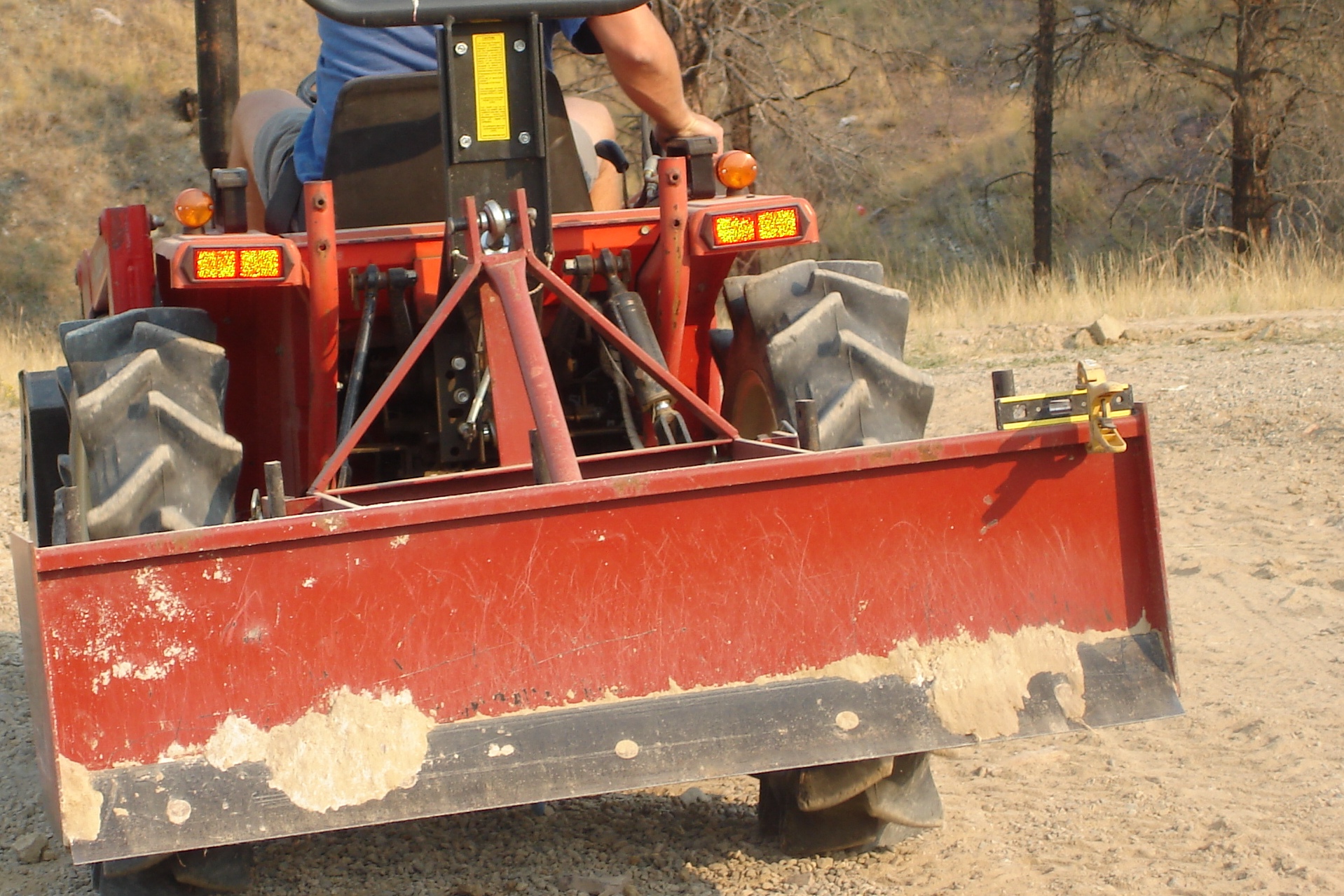

Has anyone used any type of levelling meter (tilt meter) on their box blades when grading? I was thinking of a means of trying to keep the blade level when the tractor is not to make a level grade. This would be done through a top 'n' tilt type set-up. I was trying to think of how to do this. One idea was to get a clear tube, fill it with colored water, and use it like a traditional carpenter's type level. Then I started thinking about the possibility of using a tilt meter like everyone uses here to check the tilt of their tractors. I though that would be a good idea. Then if you wanted to put, say a 10% crown on a road you would have a way to measure it precisely and set the angle on your box blade appropriately. Of course, right now I don't have a box blade, top 'n' tilt, or a level.:( Just kinda thinking ahead. I did a quick search and couldn't find anything definate. I was just wondering if anyone has done anything like this or has any thoughts.

I have found in grading residential home pads that a level, The type you can buy a Camping World, to mount on the front of a 5th wheel. I mounted this on the top of the BB. This helps me get the pad level quicker. If the pad has a slope, I can set the BB level with the tilt cylinder. As for as the top cylinder goes you can just watch your cutting edge and adjust accordingly.
/ Box Blade Level Meter? #6
I just slapped a cheap magnet torpedo level on my box blade. $2.99 at Ace Hardware and it works great.
/ Box Blade Level Meter? #7
Here is a picture . . .
