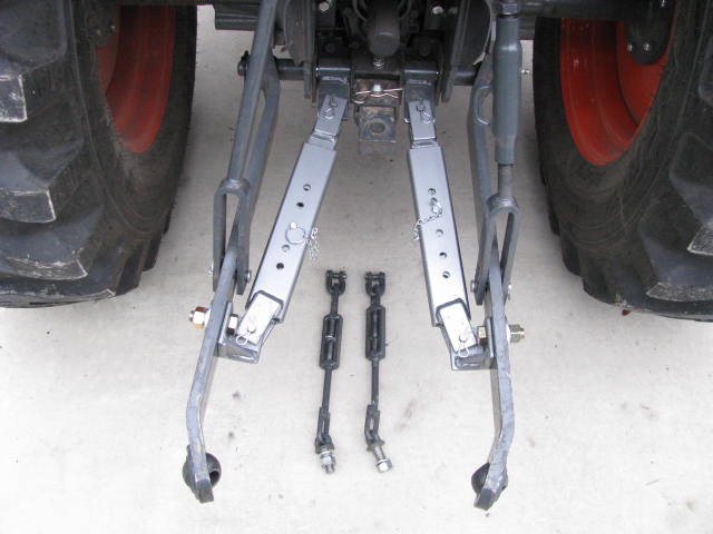

If you have RIGID STABILIZERS for your Lower Links you can push "a little" with prudence, as snug adjusted, rigid stabilizers provide some Lower Link support in reverse.
With CHECK CHAIN STABILIZERS for your Lower Links you have zero support for your Lower Links in reverse. PUSHING you can deform check chain stabilizers easily. You can surely guess how I found out.
Photo #3 - Bent, three-pound Check Chain Stabilizers replaced with fourteen-pound Rigid Stabilizers; Kubota B3300SU.

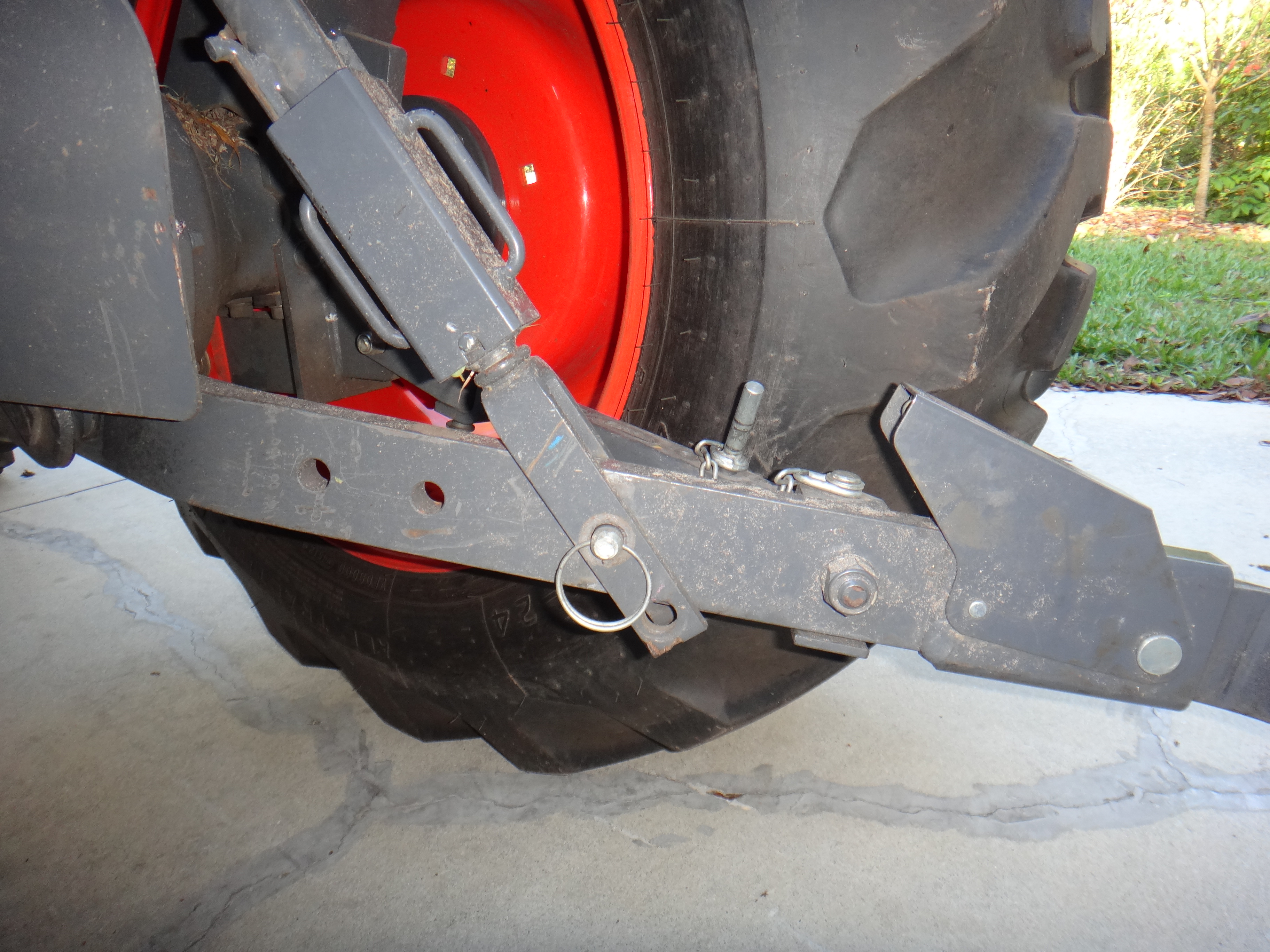

When pulling down hill with a Box Blade this 3-Pt. adjustment may be helpful:
The solution is to move the adjustment pins for the Three Point Hitch right and left Lifting Rod stirrups, which attach to the Lower Links, from the TOP hole to the LOWER hole. This will allow your Box Blade to drop down 3" to 4". Then play with Top Link length.
Removing pins is easy with implement off. Grease pins lightly. I use anti-seize compound but any grease is fine.
This pin adjustment is useful when using a Box Blade, Landscape Rake, Rear Blade and/or Turf Thatch Remover.

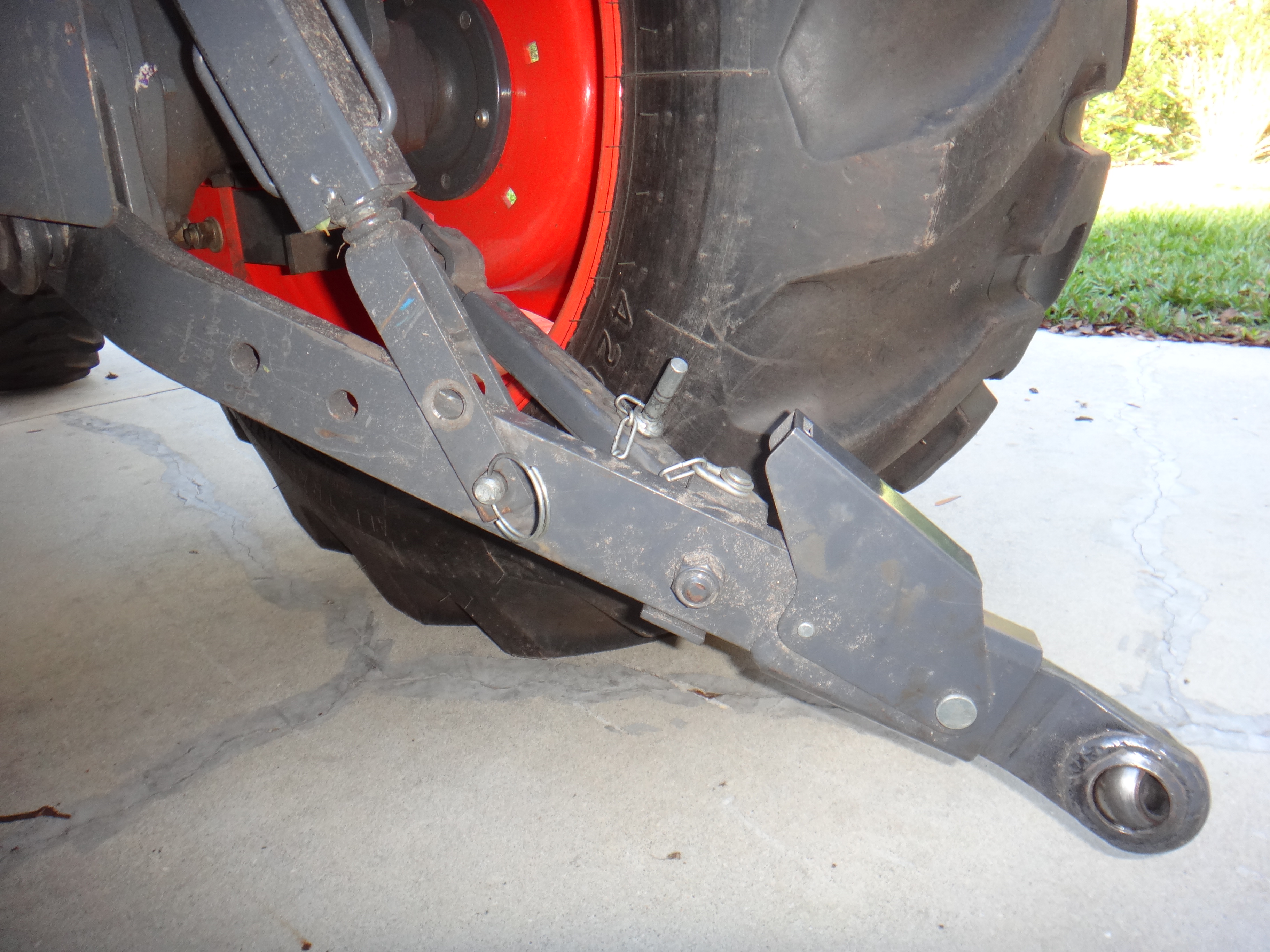

Kubota L3560 photos:
#1 Standard position for Lower Link, stirrup pin in UPPER adjustment hole. Note Lower Link angle.
#2 Optional position for Lower Link, stirrup pin in LOWER adjustment hole. Note Lower Link drop.

Not it does not. The cutting edge of the Box Blade will be 3" to 4" lower, that is why there are two stirrup holes.
It is easier to try it than to type about it. Give it a go.
