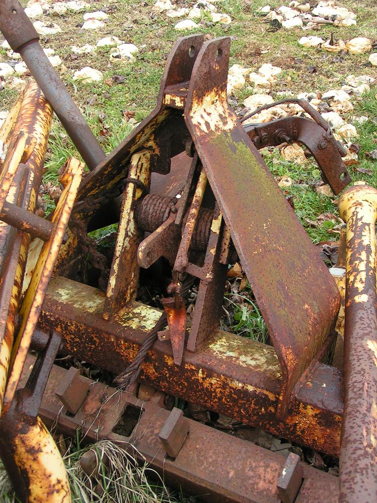

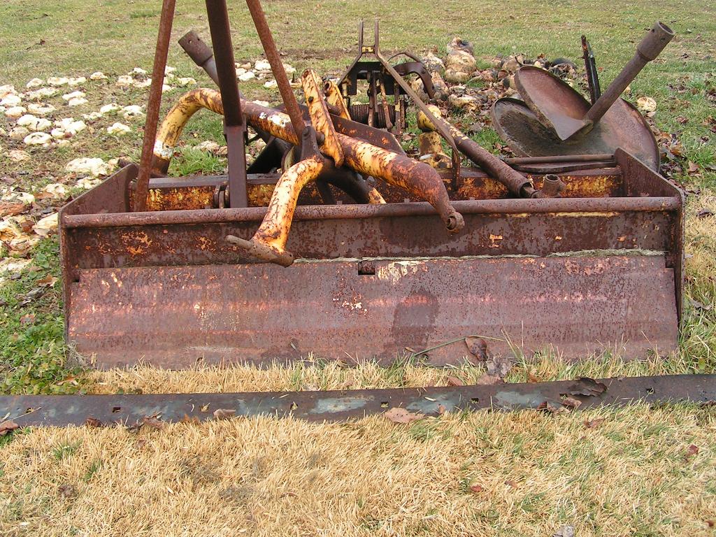

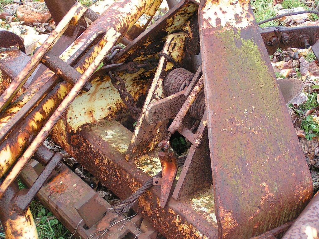

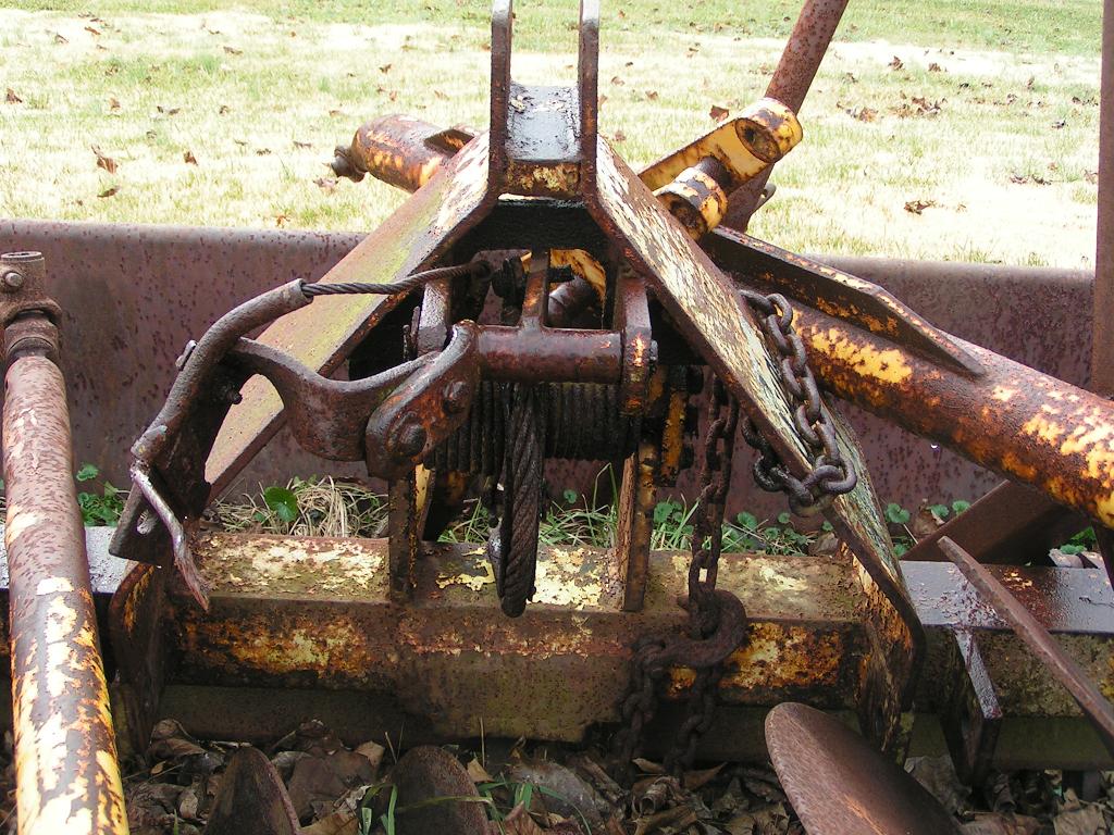

OK. I stopped and looked at closely again. I hadn't looked at it since summer. So, was going from memory. It turns out it has all its scarifiers and most of the parts for the bar lift (I think). It turns out that it is a GILL and is very very heavy. It's missing the rear blade. But, the guy will throw in the blade in the photo for another $10. I'll have to cut it to length and drill new holes in the hinge plate because the hole pattern is different.
Photos attached. What do you think? Anyone have one like this that could share a picture of how the lift mechanism is supposed to work? It looks like it was mechanical spring assist with some wire cable mechanisms. Do you think I could buy replacement parts for it? Not sure the springs are any good. Just ignore the boom pole and post hole digger laying on it in the photos.

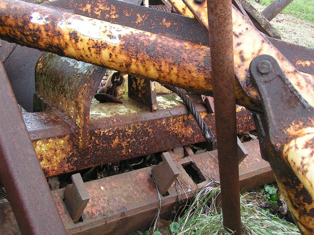

Here's some more photos.
