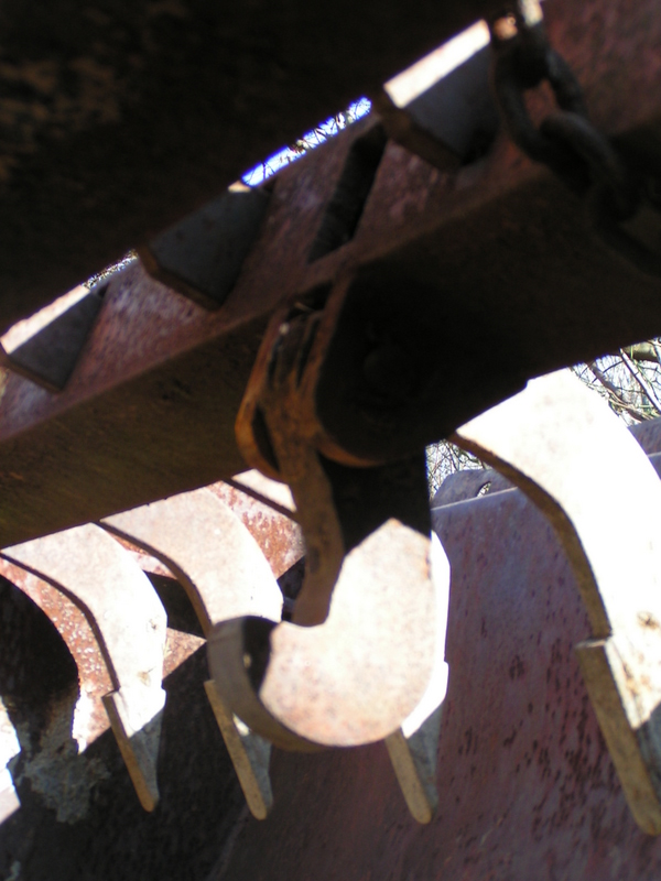

Got your photos. Thanks a bunch. I see there are torsion springs in yours too, not just posts. And your top link brackets are much different. How do you disengage the locks? With your foot?

The bottom of the swinging scar bar has a hook that latches onto a lug on the bottom of the main cross bar. The lever un-latches it and the torsion springs allow it to float back up - effortlessly. There are a couple pictures of that in the bundle I sent. Probably many are hard to figure out with out the box next to them! If you don't want to use springs, you could put a cylinder or even just a chain. Would be a 50-75 pound load to pick up but it would work.

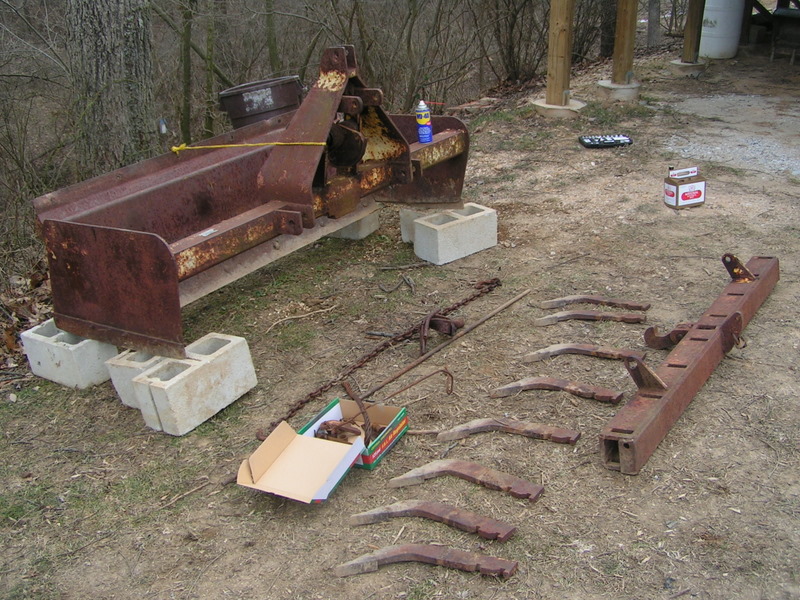

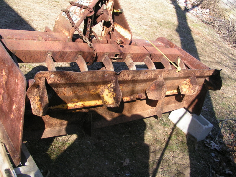

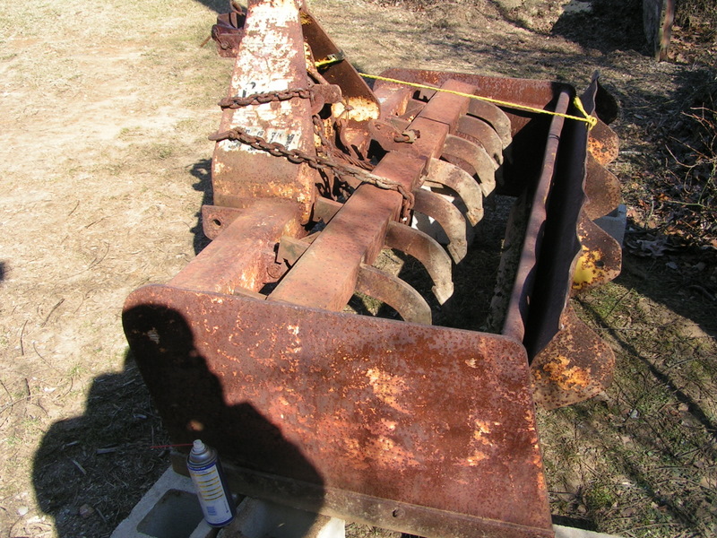

Here are some photos of it.
One shows the hinged rear plate tied up.
The last one is after I took off most of the parts. The scarifier bar came apart pretty easily. Removed the teeth retaining bar and all the teeth. Then pulled the pins that hold the scarifier square tube. It is very heavy, even without the teeth. I'd guess around 140 lbs. I had to be careful not to let it drop on me while I was disassembling. That thing could hurt ya!
Got the cables and the mangled lever handle off too. All that is left to remove is the cam wheel assembly, springs, and the blade. Basically what ever is bolted on. All the bolts are a mess and I expect to have trouble getting them out. I sprayed with WD-40 and will let them soak for a day or so. Then I'll apply heat and give it a try.
I think the locking hook had a wire directly welded to it that ran up onto the lever handle somehow. Seems to be be hinged such that it free falls open. So cable had to hold it closed some how. Not sure yet if I'll use this again. Might just go with a chain to hold in down and still plan to use a winch to raise it. No way am I gonna try to raise that beast without some kind of mechanical helper. The fully assembled bar has to weigh close to 200 lbs.
