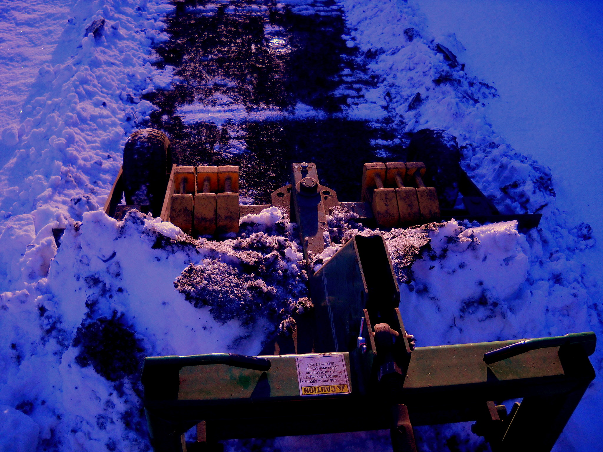

I have both and It really depends on what your terrain is like. Is there pot holes or deep ruts in the road? Is the road hard packed or softer ground? Is it gravel or dirt? For general filling in pot holes, ruts, and leveling hard packed dirt roads, I would look no further than a box blade, 6' for your new Bota. But when it comes to snow removal, i favor the rear blade. With a rear blade you can angle it, some can offset and tilt which is great for digging ditches and does an excellent job on putting the perfect grade on your roads. Here is my rear blade grading our driveway.
Using my blade on the driveway - Tractor Videos - Kubota, John Deere, New Holland and More Mine doesn't have the fancy tilt or offset, although i plan to add it later. :D anyways you can see how my rear blade works, I added some weights to it to improve digging effort and custom gauge wheels to get both the perfect grade on roads and for improved snow removal. One thing that a rear blade lacks is the ability to cultivate hard packed ground and it cannot hold material like a box blade, it will just pile it up either on both sides or to the side it is angled to which is good if you need extra gravel to move with a FEL but it requires the time to be smoothed out.

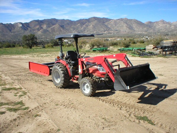

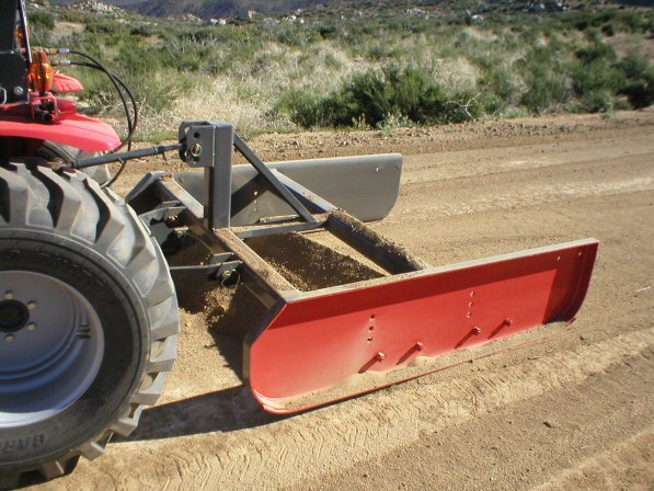

For 2 miles of road, you definitely need a land-plane grader blade. These are the single best implement to maintain a road. It's nice to have a box blade and a rear blade and you may find yourself wanting one or both later on, but hands down a LPGB is the best implement to maintain a road with.
Land Pride Grading Scrapers
GradeMaster Grader Blades

Have you ever used a land plane grader? I have all three and in my own experience, it is superior to the box blade and rear blade for road use. Now granted, the BB is a more versatile tool, but for road grading, I find my Land Pride Grading Scraper better, and for two entire miles of road, there's just no way I'd settle for anything less than the best implement.

Box blade, yes. Rear blade, probably not going to give you a lot of weight. When you said you wanted a blade for snow removal I assumed you meant for light snowfalls or cleaning up after snow blowing. If you're thinking of it more for ballast then that's a whole different subject. The grading scraper will give you as much weight as the BB but is a lot longer so if you are working in tight areas it'll really hinder you.
