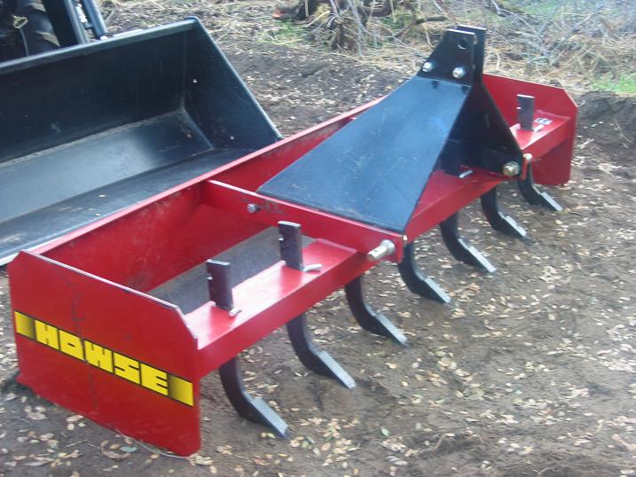

Just wanted to share some information with you. I'm sure the Woods is one of the best built brands out there. My tractor is 55hp 4wd and easily pulls this 7' Howse boxblade with all the rippers down. It is very heavy duty and strong and was quite a decent price for the attachment. Here is a picture of it new. I paid $575 on eBay and it weighs 580lbs.
As Jim said about his boxblade, this one will stop the 55hp in it's tracks also when it hits really big rocks or big oak roots without any deformation ar damage to the blade.
I'll post another to follow.

You can see from the construction that everything is heavy duty as has been said in the forem about the Howse. Even the scarifiers are heavy duty with hardened tips. And as I told you the blade itself has no deformation or damage.

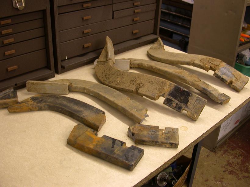

However, I have a concern about the scarifiers.
When hitting an obstacle that did not stop the tractor in it's tracks, the scarifiers gave way. I did more road grading after a heavy rain and the ground softened up. The scarifiers were able to dig in better than bouncing over a hard dirt road. The 55hp tractor has suprisingly excellent traction even in muddy conditions.
I ended up pulling out several large rocks that I couldn't budge before but snapped off two scarifiers and bent 4 others in the process. This did not happen on any one particular rock but rather over the course of my 1/2 mile road. I'm wondering if these scarifiers are heat treated or if there are better stronger ones that fit the Howse?
See picture.
