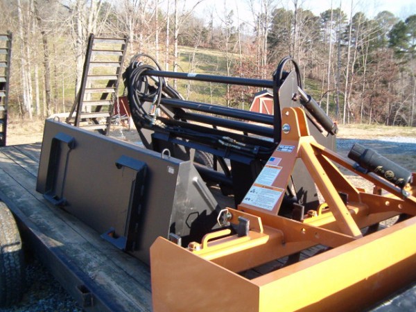

I have the 6ft. woods. It costed 675.00 new in 04. Could have gotten a Howse for 375.00 but comparing the difference I figured I would be wise to take the heavier, better made one at 675.00. I also liked the cutting edge Woods puts on the blade. Its not just part of the metal boxing, looks like it can be replaced fairly easy.

Century3045, if that's a recent photograph, I don't know how you keep your bb looking so good.
I got a Buhler in October and it's already looking pretty beat up. Couple days ago it had it's first repair. The bars between the back of the blade and the top link bent like bananas when the scarifiers met an immovable object and the rotational forces put the flat bars in more compression than they could handle. I managed to straighten them out by backing the bottom of the blade onto a tree stump then made a fix wtih some threaded rod.
